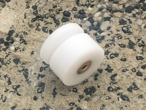

That said, back to the business of motors and pulleys - attached here is one of the failed attempts at a pulley (*). It is made of Delrin with a bronze hub, and, even though we have tried numerous times, cannot machine a satisfactory ID of 4mm with the bronze hub - using both (1) multiple precision reamers and (2) grinding rods.
(*) The photo is crap, but it was the best I could do with limited camera options, and the pulley being white.
Thought the issue might be with the motor shaft, but both motors, measured with a precision Mitutoyo micrometer, are well within the spec published by AA.
As a last ditch effort, we machined a pulley from Delrin without the bronze hub, same procedure as tools as earlier, and achieved an interference fit. Further testing at a range of 200 - 2800 rpm revealed a runout of ~0.005mm.
This pulley is a bit different that the ones presented here due to the design of my turntable and experimentation with a minuscule flywheel effect. The diameter of the belt area (working pulley diameter) is 16mm, for a 1:20 drive with my 320mm platter.
After all this, I can understand how machine shops have difficulties providing satisfactory results over a larger run of pulleys without dry fitting against each motor. The SDP-SI pulleys might be a very good option for both BLWR and BLWS motors - but I have been unwilling to pay the shipping premium to test that hypothesis.

...After all this, I can understand how machine shops have difficulties providing satisfactory results over a larger run of pulleys without dry fitting against each motor. The SDP-SI pulleys might be a very good option for both BLWR and BLWS motors - but I have been unwilling to pay the shipping premium to test that hypothesis.
I'm not sure why one would need a brass insert in this application. The torque needed to start and drive a turntable platter isn't high enough to necessitate a grub-screw fixing. I found, personally, that with both tight-grained wood like maple, or Delrin/Acetal an interference fit is more than adequate (one needs only to drill a hole the exact size of the shaft, and the fit is perfect.) And machining for an interference fit is much easier; allowing me to get a passable pulley with only a drill press, table saw, and the motor itself as a lathe to do the final shaping and polishing.
That said, the SDP-SI pulleys with brass or aluminum inserts are quite nice and run true (I ordered a couple). But, unfortunately, their flat-belt pulleys don't have upper or lower belt guides, so the belt just falls right off. If using a round O-ring style belt, their pulleys are great--and a bargain.
I have really been enjoying my set-up with the BLWS motor, and homemade pulley. Pyramid's controller is a real treat!
Option #2 will work. C21 is a reservoir cap; there are 0.1uFd caps on each supply pin of the amplifier chips for stability. You can mount the cap on the back side of the board (observing the proper polarity arrangement) and bend the leads at right angles to mount the part flat.
Much appreciated!
Based on the SDP-SI pulleys, I thought it would be a good idea. 🙂 It might have been one, of course - but we haven't yet managed to make it work.
And as you stated - for this application is probably not needed.
