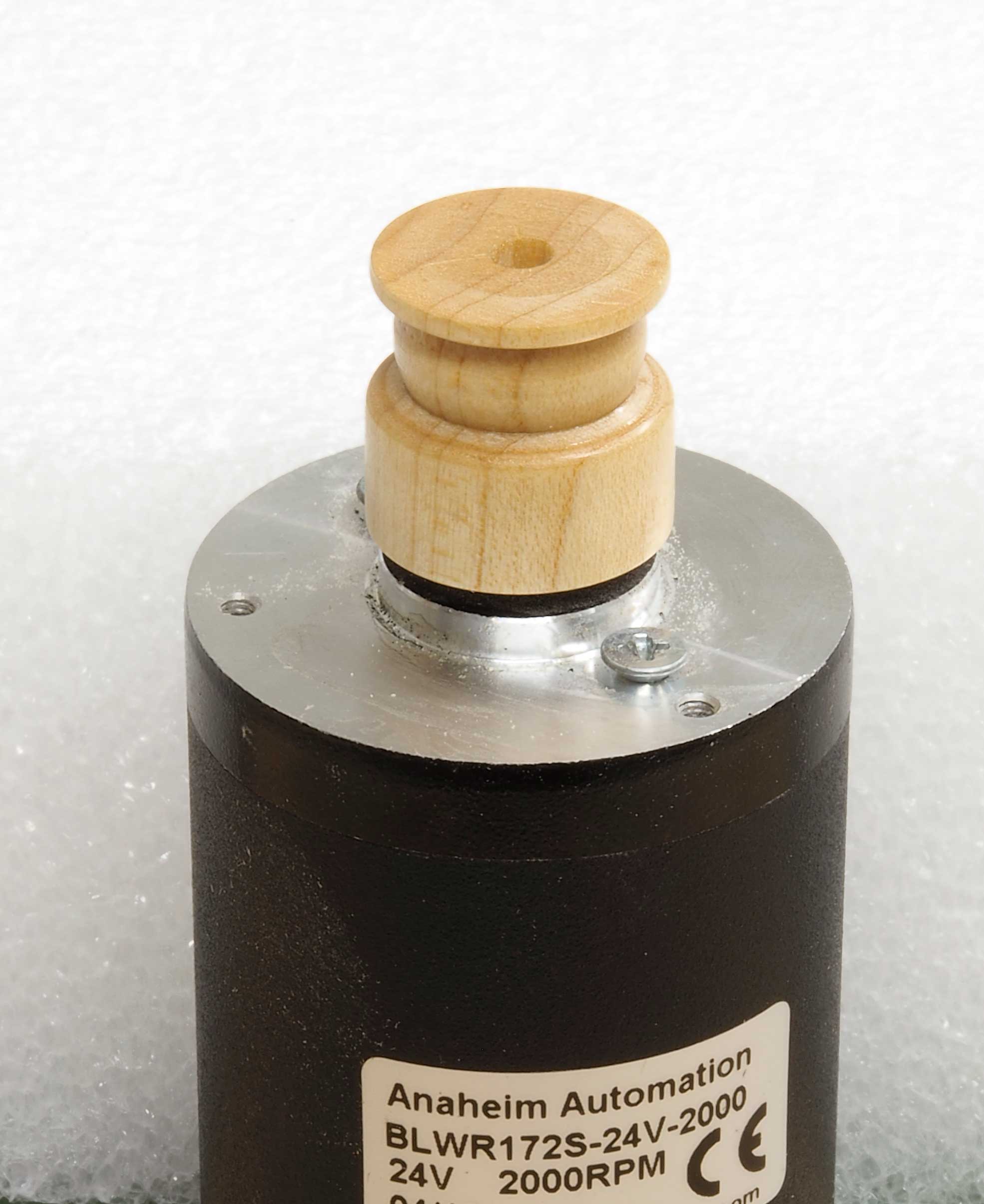

Here is a picture of a pulley I made recently from a section of maple dowel (for 600rpm operation using a flat belt) using the motor itself as a lathe.
It is not perfect, but better (truer) than what my local machinist could make. It is certainly good enough to get one going on the project, and make some tests or initial listening.
I'm just putting this up here for encouragement.

I have "pully Envey"
Nice pully sir,
Just Goes to show that a pulley based on Pyramids design would be a real boon to lots of users in my poinion😉- (not that i can say much as i dont have the abilitys to contribute)- but apart from the purchase of a VPI HRX pulley i dont see an alternative (local machinest in my area dont speak english and are mechanicaly a bit "rough")
what to do ?
Johnny

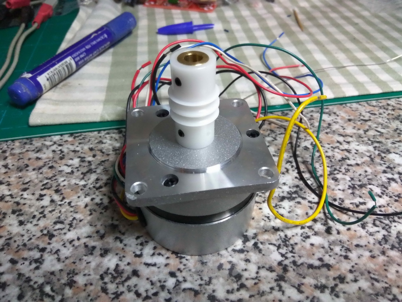

Here is my idea on how to use two belts with the sdp-si pulleys.
You can put one on top of another on the motor, glue them together and then cut the excess on top and adjust the final height.
I repeat that if you want to use only one belt the sdp-si pulleys are an exact fit to the motor and they ship anywhere.

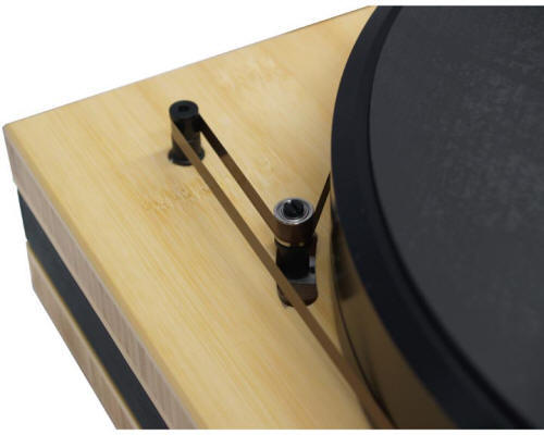

I was concerned that by lowering the pulley diameter to about half (0.375") for 600 RPM, the surface contact area with the belt will also be much less, and this may cause belt slip. Is this something to consider?
It depends on the thickness and stiffness of the belt. A thin flat belt would be less of a problem than a thick round one. Also, is there a way to adjust tension? If slippage is a problem or concern, maybe 300 RPM would be better in your case.
I always liked the solution used in the Artemis SA1 turntable. They used a flat belt and a tensioner to keep constant force on the belt. The attached picture is taken from an article about the SA1 in Positive Feedback magazine. artemis labs sa1
Anyone have good leads on where to buy hardware to make a diy tensioner?
