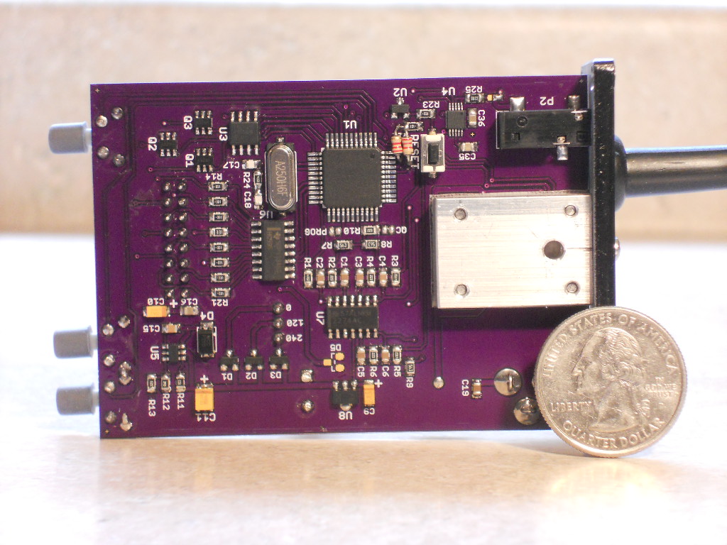

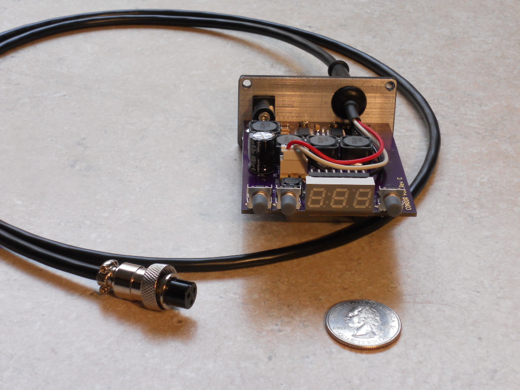

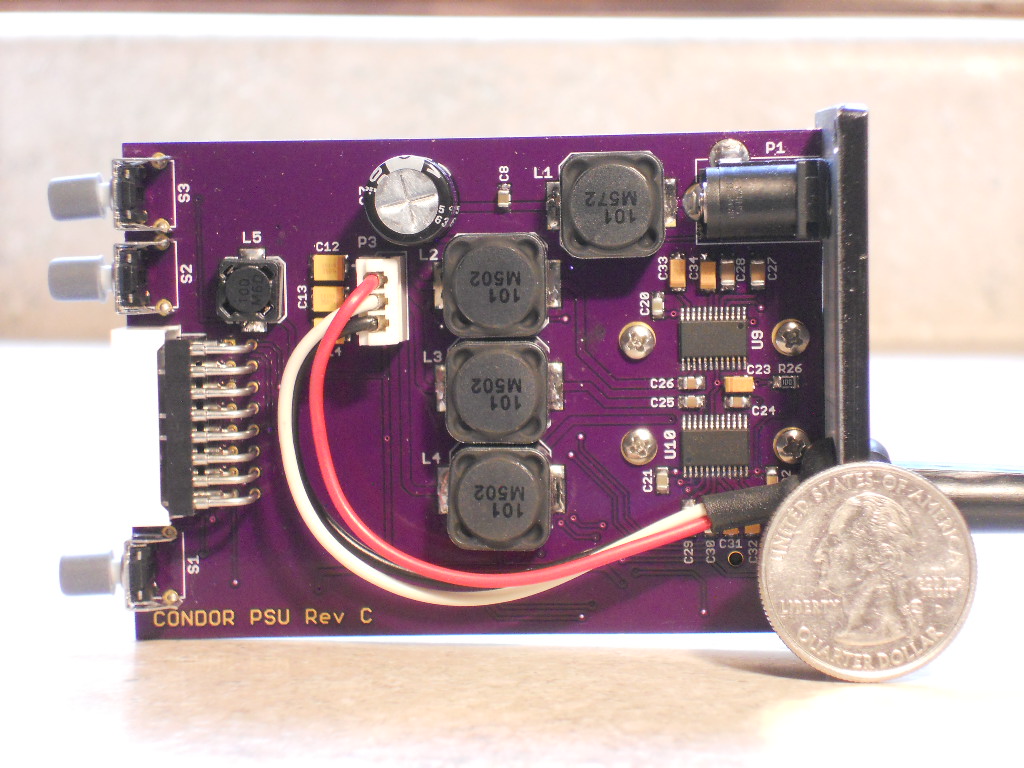

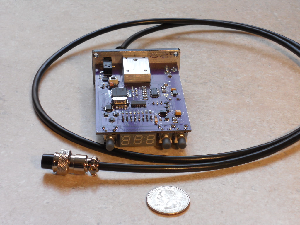

This is the latest interation of the 3 phase BLDC motor controller. I was able to apply a few things I learned doing the SG4 to this design, and eliminate some (expensive) hardware and freed up some real estate in the process. I was able to combine the 25W amp with the 3 phase controller onto one small PCB that fits in the Eagle controller extrusion. The whole power supply is about the size of a pack of cigarettes, but drives a 12W motor with 2-3x the torque of a Hurst 300 RPM motor. The motor is much quieter than an AC synch motor as there is zero cogging and the bearings are much more precise. The controller can drive the motor from 1Hz (30 RPM motor, 1.667 RPM platter) to 64Hz (1920 RPM motor, 106.667 RPM platter), so I can do 33/45/78 RPM with one pulley, loads of torque and no burn out on the belt at all.😀
The circuit is essentially the same as the previous version, except that I am developing all 3 phases in the uP. It still has the same frequency resolution as the previous version and still accepts feedback from the RoadRunner tach so it holds the platter speed to within ±0.005 RPM. I was also able to get the BOM cost below $75.
I need to recalibrate the frequency/voltage/phase function which should only take an afternoon to do. After that, I plan on measuring the torque at various speeds and compare the results against the Hurst motors. I built a jig that will hold either motor and read the torque out directly in oz-in.

@jrubins-
This controller (or SG4) would most likely not work with the motor you linked to. It is much higher RPM and most if not all of the operating parameters are different. This controller is matched closely to the motor I am using and is not a "universal controller" like the Eagle or Falcon which is for AC synch motors.

I'm using a pair of TI TPA3123 amps which are SE output class D, so no output xfmrs.
I don't think this is suitable for a DIY project. As you can probably tell from the pics, it uses some very fine pitch (0.012" lead spacing) components and requires a hot air rework station (or IR oven) to solder them (the amps have a ground/heatsink slug on the bottom of the package that is soldered to the PCB).
I've already been down the dealer/retail path and have no inclination to go that route again. It is probably more suited to an OEM application, but unfortunately, all of the mfrs I've talked to don't go outside of what they can build in-house or this would be over their heads technically. It's too bad; there is definitely a better alternative to AC synch motors and cheesy controllers that fill up a 19" rack and cost thousands of dollars. But then again, the turntable industry doesn't seem to run on common sense or quantifiable results does it?

Yes, the stock motor comes with hall sensors. I removed the wire harness and sensor PCB so only the 3 winding connections remain.

SMT production is large scale by nature. It would be difficult to find a CM that would do less than 250-500 pcs. I have no interest in pursuing that route at this point.
Anaheim also sell several BLDC controller boards, some of which can be governed by a direct 0-5VDC input. I assume your solution is superior, but can you shed a few details as to why using said BLDC controllers would be a lesser option than your approach?
All of their controllers use trapezoidal commutation rather than sine wave drive so the speed is controlled by the DC level rather than frequency. The motor will also cog in this mode. They do use the hall sensors to trigger the commutation which can provide crude speed indication, but with resolution of several (if not tens of) RPM vs better than 0.001 RPM resolution with a DDS based sinewave controller. Precision controllers exist but they require a high resolution optical encoder on the motor shaft, but I doubt the speed accuracy is better than ±0.1 RPM.
