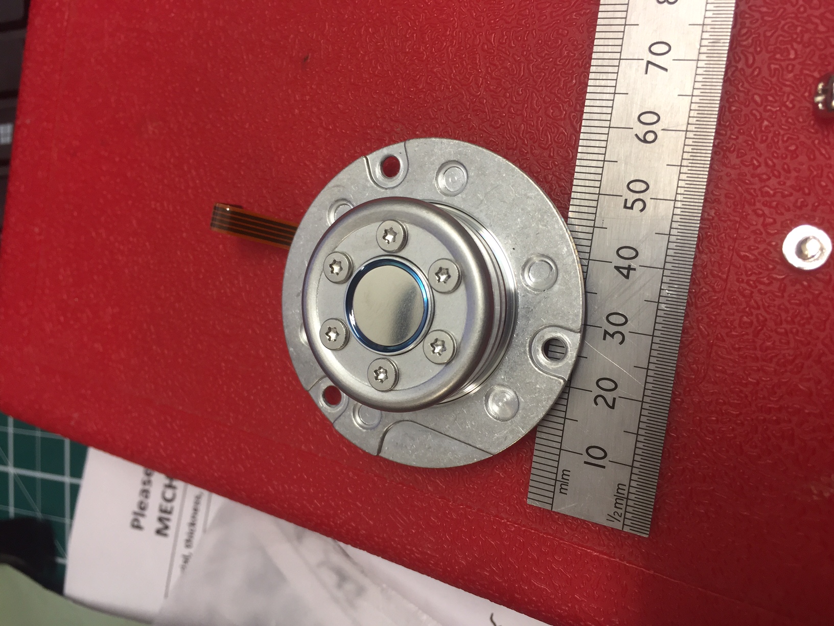

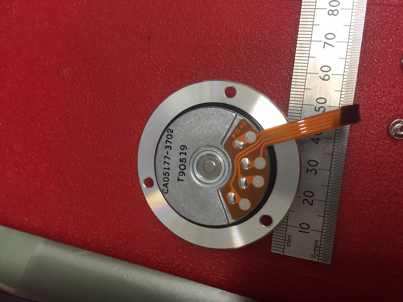

BLDC from HDD
I've just extracted a BLDC motor from an old hard drive - pics attached
it's a beautiful little motor and really easy to attach a pulley as there's big flange all round and 6 screws to tighten and centre a pulley onto it.
There's 4 connections, could be soldered onto directly.
I don't know if it would have enough torque to turn a platter, but I'd love to get it running.

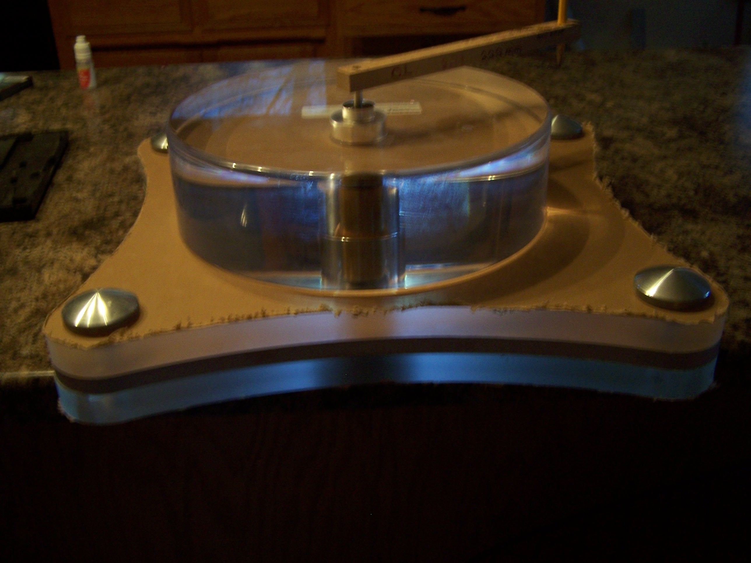

Not trying to derail the thread or anything but I thought I would share the deck I am building with the hopes of marrying to a really good motor/drive system.
The plinth is 1 inch acrylic top and bottom with 1/2 inch of aluminum in the center.
Still have some work in designing and making the tonearm mount and the motor housing.
All fun stuff.
All fun stuff.
