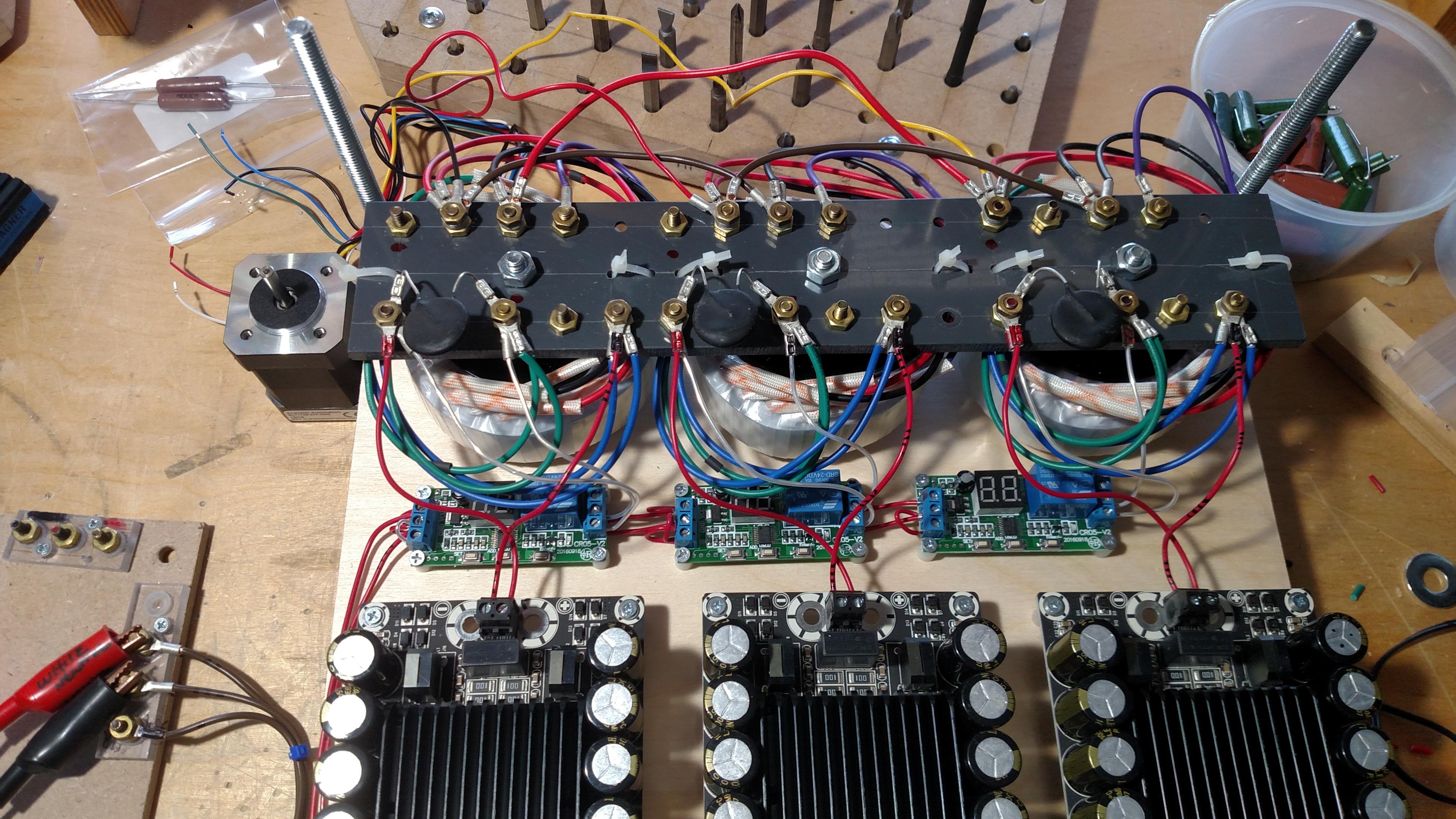

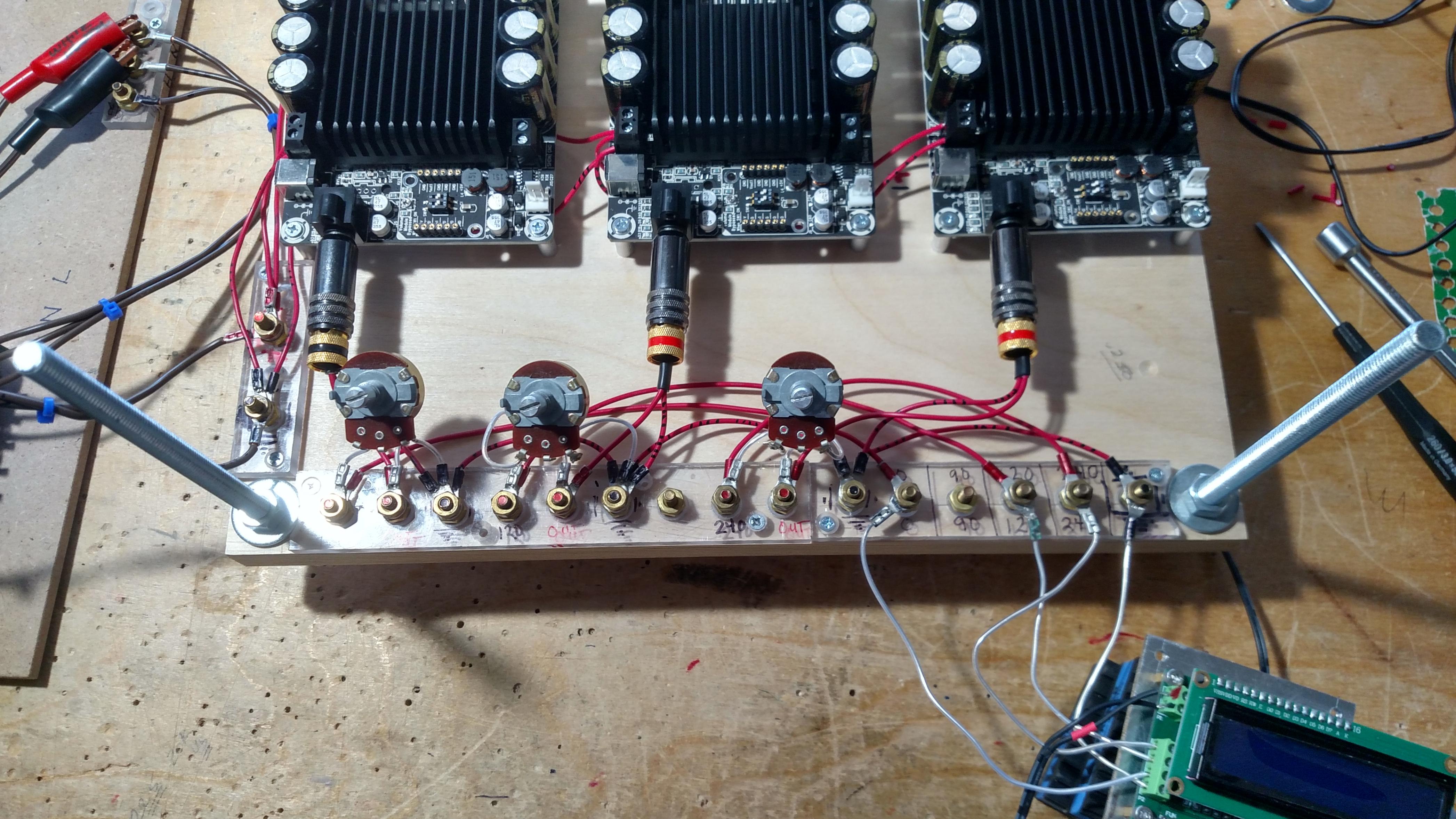

Got around to building a new controller for a brushless DC motor. I thought
I would go with the 41 watt larger one. I also went with a 40 to 115 step up trans to let the amps see a 4-5 ohm load.
Everything is running smoothly but I can not get a correct reading on voltage on the motor side. With 8 to 9 volts out of the amp I should be getting around 24 at the motor. Instead I am showing 5 to 6 depending if I use delta or wye feeding it. The motor starts right up and runs smooth and quiet. The amps are running cool.
Was talking to a buddy and he thought maybe back emf from the motor is causing the fluke 87 to give bogus readings at the motor. The reading on the 3 phase papst motors check out. Is there something about the bldc motor that is fooling the meter. It seems like everything is alright but would like to know what voltage the motor is actually seeing.

If you are running a 24V BLDC motor, you most likely don't need a step up xfmr between the amps and motor. If you are using the xfmr to step up the voltages, it will reduce the impedance seen by the amps. If you are using it as a step down, it will increase the impedance but lower the voltage. You will not need 24VAC to run the motor. At full speed you will need ~24VPP or 8.5VRMS on each winding.
Which amps are you using? Are they single ended or BTL?

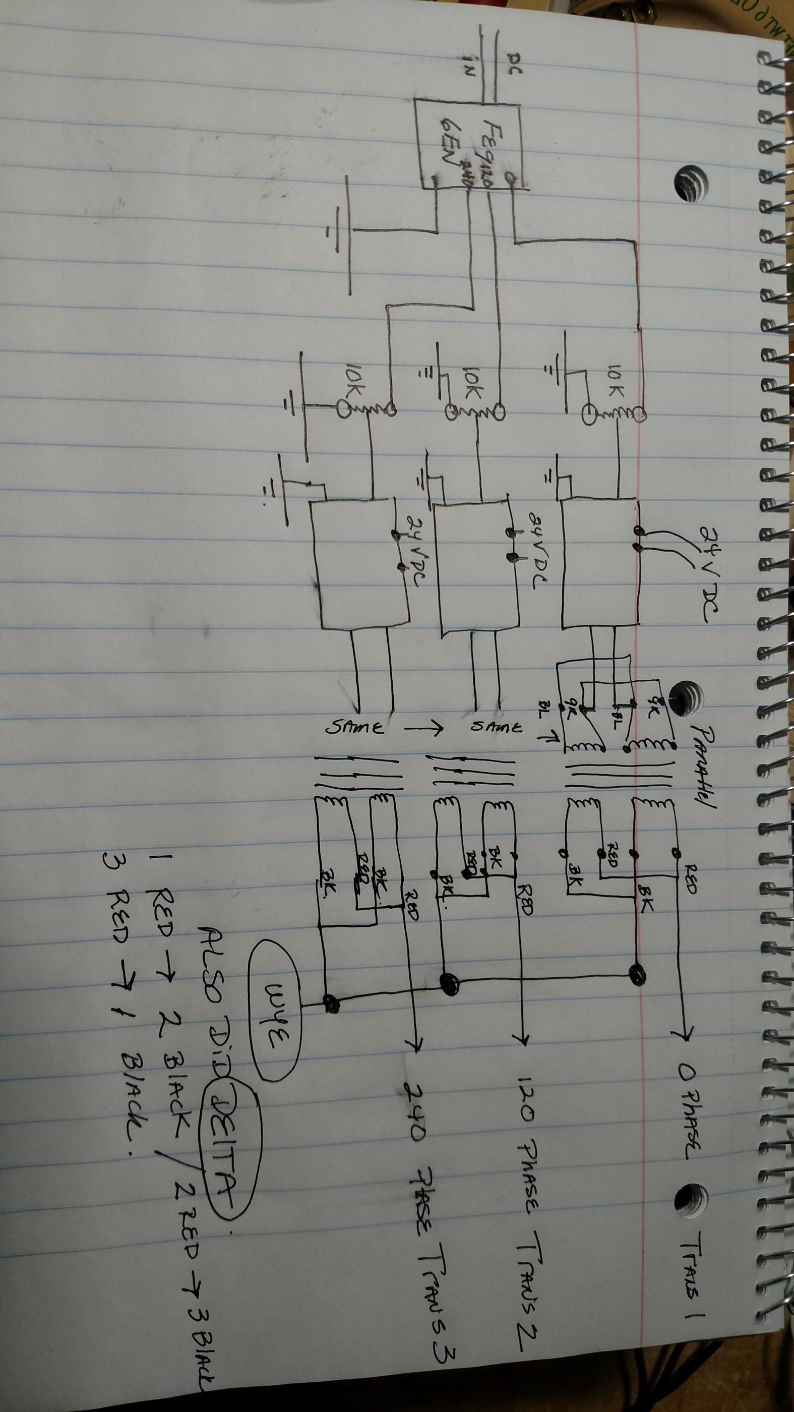

Do you have a wiring diagram showing SG4, amps, xfmr and motor?
Hi Bill
Do not have schematic software so a did a quick drawing. The frequency gen was the Chinese one I was using on the test bench. The sg4's are in my playing system.
These are the parts. Anaheim automation bly172s-24-2000. Sure aa-ab31282 btl 200 watt 15-36 DC input stable to 2 ohms. Antek as-0540 /40 to 115v in step up.
I do have 5 ohm thermistors and by pass relays in circuit. I already had them so I thru them in. Not shown on schematic. The reason I used a 2.875 step up transformer was to get the load of the motor to the 4-8 ohm mark so the amps would be happy. So if I did this correctly. 24 volts squared 576. 41 watts ÷ 3=13.66. 576÷13.66= 42.17. Step up 2.875 squared = 8.27.
So 42.17÷8.27=5.10 ohms the amps sees. If you see a problem with the numbers and conclusion please let me know.
The numbers , when I checked the voltages all seemed OK until I got to the output side of the transformer feeding one phase of the motor. With .280 RMS feeding the amps the output was 8.77 rms. With 8.77 rms feeding the 2.875 step up transformer the meter was only getting 5.9.rms .
I am feeding the green/blue wires in parallel and taking the output from the red/black wires in parallel. So green to positive and blue to negative of amp. Red output to phase wire of motor and black either connected together or delta where red of one to black two etc.
The motor has its black wire to red output of trans 1. Red motor wire to red trans 2 and yellow motor wire to red trans 3. Seems to be running fine in the right direction. So I am confused why I can not get a correct voltage reading at the motor.

You are making it much more difficult than it needs to be. For one thing, you are crossing back and forth between DC commutation methods and sinewave drive.
You cannot compute the power the way you did by simple math. If driven by commutating DC, one coil will be driven positive, one will be driven negative and one will be off. They will all be out of phase with each other and constantly changing as the hall sensors inform the controller when to switch. If you drive the windings to 24VDC level, the motor will be at spinning at rated speed (2000 RPM or most likely, higher) and there is a lot of really complex math going on.
The data sheet tells you what the DC winding resistance is: 1.6 Ohms. This is what each amp (or xfmr primary) will see at zero (or very slow) speeds. You could try to compute the voltage needed for each winding (at very low speed) to produce 40W, but there are lots of variables and the math is not trivial. To further complicate matters, the impedance changes as the motor increases in speed. A much simpler way is to measure the power consumption and adjust the drive level until you have 40W at the desired speed. You can measure this at the power supply output and factor in the amp efficiency and transformer losses. At 800 RPM (IIRC to get 33 RPM platter), I would guess you would see 10-12VPP or 3.5-4.25VRMS. If you run the motor at 40W all the time, I would think it would get quite hot, the case temp topping out at 150°F or higher. You certainly will not need that much power once the platter is turning and I would suggest dropping the drive level down until power consumption drops by 25-33%.
You can (and should) get rid of the transformers, they are making everything more difficult. FYI, the turns ratio is probably closer to 2.3:1. Disconnect a xfmr from your circuit and measure the primary side input voltage (120VRMS) divided by the secondary output voltage with no load; this will be much closer to your turns ratio.
If you don't use xfmrs, you will not be able to use BTL amps to drive this. You can still use class D, but they should be single ended outputs. TI make some of these chips and there should be ready made amps available on e-Bay. I think the TPA-3123 is 50W/channel, runs from 24VDC and is SE output. If you can't get SE output amps, then use isolation transformers with a 1:1 turns ratio. I have no experience with delta configured outputs. I would wire the xfmr outputs as wye configuration; if nothing else, it eliminates any currents that can circulate within the delta loop.
If you use the SG4 to drive this, you should not need the thermistors as the voltage ramps up from zero to max, and you can program a reduced voltage after the platter is up to speed (5 secs).

If the amps are running hotter than the load, that's a pretty good indication that there's a mismatch. Even at class AB (50% eff), they should be pretty close to the same temp (assuming proper loading). Your amps are 90-95% efficient. On my BLDC set up, the motor will hit 140°F at 12-15W, but the amps never get above 100°F. My guess is your motor is loading down the primary outputs of the xfmrs, which is why the voltage is so much lower than expected.
Using 1:1 xfmrs, you might want to go with the larger version. 25VA would give you slightly less than 3dB of headroom. I think the load will be OK with the amps you have. The impedance will not drop below 1.6 Ohms and will always be higher as the speed increases. That is why the drive voltage must increase as the motor speed increases.
IIRC, these motors are around 35-45% efficient. If they consume 40W, then 22-26W will be lost as heat. I would expect case temps higher than 95°F.
