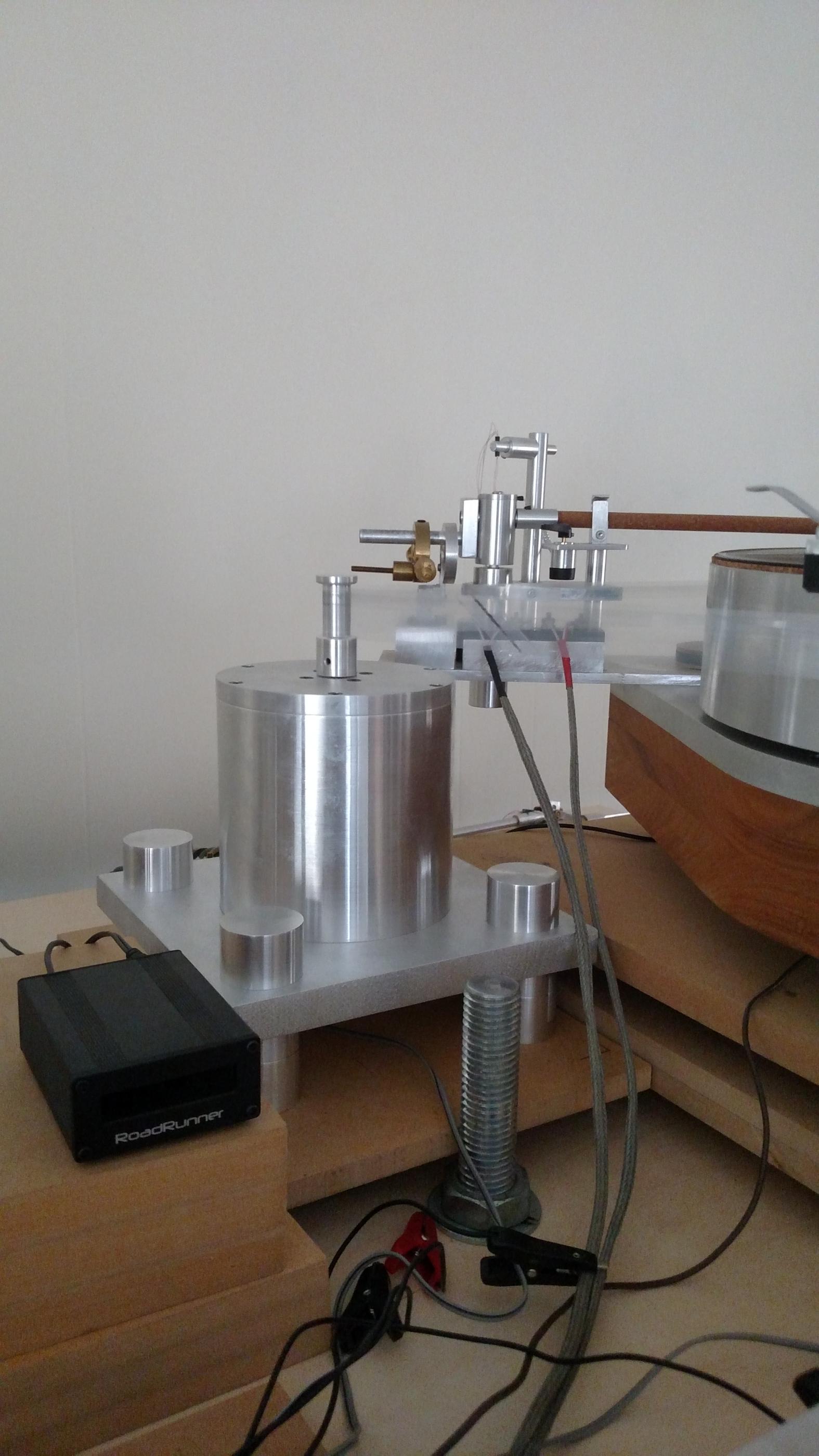

Here are two pulley's one on a large Bldc motor and the other on a papst. Both driven with Bills sg4 controllers. Notice the road runner rpm gauge. Glad I got one when it was available.
Enjoy the ride
Tom
Enjoy the ride
Tom

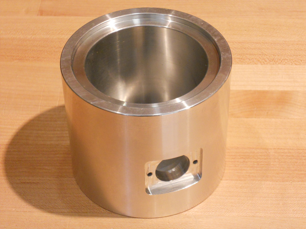

After a couple of weeks of working here and there I managed to finally work out the kinks in my motor housing. I had started it while waiting for the amp boards. It began life as a piece of 1/2" wall 4" diameter 6061 pipe I got at my local metal yards "Discount Barn" and some 5/16" plate scrap I had around.
I still have to finish up the pulley before I move on to the controller and amp. Figured I'd post a pic for fun. I'll probably post more of the fabrication process once I find time to start a thread about refurbishing/modifying my HW19.

There was several reasons why I used an XLR connection for this application. As Bill mentioned, it appeared to meet the expected voltage/current requirements, it had 3 conductors and I had them on hand.
I had a couple of 4 conductor mic connectors on hand similar to the one bill used, but the machining process to mount the XLR was easier.
In contrast to the mic connector having a single nut around its threaded diameter which would not easily seat on the the inner curved surface of the housing which would require extensively reducing the housing wall thickness and a shaped recess, the XLR receptacle has two screws holding it to the motor housing via its flat square mounting plate.
The XLR receptacle only required a few simple passes on my milling machine to create a symmetrical flat area on the outside of the curved housing. I was then able to bore a hole on center and drill/thread the two mounting holes.

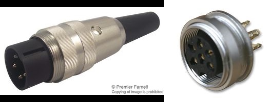

Would a multi-pin DIN specification connector (panel mount & corresponding plug)be suited for speed controller output to motor (e.g. 4 wire 2 phase connection to motor). Its rated at 250VAC. I'm thinking of this product for reasons that I can easily order and buy this product.
Product – Lumberg
Product – Lumberg

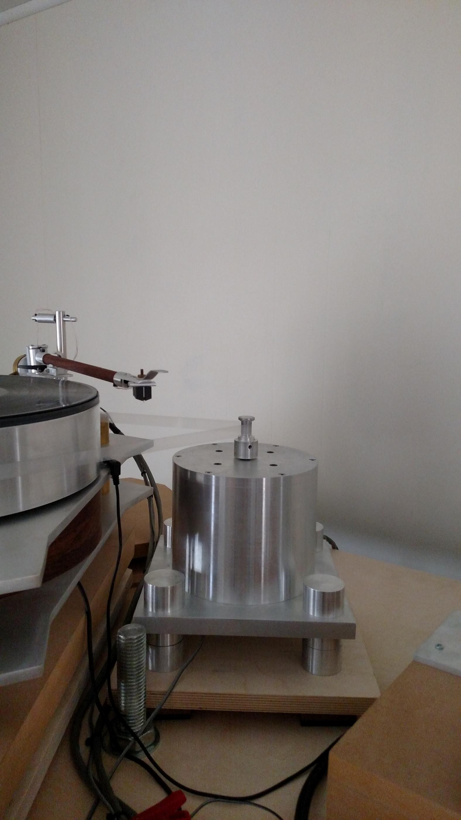

I have been happily using this motor and pyramids controller for a while now. I have a slight issue that doesn't seem to affect performance in any audible way but bothers me to no end. My motor is slightly noisy. If I spin the platter by hand with the belt attached and with the controller not turned on I get absolutely silent running. As soon as I turn the motor on I get some small noise that sounds like something is rubbing. I thought it might be the wave washer that held the shaft in place or the bearings but what is stumping me is that the sound only happens when voltage is applied. When simply spinning the whole thing by hand it is dead silent, any help would be appreciated.

Did you guys play with lower run voltage. The sg4 has that feature. I do not have the motors you guys are running but in all the motors I played with the noise was reduced with lower voltage.
That being said you might like the sound of the music better with the higher voltage. Easy enough to experiment and see what you like.
