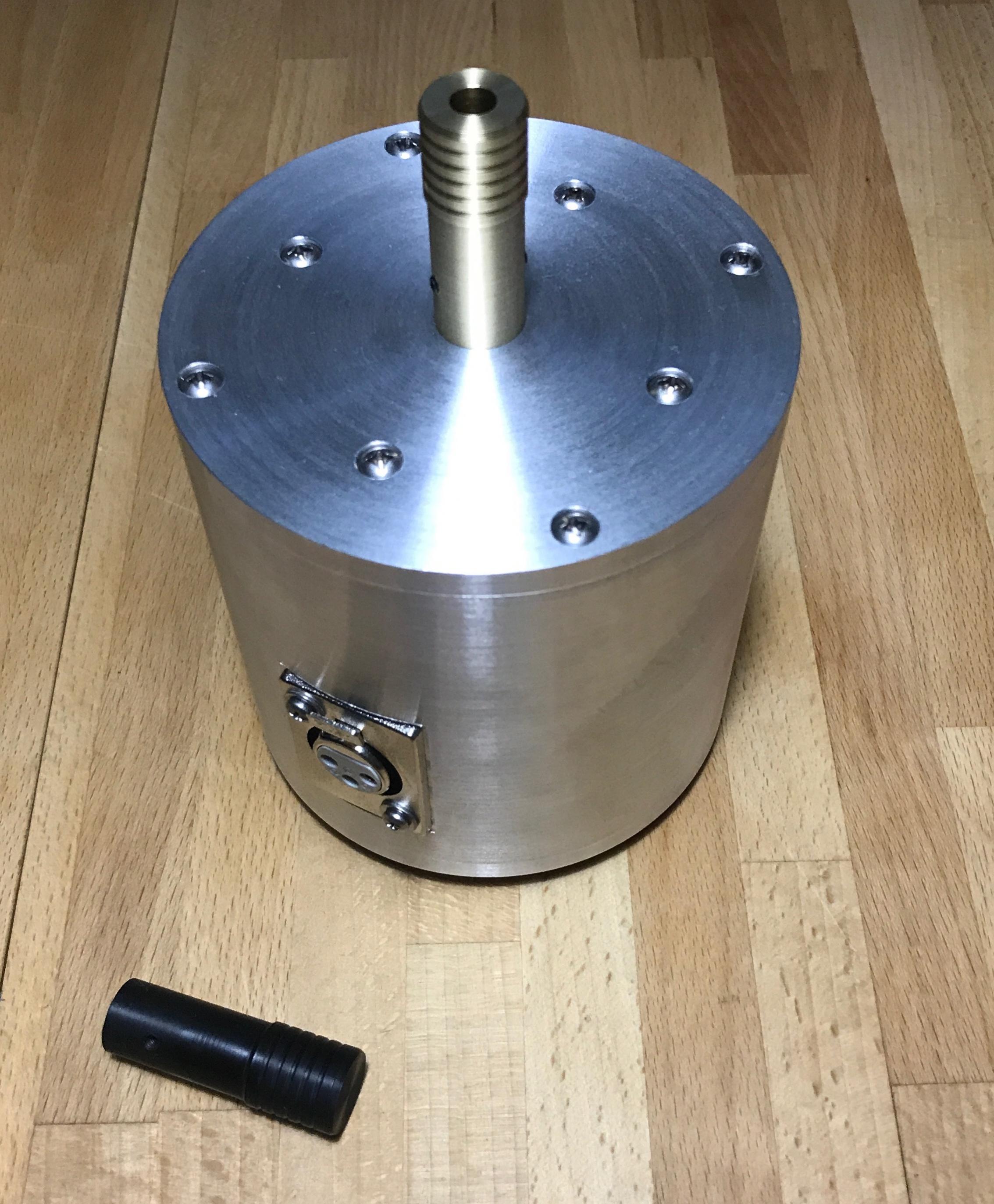

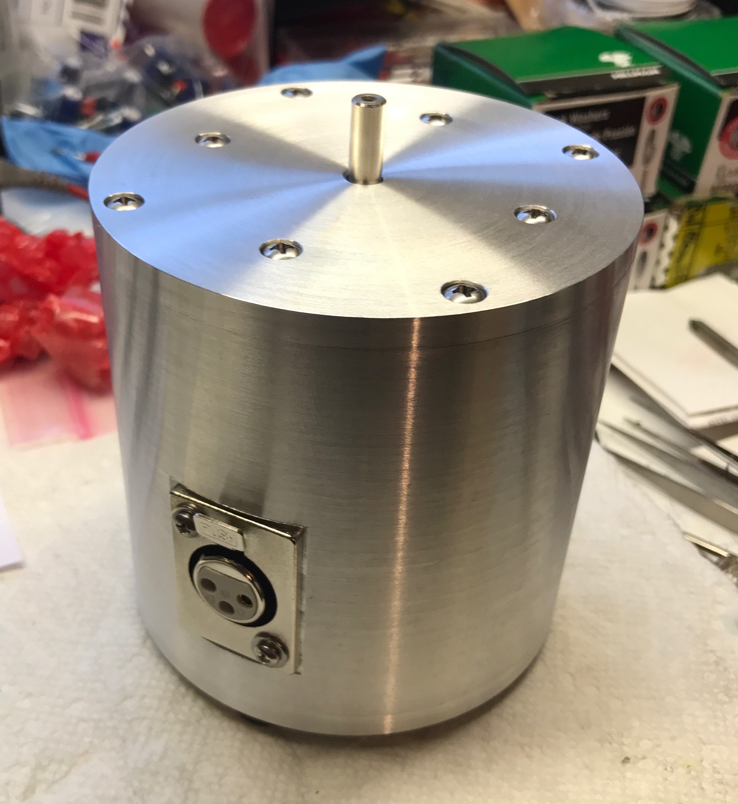

After a couple of weeks of working here and there I managed to finally work out the kinks in my motor housing. I had started it while waiting for the amp boards. It began life as a piece of 1/2" wall 4" diameter 6061 pipe I got at my local metal yards "Discount Barn" and some 5/16" plate scrap I had around.
I still have to finish up the pulley before I move on to the controller and amp. Figured I'd post a pic for fun. I'll probably post more of the fabrication process once I find time to start a thread about refurbishing/modifying my HW19.

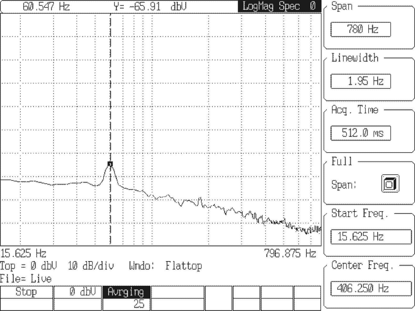

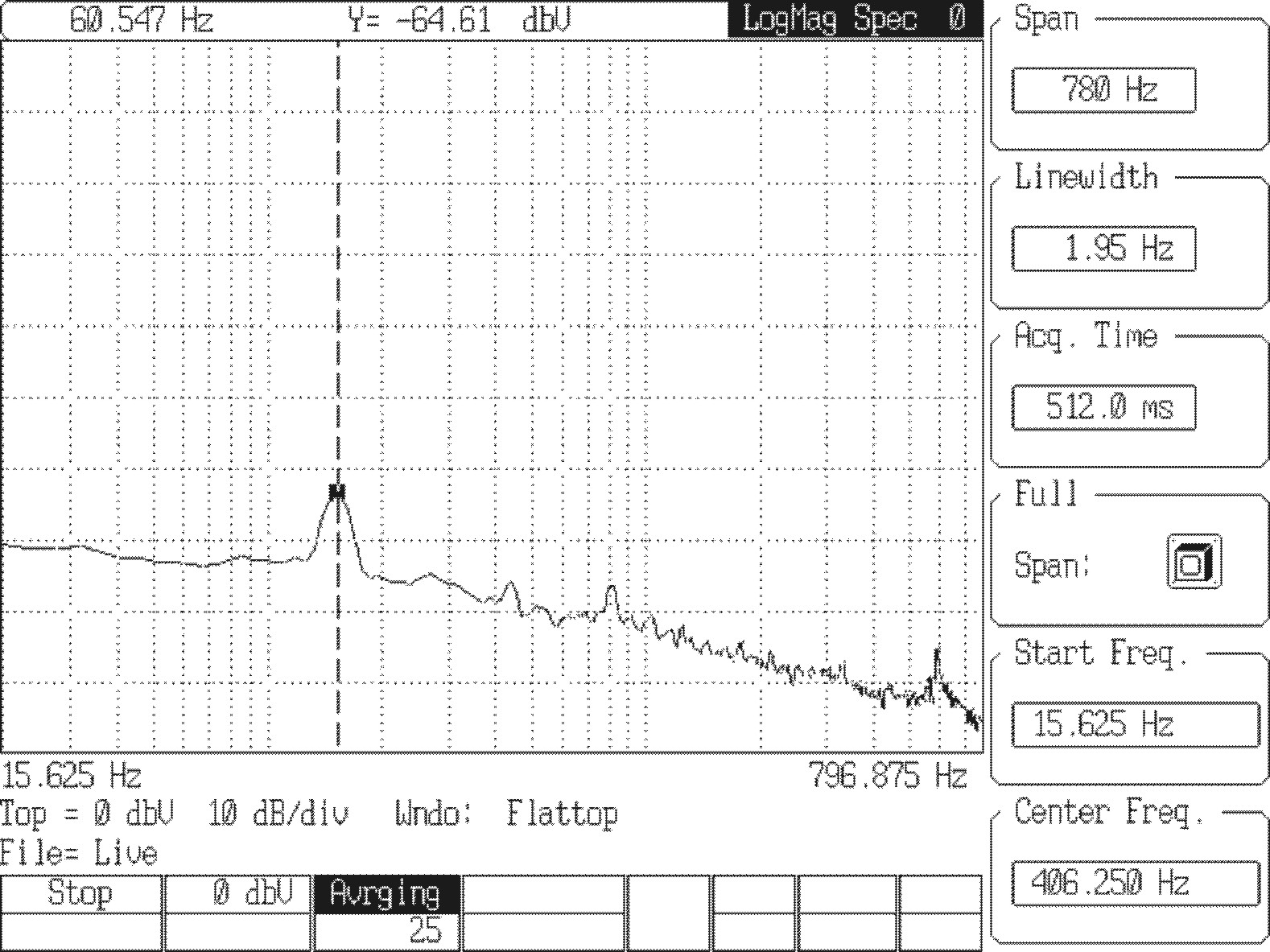

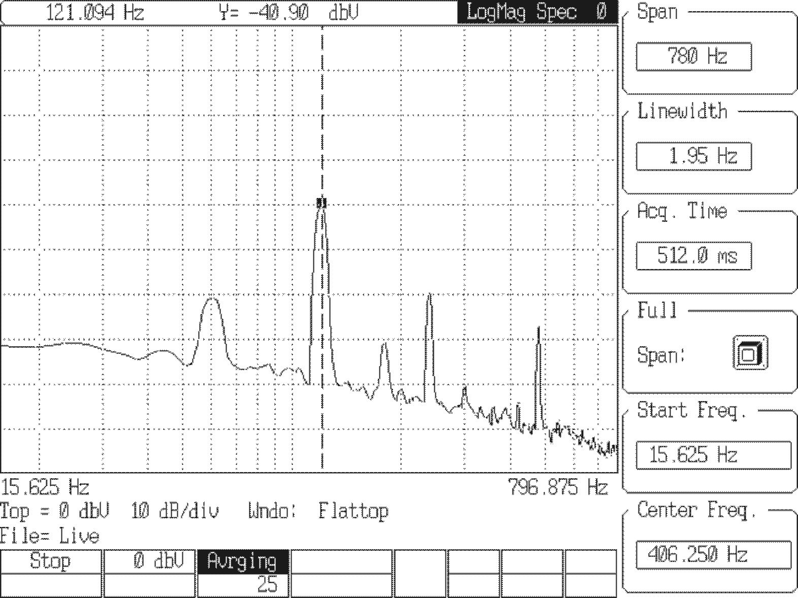

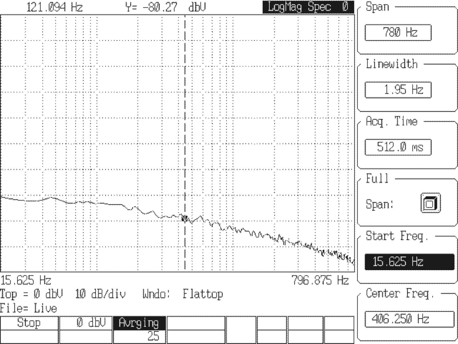

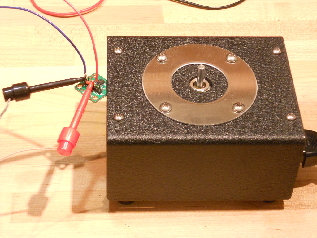

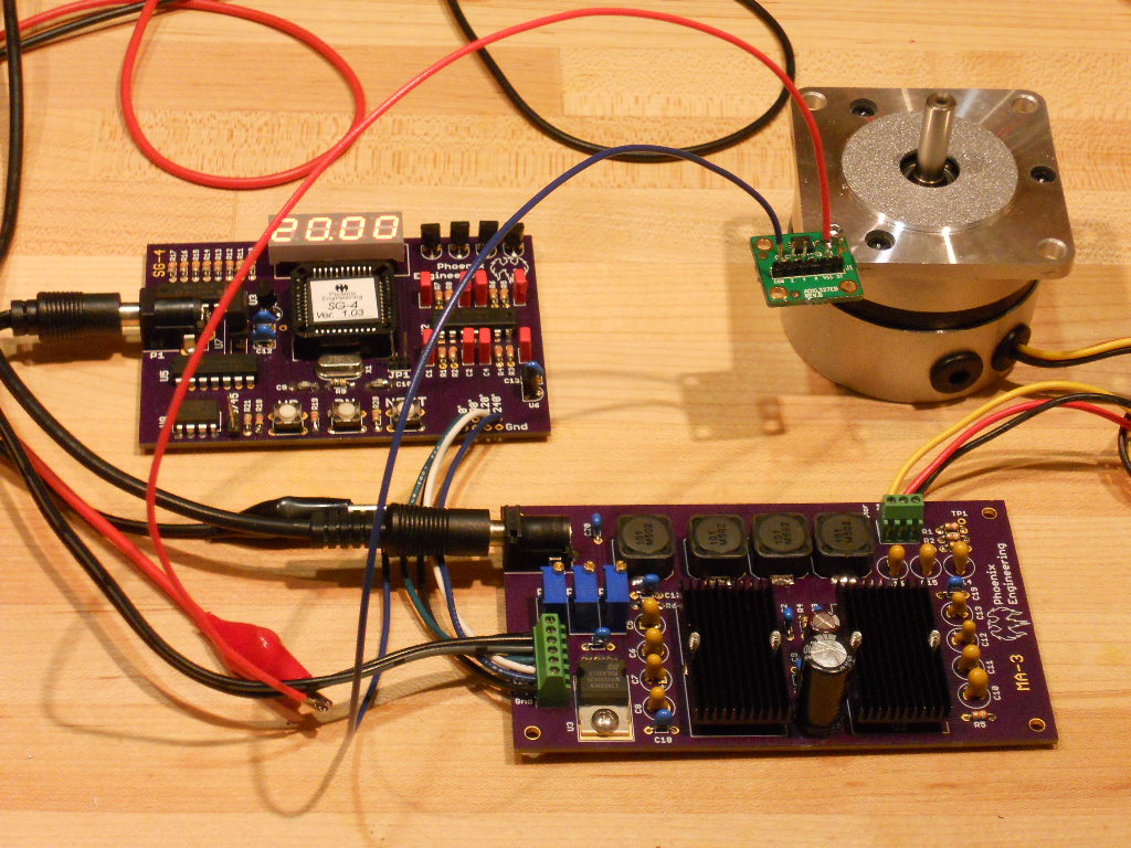

I picked up a 3 axis accelerometer from Analog Devices (ADXL327) which has a full scale reading of 2Gs. I bolted the sensor to both a Hurst 59 series 600 RPM AC motor and the AA BLWS series motor and did some tests using a Stanford Research SR770 dynamic signal analyzer. The two images named baseline are with the ADXL327 mounted to each motor but with the power switch to the motor off (Hurst) or with the SG4 in standby (BLWS).
When started, the Hurst motor audibly hummed at 120Hz; I could hear it, feel it and see it on a scope connected to the ADXL327 output. At 120Hz, the Hurst motor was almost 40dB above the baseline. There were also significant responses at 180Hz, 240Hz and 480Hz.
When the BLWS motor was started, I could not feel any vibration and there was barely a perceptible difference on the SR770 between baseline and motor on. The BLWS series has a response at 60Hz, but it is the same as with the motor off (most likely leakage from the power supply). At 120Hz, the BLWS motor is ~35dB quieter than the Hurst (~31x). The BLWS motor was not mounted in any case; if it were, it would run even quieter.

Wow, that's some very good quantitative results! Did you measure along a radial direction (x or y) or axial (z, along the spindle direction)?
If you're interested, I can send you an ADXL345 breakout board that outputs digitally using I2C or SPI. Don't know if it's necessary given the results you achieved however.
I was connected to the Y axis output. X axis looked to be nearly identical, Z axis was similar in frequency but lower amplitude.
I prefer the analog output sensor. I was going to build a summing circuit that would add all 3 outputs, but the X-Y seem to be closely correlated. Using op-amps, I can also reduce the noise (but also the BW). With the factory LPF filter caps, the BW is ~700Hz.
That's good that the x and y are nearly identical.*It's what you'd expect based on the physical symmetry. I think you could make an argument to not measure y, and just double up the x number.
What are we most concerned with?* Vibrations radially or axially?* Vibrations through the belt, or through the motor mount?* I'm going to guess motor mount.
Analog vs digital: Fair enough.* But you can't do a simple summation.* Example: if Vx =1 and Vz = -1,* you don't want your answer to be 0.* I know that's not the range of the ADXL outputs, but it serves as an example of why.
I think at a minimum you need to take the absolute value of each axis. Or for a single RMS number, I think that's the definition: Sqrt( avg(x^2) + avg(y^2) + avg(z^2)). I think this gets rather complex with opamps, maybe some mfg makes a chip?

I'm still plugging away at the mechanical end of things. I believe I was able to come up with a usable pulley for my application. I had more than one hurdle along the way with the machining.
My first attempt is lying on the table next to the motor assembly. It was done in Delrin. I found machining Delrin pretty straight forward. It definitely has an elasticity to it, so your tools need to be sharp.
I was able to get a usable bore in it starting with a 1/4" centering bit and then finishing with a drill the same size mounted in my tail stock. The material seems to stretch around the drill slightly. This actually worked to my benefit as it created an interference fit with the shaft on the motor that resulted in absolutely no play.
The problem with this pulley was that once I mounted it on the motor and tested run-out with my dial gauge turning it by hand it was unacceptable. For some reason it was not concentric and wobbling off center by .003-.004. After taking some measurements again with my calipers, I realized that the pulley was tapered slightly, but couldn't figure out why. It took me awhile to discover that my tail stock was ever so slightly out of alignment and this was causing the taper of the pulley exterior and also distorting the bore during drilling. I adjusted the tail stock and dialed things in properly by making several passes on a piece of brass stock and retaking measurements with my dial gauge and calipers until I got a straight cut.
Since I already had the brass in the lathe and it was close to the size I needed, I decided to use it for the next attempt. I started the bore in the same manner with my centering bit, although not all the way through the piece at first as my goal was to turn it between centers to get the entire length truely concentric. That was a mistake. As I had to go back to finish boring it in the chuck later on and I felt it was being held ever so slightly different. The full length of the stock should have been bored first and then the exterior turned to size between centers and the belt grooves cut.
I got a pulley out of the brass that is just snug and slightly resistant to going onto the motor shaft. Drilling the set screw holes and tapping them was pretty straight forward on my mill.
Mounted on the motor and clamped in place I managed to achieve about a .0005 tolerance for its rotation at the very tip of the pulley. This pulley is 1.5" tall in order to meet my needs of placing it under the HW19 plinth that I am modifying.
I think I may be able to improve on the outcome and might take another shot at it in Delrin as I preferred the fit to the motor shaft even though it took effort to mount and required a heat gun to expand and remove. Boring it full length first will probably help with that as there won't be issues with air being compressed or vacuum during installation and removal.

If it were mine, I would find a way to grind it down while mounted and running ( I own a lathe also )
Not an easy affair, but you are so close in tolerance that it wouldn,t take much to make it work out. Just think it thru on how you would mount it
If I go this route I would enlarge the pulley in a stepped affair for a little flywheel effect
Brass stock is cheap.
Regards
David
You can get drill rod cheap. Jig it up in 5c collet and machine to shaft size. Check to see you have run out to a minimum. Fast and super light cuts. You can use a 3 set screw pulley or loctite 609 to secure the pulley to the rod. Then high speed super light cuts. You can file a flat on the rod so the set screws hold better.
