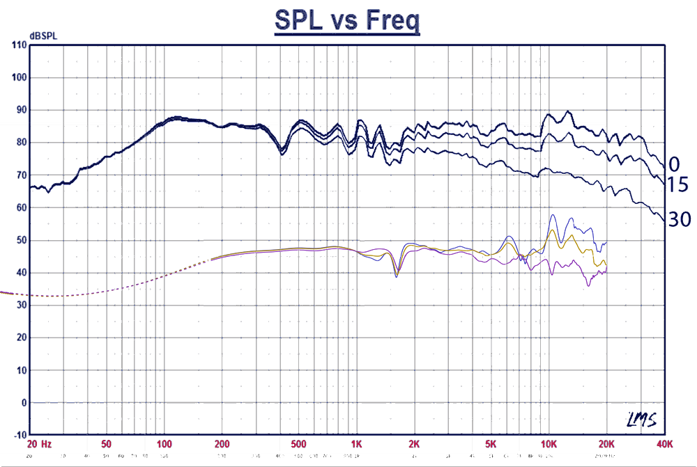

Nothing is said about how these were measured? Just to look at the on-axis response can be highly misleading. We tend to listen to speakers in a room. Power response is a factor, so is spectrum, angle, delay and angle of first reflections.
Measured in room, on axis. THe waveguie offsets the tweeter so that acoustic alignment in near perfect. The Xover is set to where the speaker has constant directivity matching to the woofer at about 1.5K. THe XO is active LR24 so no major phase issues.

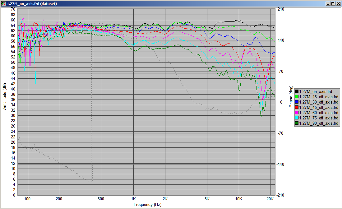

Unsmoothed 0 - 90 😱 I would think that for almost all drivers that would be unintelligible 😉
If it is then the driver is useless.
OK I concede that I based this comment on my own attempts at doing 0 - 90 measurements. With a proper anechoic environment it should be ok. especially if the angles are picked well and not too many. For some reason I was imagining a plot with 90 individual measurements, which is obviously not the intent 😀
Attached was my attempt on my MTM's... I don't remember what sort of smoothing was applied to this but as you can see it gets pretty useless at low frequencies, however it is the higher frequencies where we are generally interested anyway.

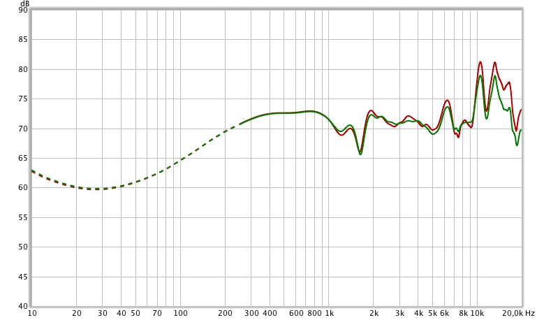

as in this particular sample is defective?
Here's my other Alpair 7.3 (0° and 10°) - looks basically the same:

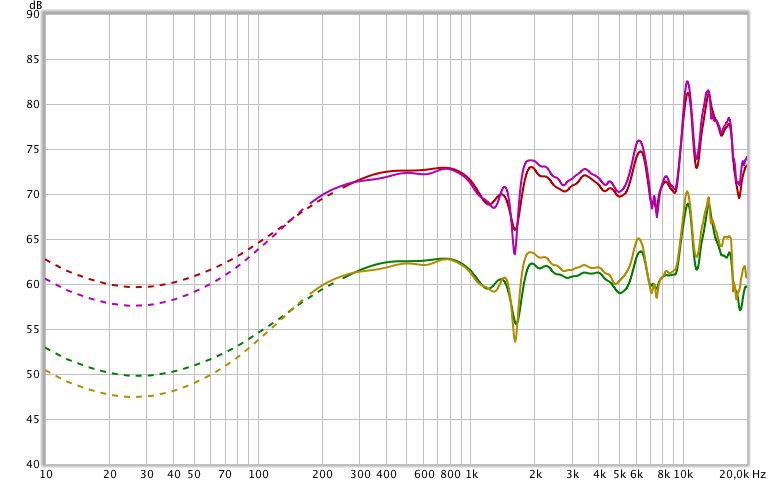

Here's both drivers 0° (top) and 10° (bottom) - excellent tracking:

There are any number of people here that like that driver. Get over it. You are not going to change minds with an FR plot.
Now, do you really listen to wide-range drivers on axis? Of course not. Take the 0* trace off of the graph. Now does it sound better? And of course you have never cheated and used a bit of smiley-face EQ, have your?

Why do I need to "get over it"? I've just presented the facts. People can like whatever they want. I don't tell them not to like the driver.
But all of that doesn't change the fact that
a) the data presented by the manufacturer is different from what I've measured and
b) the off axis data is not smooth.
Bob
If you want the frequency response to be smooth within the listening window then you have to listen to this driver at 0°. Of course it has to be equalized first.
