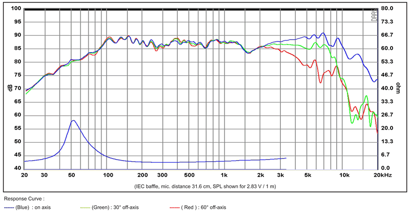

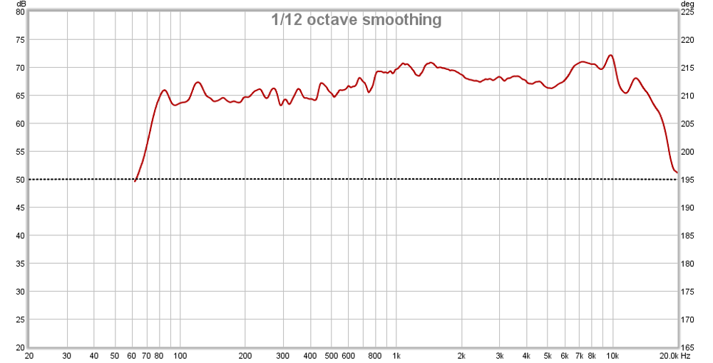

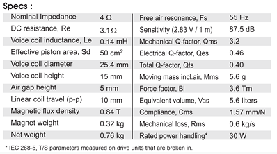

I felt that SB accoustics specs for the SB12MNRX25-4 that I bought (a 4" but not really relevant to this thread) were quite good.

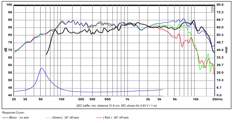

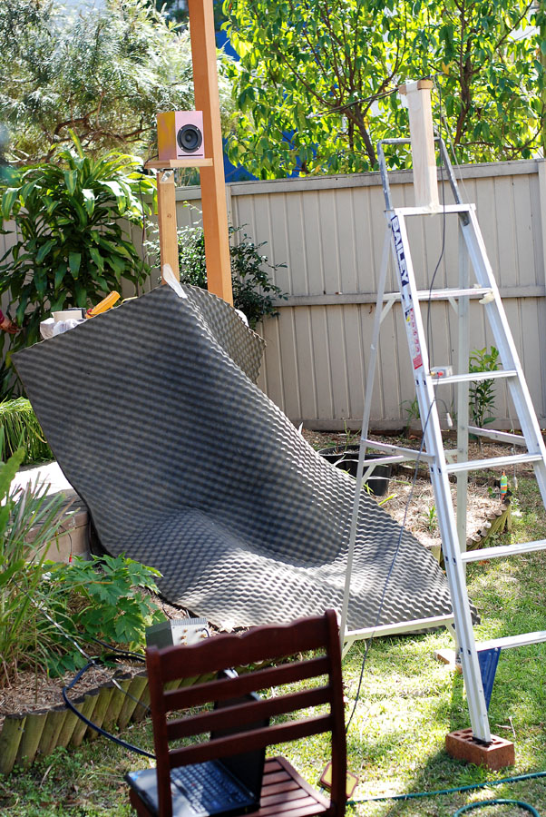

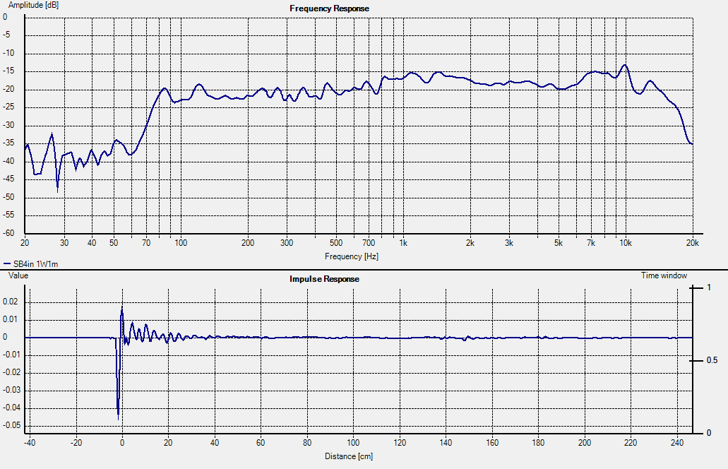

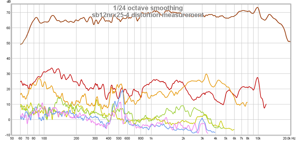

See attached SB's measurement (on IEC baffle at 36CM) and my measurement taken outside free feild in a small vented box with baffle only slightly larger than the driver at distance 1M. Mine is 12th octave smoothed. Also same measurement with distortion data. Note that the baffle geometry filled in some of the dip that occurs at around 1.5Khz with the IEC measurement, (due to the baffle step hump).
When I measured T/S parameters they were well within the variations I would expect when home measuring compared to factory measuring.
Really?
Markus as I said comparing IEC baffle measurement to free field on a small baffle box I don't have the facilities to replicate a factory measurement. The main thing is that they aren't hiding anything in their measurement... I think 1/12th octave smoothing is perfectly fine.
Maybe if I have time I will SPL trace the factory measurement and apply baffle geometry of the cabinet and then compare. But probably not tonight 🙂
What did you use to overlay my measurement on the factory one? I'd like the ability to do that! 🙂
edit: The attached measurement was done outside at a distance of about 30cm from memory... I've detached this from a different thread as I don't have the measurement handy so don't know the exact details, but it was close enough to not be showing so much baffle step.
Thanks for the offer but you don't need to do it for me.
If asked what manufacturers should show I'd like to see unsmoothed data 0°-90°.
Tony.
Did it in Photoshop.
Unsmoothed 0 - 90 😱 I would think that for almost all drivers that would be unintelligible 😉

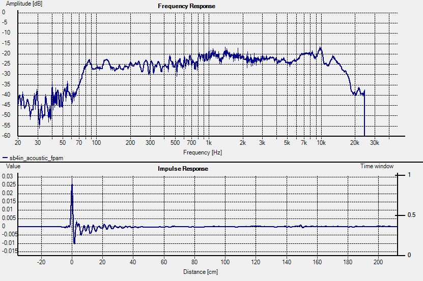

Here is the above measurement RAW (ie no smoothing), but since this is taken outside and there are definitely interacting objects (like a wall about 3M behind the mic, trees, roof, garden etc it has to be taken with a large grain of salt as to what is the driver and what is the environment.

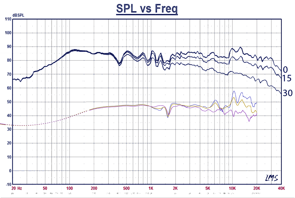

2-way with Beyma 10g40 and TL Labs N26C in a wave-guide. Measures pretty flat with no smoothing applied. Doesn't touch the MA7.3 in sound quality. My opinion is that the woofer is not a good match for the tweeter/wave-guide combo, as neither are bad performers on their own. Unfortunately, the graph doesn't tell you any of this and you would have to listen for the explanation to make since. Distortion is excellent throughout the range. Measurements are useful tool in speaker design and can help tremendously with the final outcome, but they really say nothing about how it will sound. The 7.3 is really the ark I am trying to hit with a multiway, adding bottom end and improving dispersion high up. Yet to do so. Next is C Quenze 18h with TL Labs Tweeter.
