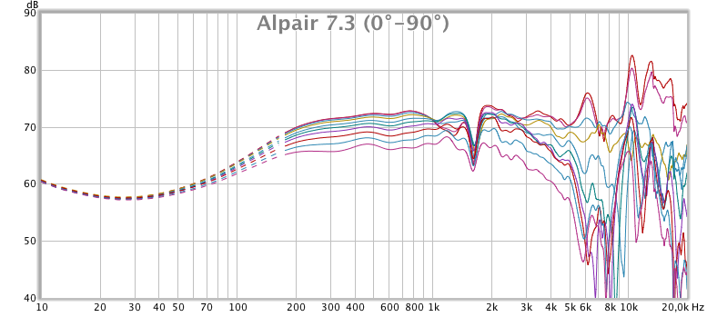

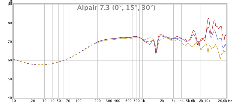

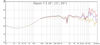

Here's the Alpair 7.3 in a 43x43cm box from 0° to 90°:
(90cm mic distance, gated at 4,7ms)

Here's 0°-90° - pretty ugly:
Markus, is your mic calibrated? Except for the uppermidrange dip, the responses are reminicent of all my cheap measuring mics.

Calibrated mic. The driver isn't good.
as in this particular sample is defective? or that your measurement don't align with those of the manufacturer's, whose measurement equipment is certainly adequate, and the many hundreds of satisfied owners of Alpair7s must all be failing to hear those issues?Calibrated mic. The driver isn't good.

I feel it is worth pointing out here that manufactures specs/measurements often deviate significantly from those done by third parties, either for the better or for the worse.
If the driver isn't defective, if the mic is calibrated (or even if it's not, usually small condensor mics only display either a lift or a droop in the top octave, certainly nothing like this) and if the measurements were performed in a suitable enclosure/environment with suitable gating, then this is how they will measure. Break-in wont change that by much and if it does I'll eat my hat.
All that said, if you compare Markus' measurements to the MarkAudio ones they are roughly concordant with one another.
Markus' measurement - narrow dip at 1800Hz.
MarkAudio's - dip present.
Markus' measurement - peak at ~6k.
MarkAudio's - peak at ~6k.
Markus' measurement - peak/dip/peak at 10/12/14k
MarkAudio's - peak/dip/peak at 10/12/14k.
With all the issues getting less pronounced as one goes off axis.
The only difference is that MarkAudio's measurements seem less severe, ie could be smoothed a little and the huge dip at 400Hz isn't there in Markus' measurements.
The human ear tends to be quite forgiving of very narrow dips or peaks though (unless are room modes), especially ones in the top octave, so the fact that lots of people like how they sound isn't a surprise.
I've got a pair of Visaton BF45 full rangers that peak/dip/peak like crazy in the top two octaves, but sound wonderful by comparison.

I would like to echo 5th Element. Once you account for the difference in scales, the two runs are pretty much the same. At 60-90*, there is so much chance of getting defraction and reflections, even with strong gating. If you want to measure what you hear, step back and that some measurements a 2-3m.

What mic do you have?
Calibrated EMM-6 and calibrated ECM8000.

Yes, yes and yes.
