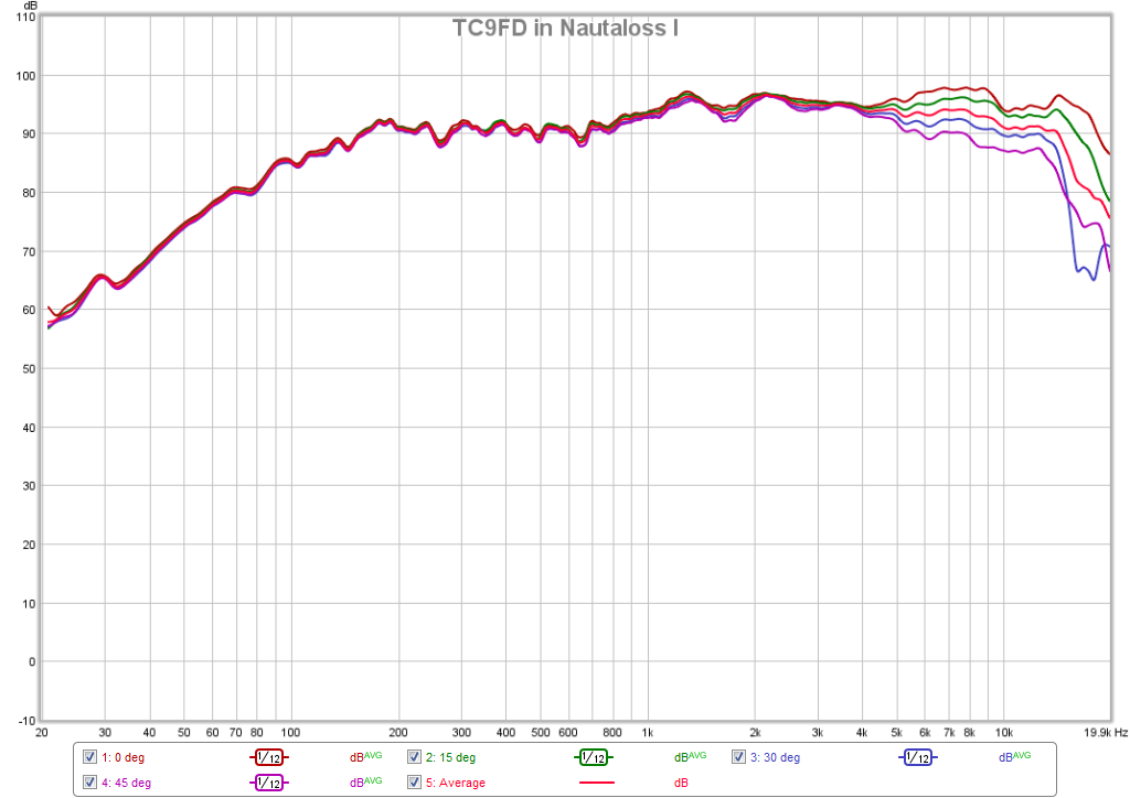

Warts (from post #148) look a lot smaller for the TC9FD when plotted on the -10dB to 110dB scale used by the A7. :)
401989d1393257770-3-4-driver-very-good-dispersion-high-xmax-nautaloss-i-tc9fd-polar.png

I actually chose the same scale that MA uses: -10dB to +110dB in 10dB major increments. My absolute SPL is higher because I did not set volume to be exactly 2.83V and my distance was not 1m. Just showing angular dependence.

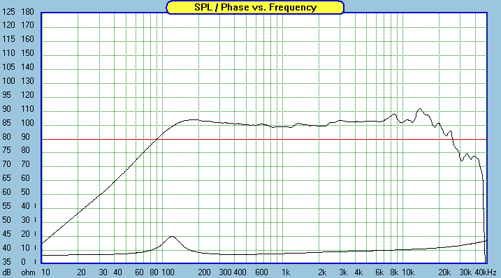

Roger Russel, formerly of McIntosh, put it well when he said that the Peerless TC9 driver is one of the most correctable drivers of its type. It's little brother, the Vifa TC9 is VERY similar. The TG9 has a glass fiber cone, and the TC9 has a treated paper cone, otherwise virtually no difference. And they measure very similarly. Personally I like the TC9 better because it's all black. The TG9 has a light gray cone with a black dust cover, which looks a little weird to me. That Faital 3 inch driver looks pretty good too, if you can believe the published frequency response graph.
Zaphaudio.com is a great website full of every kind of graph for dozens of drivers and suggested systems. Zaph appears to be pretty sharp. His website is a little disorganized; many drivers are not listed in the categories on the front page. I had to go into his blog to get the graph for the Vifa TC9 driver, but here it is (He also has graphs on harmonic distortion, spectral decay, and a few others - check it out - scroll a little ways down the page):
http://www.zaphaudio.com/blog.html

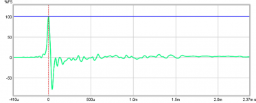

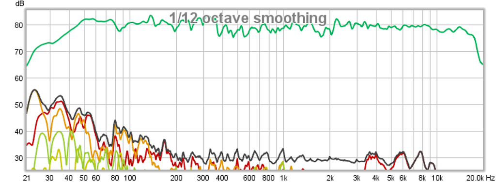

I can tell you that the TC9 paper cone works exceedingly well in a FAST at moderate volume levels (80 dB SPL). Here is a FR of the Vifa TC9 with helper woofers at the listening position (vertex of equilateral triangle with speakers 76 inches apart at 45 in height from floor). Note that the harmonic distortion (up to 5th shown) is about -50dB over the main range of the full range driver. This is essentially imperceptible distortion (0.1% THD in power). Also shown is the impulse response which is very clean - piano actually sounds like a piano is right there in the room. Getting back to the topic of good dispersion - I can walk around the room and I think the sweet spot can be as much as 30 deg off axis. I have tried an experiment and placed a Karlsonator in place of the Nautaloss and the sweet spot did appear to grow much wider- although I did not get a chance to do a polar measurement.
Maybe the Karlson aperture is the way to solve the wide dispersion question? It also lets you put multiple drivers behind the aperture without the vertical lobing normally seen in vertical 2 or 3 driver arrays.
