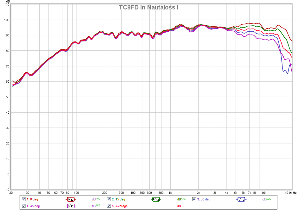

Warts (from post #148) look a lot smaller for the TC9FD when plotted on the -10dB to 110dB scale used by the A7. 🙂
Of course. That's one way of presenting data. MA state they do not use software smoothing; they evidently use a wide dynamic range as an alternative. Similar effect, just as adjusting the horizontal axis can have an apparent visual effect also with the same actual data. They are a manufacturer. It is not in their interest to present data in the worst possible light. But the scales are there in black and white for people to read, so by definition, it cannot be called a lie, misleading or any similar term. If people don't read it, they are not best placed to moan about it after the event.

I've never heard the little Vifa displayed in xrk's most recent post - but it "looks" benign enough - note that if I'm not mistaken, the scaling isn't the same as the several others posted for the 7.3. Failing to correct for scaling differences or measurement conditions when comparing graphs can be in itself very misleading - whether that's to be judged as intentionally nefarious or simply incidental is up to the reader, I guess .
dizzy yet from all those laps around the carousel? - the golden ring you seek is imaginary, methinks
I actually chose the same scale that MA uses: -10dB to +110dB in 10dB major increments. My absolute SPL is higher because I did not set volume to be exactly 2.83V and my distance was not 1m. Just showing angular dependence.

I'm not a measurement guy, so don't be too surprised by the question - any chance that measures taken at different signal drive levels would not be exactly comparable - angular dependance notwithstanding? And could that be particularly germane with wide band drivers such as the Alpairs that as Scott and Mark would likely state whose function in the upper registers is specifically designed with controlled decoupling / micro-resonance behaviour. I've lived with A7s for several years now, and as much as I love them, wouldn't want to listen at a distance of 10ft at the sustained average levels seen in some of the graphs (i.e. mid to upper 90s or more) At those SPLs multiways with horn loaded compression drivers might be a more logical solution. or not
Then there's the question of all the conditions, size of baffle, mic calibration, etc. If it's not been addressed in this thread, assuming that all the conditions of measurements are identical among the various testers could lead to dissimilar results for identical drivers. Of course that wouldn't explain the grossest of apparent discrepancies that have been seen here.
For some reason the printed scale or resolution of that one graph looked different from those posted by several folks for the A7.3, but I don't possess the technical acumen to normalize them.
