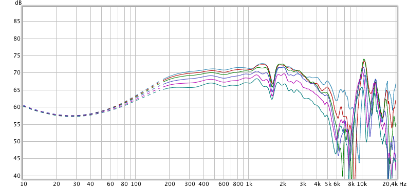

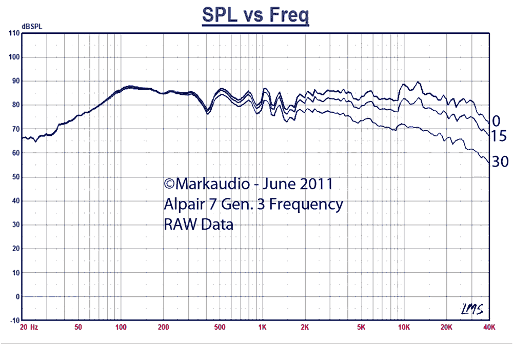

Yes we do. But one question, could you guess the off-axis behavior I've shown when looking at the vendor's graphs? I certainly can't.
I gathered that; I was hoping you could indicate degrees to colour / line. 90 degrees for e.g. is of little more than academic interest. Up to ~30 degrees is about the typical range of use for widebanders; out to 60 degrees I concur has some relevance in multiway design, but not for drivers of this type.
The typical use for any driver is in a room that creates reflections. Just looking at ±30° doesn't show the whole picture. When does that simple fact reach this part of the DIY forum?
Furthermore I'd like to see much closer angles within the listening window where ears will actually be placed.
Well, for example, I was hoping you could post equivalent data & commentry for the other 4in widebanders you have presumably assessed under the same measurement conditions to provide a broad spectrum of data which may assist people in making informed choices.
Sure, the customer first has to buy a driver in oder to get the data that would warrant the buy. How twisted is that? You, Bob Brines, planet10 and chrisb are vendors. Step up to the plate! Otherwise your contributions here are nothing more than sales activities.

I'd think so too but do you have any measurements that would actually show what those warts are? That's what this thread is about.

I could. It is common, even "typical" of cone drivers of that size. As is the "bloom" of the much smaller "tweeter button". This is exactly the same behavior as one sees in any M/T combination (absent the asymmetric lobing that results from vertical spacing) and how it sums to "power response" in the listening room depends a great deal on . . . the listening room.could you guess the off-axis behavior I've shown when looking at the vendor's graphs? I certainly can't.
I find the overall power response rolloff to be not only not a problem, but desirable (and so, by the way, does Toole). Maybe that's (part of) why, despite not generating the "straight line" graph that enamors some, the things sound good in use (as opposed to "look good" under test). The "tweeter peak" does indeed look extreme (although that is easily corrected, if it matters), but it is also quite narrow (beaming) so a couple lines on paper don't tell much about how it sums, or sounds, "in room".
I'm much more concerned by the "glitch" between 1 and 2 kHz, but then that too is common to 4" drivers (though a bit muted by soft cones).
The mechanical crossover in the 7.3 is, by its very nature, highly dependent on the mechanical properties of the decoupling joint. Whether that improves (or degrades) over time only time will tell. It's the price paid for the concentric mounting, and how it compares, in balance, to the irregular radiation pattern of separate M/T combinations will continue to be argued, I'm sure. There's a lot more to how a speaker sounds in use than a few lines on a chart (describing just one of the drivers at that).

What? By looking at this...
...you could predict that???
(40°-90°)
