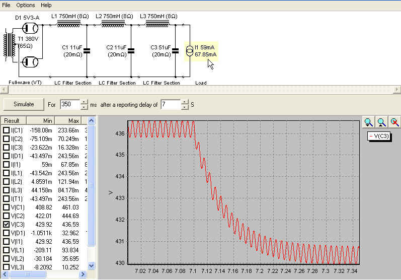

From the 6GK5 characteristic charts, ( at 4.5 mA ) I eyeball a mu of 67 and a Rp of about 11,400 Ohms. With the 52,767 Ohm computed plate resistor, Sheldon’s method of dividing the Ra by the Rp of 11,400 Ohms gives a “TAC” of about 4.63, exceeding Darius’ 4.00 minimum .

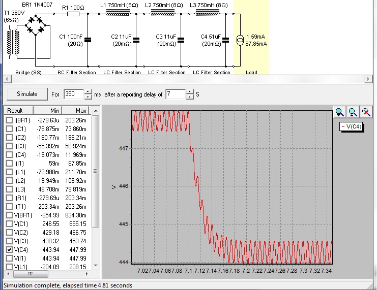

Kudos. This particular DIY thread, over the last few weeks was great stuff - educational to me, and others. The question is, in this proposed and attached schematic ( below) , am I doing L-W right ?? Its almost time to “pull the trigger” and buy the parts. If anyone sees ANY errors in this, please let me know !!
I am satisfied with the raw B+ supply design with (1) just 24 Ohms of series resistances from three chokes in the B+ filter, (2) under 0.8 VAC of ripple, and (3) 200 milliseconds - for a very smooth full-settle after a 15% current step. That is fine…..
What about the audio circuit ? Particularly the L-W part ?? What do you L-W experienced people think ?? Thanks.
And here's an even faster settling time 😀

Hi Jeff,
Your circuit looks good. Some notes
- B+ must come up slowly, otherwise you will see hot voltages on cold tubes.. In particular, the 6GK5 should come up faster than the 5V3 rectifier.
- Increase your ultrapath cap C4 to 47µF. Otherwise you will see high Zout / low damping factor -> muddy or boomy bass.
- The hum bucking cap C5 can be made smaller, 1µF or 2.2µF would work well.
- Some resistor values are pretty odd.
Full power output will be about 1.2W @ ~6% THD (mostly H2).
Rgds,
GB
