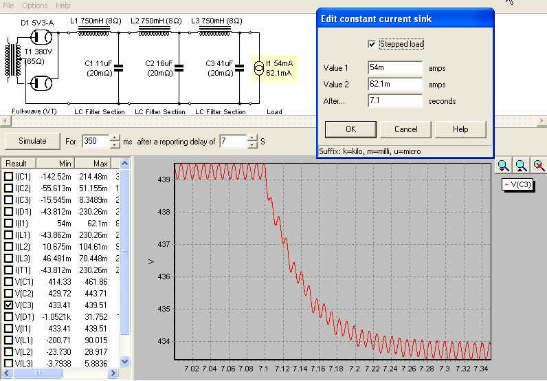

Jeff's Loftin White Power Supply Filter, 6AH4GT DC amp
Well, using a modest Dynaco Stereo 70 power transformer, with all B+ associated leads augmented ( triple Kimber Kable TCSS ) I have finally simmed a LW raw supply I like, that has low DCR as far as B+ series filter resistances...24 Ohms Total, over three L/C sections.
On my home's normally 125 VAC line, I should obtain 439 VDC of B+ with 491 mVAC of ripple, prior to Loftin White hum cancellation. The supply computes to a dynamic Z of 690 Ohms ( 439.26 minus 433.67 is a 5.59 VDC difference, divided by a .0081 A. current step ). It settles from a 15% current step, SMOOTHLY in 200 mS. This is good enough to satisfy me.
The three 750 mHY at 8 Ohm chokes are ones I had custom made for me, six years ago.
Now, to work out the rest of the audio circuit. I can't do much better than what I show, without doing wildly costly custom magnetics for the power supply. Supply / Filter caps will be WIMA DC LINK, all multiple film bypassed.
Jeff Medwin
