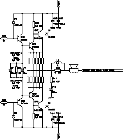

May I draw your attention to the output stage of "The Ultimate Suplifier" (see picture) of which the driver (and the output transistor) is also working in class A. For explanation I refer to my website: www.suplifier.nl.
Marc.

To Marc : By high overload, when predriver transistors ( and output transistors too ) are fully saturated, very uprise " bias " current. This effect is very distinctive by CE connection. Sometimes I had on table Bryston 4 SST, which use this connection ( combination of both, CC + CE ), where at 1 kHz was all OK ( by clipping ), but at 10 kHz in this case power consumption " jumply " uprise from 4 A ( on AC side ) to 8 A ( ! ), only by " touching " of clipping. In this amp wasn't antisaturation circuity, so I'm asking your experinces 😎 .
Not sure what you mean. You can provide damping with a low and real output impedance. Does this necessitate using GNFB?but if we do not use global NFB then we cannot damp unwanted crossover and dynamic loudspeaker resonances that arise within the audible spectrum
Are you implying something beyond the need for the amplifier to remain stable when driving a complex, reactive load?It is essential that the output terminal potential of an amplifier cannot significantly 'react' to dynamic loudspeaker generated back emfs, ie. the amplifier must not allow the loudspeaker system to generate, nor the amplifier itself actually generate within its own circuitry (due to NFB loop sensed hf error correction and possibly non-linear current flow in signal path parallel stabilisation components and device capacitances) an error potential at its output terminal that is momentarily out of phase with respect to the input waveform....

You were “thinking of a design with no global feedback, but lots and lots of short local feedback loops”. See "The Ultimate Suplifier" on my website. If you consider an emittor follower as a local feedback loop (which I don’t), then The Ultimate Suplifier has many short local feedback loops. Because The Ultimate Amplifier is a bridge tied load (BTL) amplifier, it consists of a left and a right amplifier. If you consider a CFP as a local feedback loop (which I do) then The Ultimate Suplifier has on the upper part of the left amplifier 3 local feedback loops and on the lower part of the left amplifier also 3 local feedback loops. Same for the right amplifier, so totally 12 local feedback loops.
Graham,
“The Ultimate Suplifier” is a balanced input, DC coupled, symmetrical, bridge tied load, class A amplifier with no global feedback using transistors. In a amplifying mode (voltage or current) the transistors are composed in a CFP configuration. The output impedance of a CFP is low so the damping is high. I do agree that the damping factor is lowered down by the output resistors of 0,22 ohm. But, because of the CFP configuration in class A without global feedback, the amplifier will be insensible to the generated back emfs of the loudspeaker. The loudspeaker itself will swing out, but that is something different.

Marc Vi. said:May I draw your attention to the output stage of "The Ultimate Suplifier" (see picture) of which the driver (and the output transistor) is also working in class A. For explanation I refer to my website: www.suplifier.nl.
Marc.
http://www.suplifier.nl
This output stage has been in use in audiolab's amps. (now Tagmaclaren audio) for nearly 20yrs..
Oké, Mikeks, but I have never seen the schematics of audiolab's amps or Tag Mclaren Audio amplifiers. And I didn't find those schematics on internet either. Do you have those schematics and will you publish them or email to me? And if not, where can I find them?

Hi Mikeks,
Maybe my output stage is not original although I have never seen the schematics of audiolab's amps or Tag Mclaren Audio amplifiers before. But whose ideas are original these days except maybe Susan Parkers non feedback amplifier?
More important, Mikeks, is your opinion on this output stage and on “The Ultimate Suplifier” in general. May I invite you and all others to react on this.

Hi Marc,
Thank you for your contribution of the Suplifier.
I will confine my comments to the output stage.
#1. The CFP output pair draws output device current direct from the rail; the purpose of the driver device is to precisely direct the collector efforts of the output device. I think of it as a monkey sitting on the elephant, directing the trunk by pulling at the elephant's ears. Thus, at say 6A output device collector current, the base drive might be 6000/60 or 100mA, and if Vbe of the output device at this current is 1.5V, then an additional 15mA will be drawn through the driver collector resistor, giving a total of 115mA. If you choose a driver with a beta of 80, then the driver's maximum base current will still be less than 1.5mA, so, why do you need to drive it with an emitter follower, an additional phase-inducing stage? I believe the high impedance collector of a VAS running at around 8mA would enable the output stage driver to be driven direct without problem, and lower component count. This would reduce phase shift, and permit simpler, less sonically intrusive lag compensation.
#2. Your circuit is fine for Class A. I have experienced short term instability with CFPs in Class AB. This problem occurs particularly as the negative rail side switches off; short term oscillation can be cured by a cap between base and collector of the driver, but this then kills the music.
#3. I have not checked back through the thread, but recall you used a fully complementary input stage, viz two diff pairs. Is this correct? If so, I would suggest that the resulting complementary current drive to the VAS makes it tough to properly control offset, but more importantly, scotches even order distortion, leaving only odd order. This skews the distortion spectrum, and while it looks great on paper, I'd suggest the sound is better with a single diff pair.
