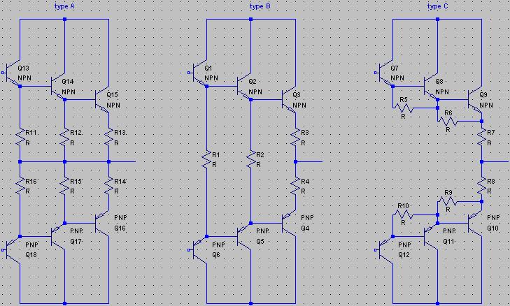

Marc Vi. said:Oké, Mikeks, but I have never seen the schematics of audiolab's amps or Tag Mclaren Audio amplifiers. And I didn't find those schematics on internet either. Do you have those schematics and will you publish them or email to me? And if not, where can I find them?
Thank you,
Marc.
http://www.diyaudio.com/forums/showthread.php?postid=662633#post662633
- 3 Different Outputstage Driver Arrangements, Your Opinions!
