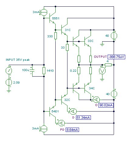

Hi Sajti,
I still do not see 'B' maintaining class-A pre/driver operation at all times.
Most of the time maybe, but I can see the possibility for momentarily harsh sounding high level reproduction.
At maximum output, with say a CCS pulling Q1 up and the VAS off, Q4 carrier/charge might well be capable of momentarily reverse biasing Q5 when voltage is dropped by R3, because Q6/Q5 bias is not referenced to the Q4 emitter resistor.
Unfortunately my thoughts for possibility are not good enough, so I have simulated the driver current using this circuit.
I am also surprised to see pre-driver crossover spiking.
Both the spiking and 'non-class-A' current dropout will have audible impact at these instants.
Cheers ........... Graham.

Your results quite interesting! Unfortunately You not labelled the parts, so I'm not sure which is which It also interesting how the capacitors across the emitter resistors change the result. Another question: How much bias current necessary for the drivers to keep them in class A?

Hi Sajti.
The parts are labelled, semiconductor numbers abbreviated.
It is as much a carrier build up as capacitance in the base region that causes this.
I believe that Michael was broaching this aspect (post#25) in his response to PB2.
Floating resistors cannot (nor the parallel capacitor) guarantee permanent class-A operation, especially with the likes of high energy cymbals driving a crossover/dynamic LS system when the output voltage and current phase can become so far out of phase.

I mean Q1, Q2, Q3 etc... The types are OK.

Hi Sajti,
Oh I see what you mean now.
It seems you expected me to number every component.
*My simulator does not lend itself to doing this easily or clearly* and I am amazed that you make such a petty point.
It is not a circuit diagram, but something I took the trouble to model on your behalf in relation to your statement !!!

I just want to be sure, that which is which, to follow Your explanation.

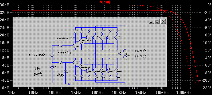

Graham Maynard said:Hi All,
...it introduces additional phase change when compared to those originally being discussed.
A magnitude phase plot of the attached circuit (and the one
from the previous post) gives a phase shift of the following:
-1.34 degrees at 1Mhz
-.141 degrees at 100Khz
-.0282 degrees at 20Khz
-.0141 degrees at 10Khz
this looks really good, and I would think it compares well
with the other 3 circuits, AFAIK.
Mike

Graham Maynard said:And the Current/Voltage simulations.
Graham,
Actually your simulation shows that each member of the first pair of drivers conducts throughout the cycle...
Which proves class-A operation......
As I checked the simulation made by Graham, I found the following:
The output drivers are not working in class A all the times, if I drive my amplifier to the clipping, with 20kHz sine wave, AND I set low bias for the drivers.
To get class A operation every time, I have to set the bias high enough, to charge/discharge the input capacitance of the output transistors. This means, that 100-200mA bias for the drivers are not too much. I checked the Mark Levinson 23.5 amplifier. It use 3paralleled MJEs to drive 8 MJ15024s. And the bias is about 150mA for the drivers, and about 30mA for the predrivers...
The crossover spiking in the predriver stage resulted by the switch on/off of the drivers. So if I set higher current for the drivers, and avoid the switch off, there will be no problem with the predrivers.
