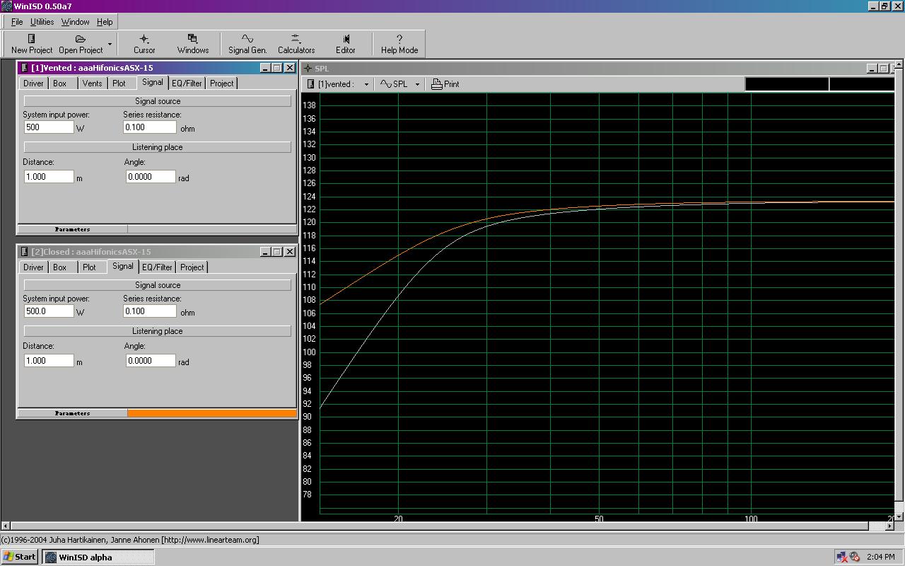

In the pic below I've modeled the four drivers in the box volume you posted above, one ported one sealed, both using 500w. The sealed box is using a PEQ set to Fc =25Hz Q=1 Gain=6db. For the sealed box this is max output (123db at XO). For the ported box you could use 1200w but you would only get 4db more output.
Sealed has the benefit of ease to change the sound, and better group delay and transient timing. Since you have so much potential output (+120db) I'd keep things simple. If you were trying to get as much as you could out of these drivers you could use a TH which while larger than BR is more efficient, and BR is more efficient than Sealed. But since you can get more than you need for movies sealed... enough said.

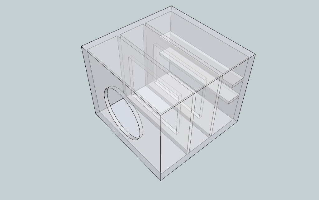

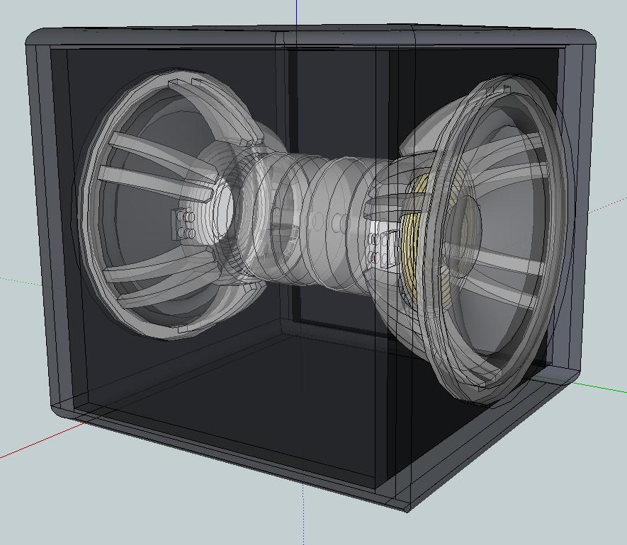

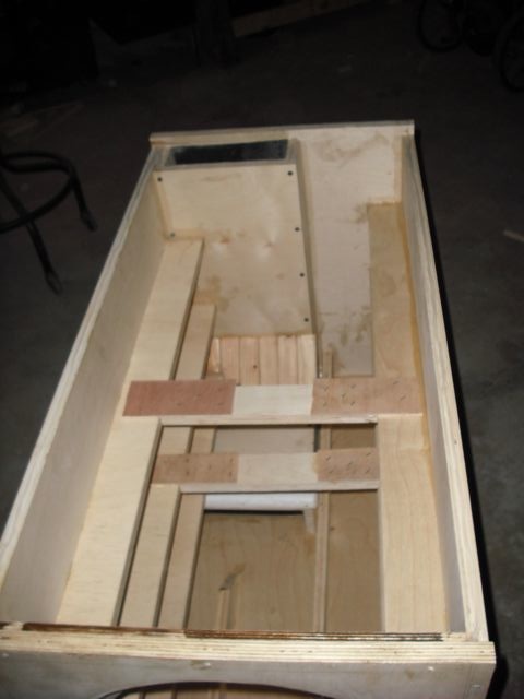

I think I will go with your suggestions to do sealed as a first box. I could of course change to more complex designs later is this is not enough. I'll try the below mounting mechanism.
Are he drivers supposed to touch each other? Or is there a small gap between them? Any good thread or link for good bracing/box design?

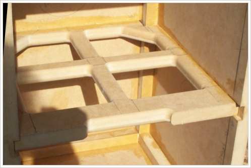

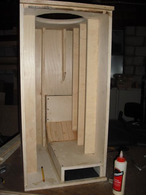

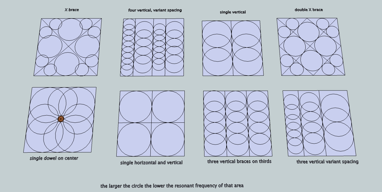

The magnets should not be touching the pole vent (the little hole on the back of the magnet) needs to breath. Bracing on the other hand is a tricky subject, I tend to go with long side bracing with side to side connecting braces, i'll attach a pic of an example (first and second pic). Some like shelf braces the last pic is an example from Speaker Building
edit: I labeled the number of braces wrong on some of the examples on the diagram with all the circles, it should have been number of open panel sections but I wrote it as the number of braces, oops.
