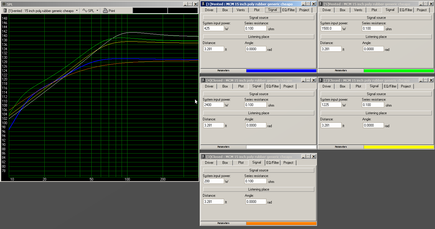

Ran the sims again to double check and came up with this:
Blue is 6 drivers, 45ft^3, vented.
Green is 12 drivers, 45ft^3, vented.
White is 12 drivers in 24ft^3, sealed.
Yellow is 12 drivers, 45ft^3, sealed.
Orange is 12 drivers, IB (simulated via 1000ft^3 sealed box)
Signal levels are chosen based on where Xmax is reached for the system above 20hz. The vented enclosures are tuned slightly differently to match Pe at 20hz with the bottom of the Pe "dip" above tuning frequency.

Great. Thanks for all the effort! One more question. I see that the IB have 200W as input and it plays at the orange curve. Is this the limit of the 12 drivers? What if I indeed had 800W per tower of six woofers?
If you drive 1600W into the 12 drivers at 20hz in the IB, the voice coils will likely take a return trip via high velocity projectile across the Atlantic.
200W will hit max excursion at 20hz across all 12 drivers, (yes at about 17W per driver).

In that case IMO about 50W per driver might be about right.
There is no point limiting excursion further up with low power.
This is the case with all low Q sealed or IB alignments.

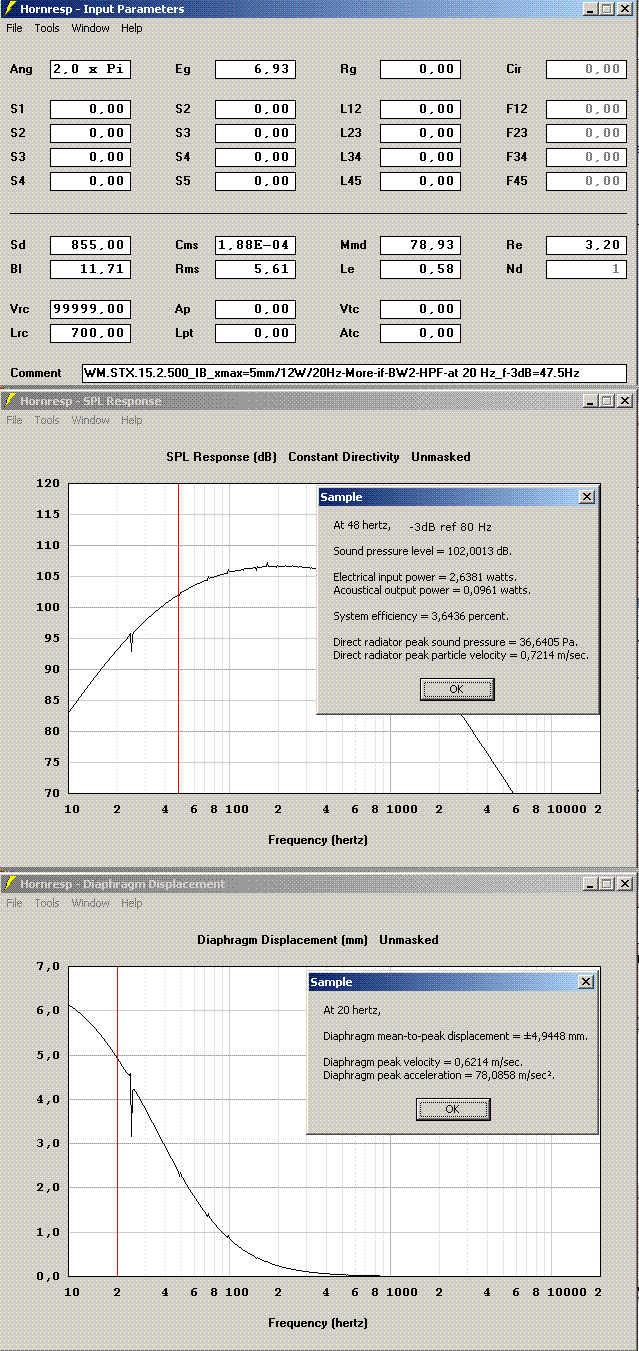

Hej Bjorno,
Around 34E per driver. A bit more expensive but shipping probably cancel that out. 10mm lineat excursion is better the the MCM woofer. Hmm I wonder how this one models in a IB?
Do you have any experience about this driver? Anybody at hififorum that might have used it?
Tack
..Hmm I wonder how this one models in a IB? ..Do you have any experience about this driver?

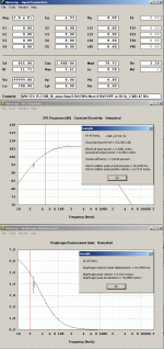

..I will make a try to model an IB later this evening...
I guess this driver isn't good for IB use: The Xmax😱 and Qts😱 are the limiting factors..
b🙂
I don't personally see anything wrong with using them in an IB.
bjorno, what specifically troubled you about their use in an IB?
Maybe they are not optimal and not the most powerful ones, but I would have thought that 12 of these drivers will work better then the MCM drivers in the IB. Their Qts is about the same and these drivers have 10mm xmas instead of MCMs 6mm.

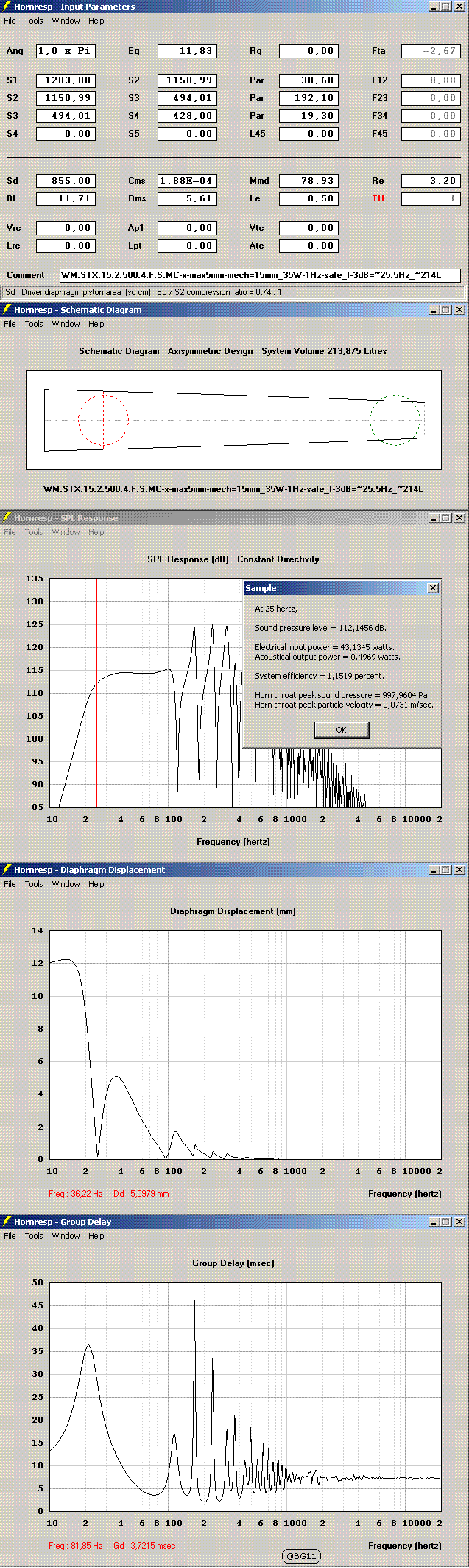

The plan seems to be two towers with 6 drivers each, with 3 drivers
front and back for force cancelling, connected into the floorspace
for infinite baffle loading, both being LFE I would assume.
This will work, excellent use of a 15" driver with a Vas of over 10cuft each,
giving a excellent critically damped Q of ~ 0.5 at 33Hz. Nevertheless like
all sealed and IB arrangements excursion increases relentlessly the lower
you go down, and I'd recommend a plate amp with a Q=2 high pass filter
for low bass boost and excursion control below 20Hz for max volume.
PE do one with a peaking 18Hz high pass filter, should be ideal.
http://www.parts-express.com/pe/showdetl.cfm?Partnumber=300-750
http://www.parts-express.com/pdf/300-750.pdf
The towers only have to be about 1 feet deep, 1.5 feet wide and 5ft tall
(or taller to match the mains), still tiny for 6 x 11.5 cuft Vas drivers.
