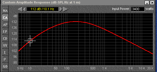

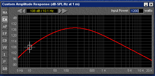

Okay did some modeling using bassbox. Not sure if I am doing it right though.
Following graphs are for 4 of the Hifonics ASX 15" subwoofers in an IB (20m3 box). First scenario is with 1200W power (one amp board of 300W for each woofer) and second one with 3400W power.
First scenario give me 116db at 20hz and 108db at 10hz with a cone excursion of 20mm at 10hz. Second scenario give me 120db at 20hz and 112db at 10hz with a cone excursion of 33.6mm at 10hz.
Does this look good? What does these figures really mean though. To little, enough, or to much? The extra amp power will cost a bit so is the difference of 4db going to be noticeable?

Notice 4db, no. At 116db at 20Hz what you will notice is all the things in the room that are not glued down. :) For thx spec you only need 112db at 35Hz and 105db at 20Hz. Are you planning to use the minidsp to eq these flat / cut the upper frequencies?

They are the same as above but the xmax instead of 35mm is 16,4mm linear in one direction.
