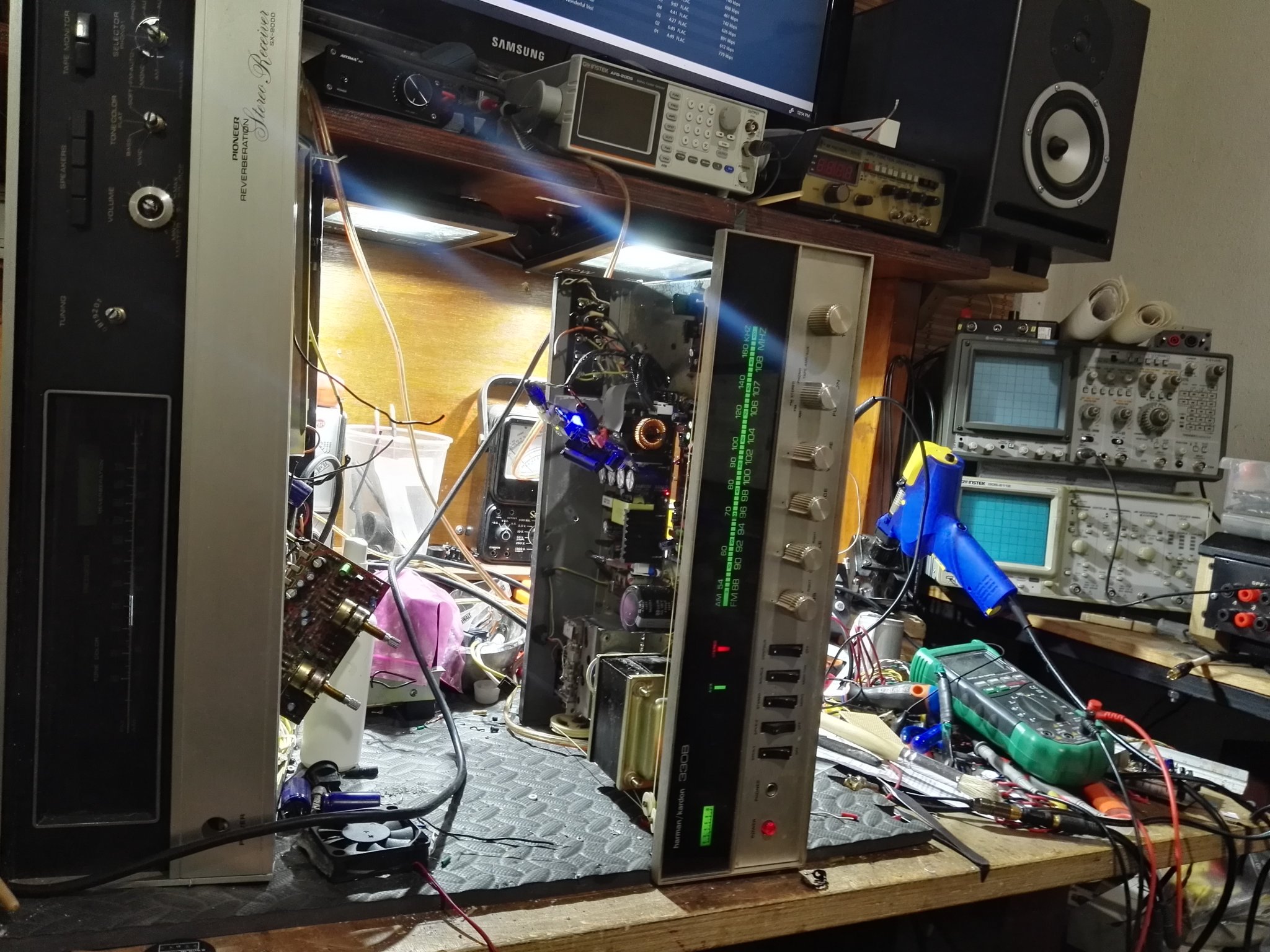

I'm retrofitting one FFA001 V3 to an old HK300B (basket case for those cap couple fans) boy this boards are fun to play with... they sound very good.

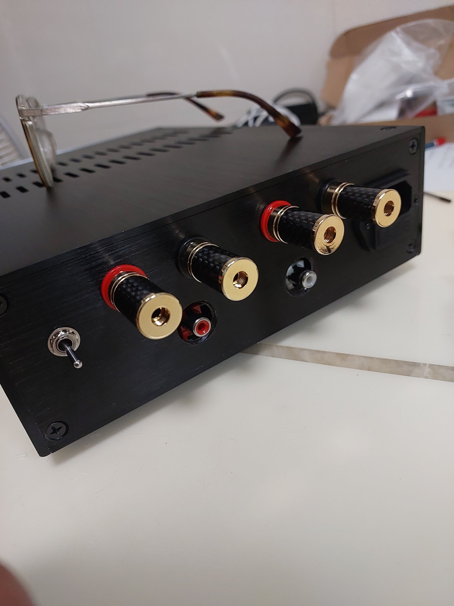

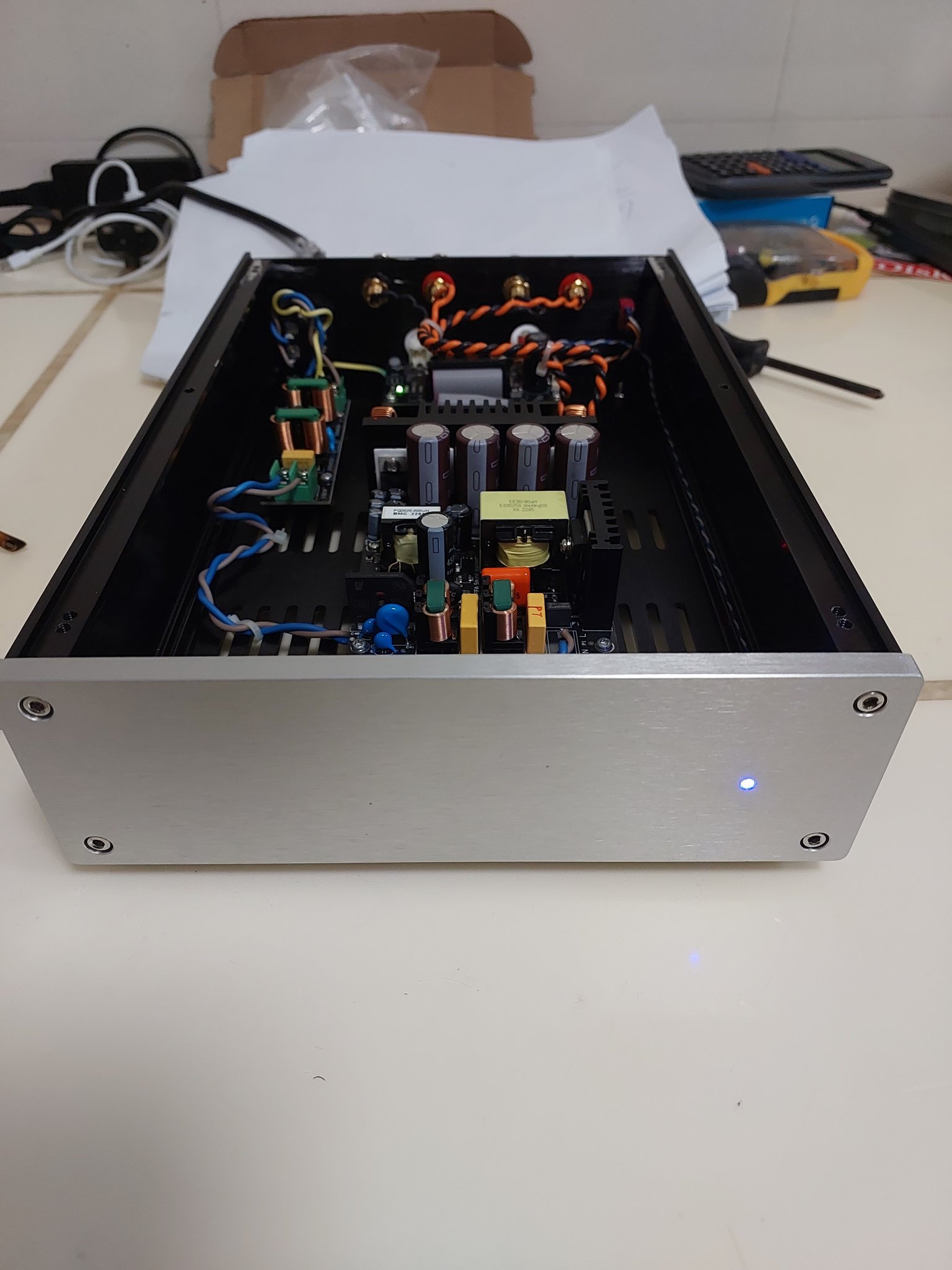

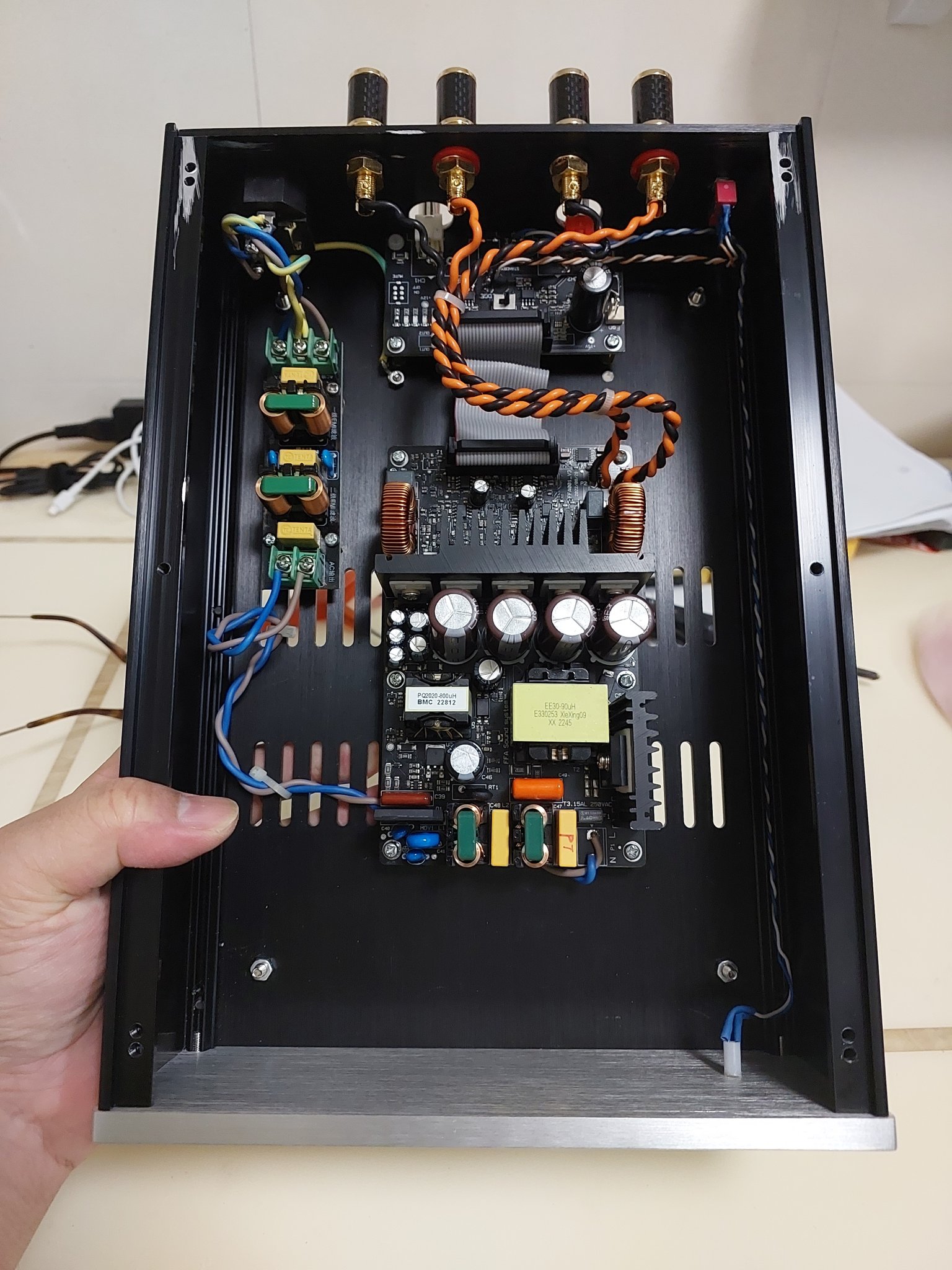

Finally found some time and a chassis to enclose the amp properly. I have wired up the standby switch out of the board so to that the cables do not get it the way. The blue led indicator is also wired out with to the front panel so that its status is visually accessible at the front panel.

The amp will come with the speaker cable with a female connector to plug in to the male pin connector on the board. However it's length is not sufficient for my chassis layout. Hence I removed the connectors on the amp board and solder my belden 9497 speaker cables directly into the board.
Mounting into the chassis, wiring it up, drilling holes for the board, connectors , shifted components ie. Switch, led etc didn't take me more than three hours. Piece of cake.

The power connector comes with the chassis purchase. The on/off switch originally sits on the amp I/O board. I removed the original switch and used my own switch. Eric posted a list of compatible switch to use somewhere in the thread. The way to connect it, is simply to do a pin to pin connection with the original switch that comes with the I/O board.
