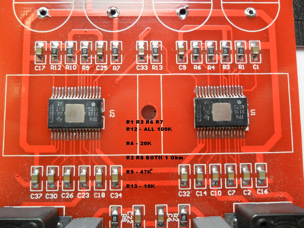

Btw you are certain the 75k and 47k are configured like on your defective ampboards left chips 100k/20k, not like defective ampboards right chip 47k/75k ? So the right chips have flipped resistors if you compare both ampboards?
Wouldn't be a massive surprise if they decided to ship dual slave ampboards LOL
So what then is the best configuration for this board? I have the same board with R13 installed. Without R13 I get 36dB of gain and with it only 26dB? If R13 is simply removed you're saying the input z changes?
Look at TI's datasheet
r13 is there to connect synch from master (left) to slave (right), however the signal arriving at slave chip isn't recognisable, slave doesn't know what to follow. So removing r13 changes nothing, with or without you have not properly working slave chip. Now chinese remove r13 AND change gainsettingresistors, they select different gain and set both to master, see datasheet.So what then is the best configuration for this board? I have the same board with R13 installed. Without R13 I get 36dB of gain and with it only 26dB? If R13 is simply removed you're saying the input z changes?

On your ampboard you can remove r13 without any change. At the moment it is not functioning properly and without r13 is will function the same.
Many threads here, 3116 main thread first, share 10k/1nF filter not being able to give slavechip synch signal. TI support answered they were aware many moons ago and would update datasheet, they didn't, and they told to take values from TI 3116EVM, those were correct, 4k7/47pF. For fun use (Sample)RC Low-pass Filter Design Tool - Result -
and compare frequency respons for both RC filter, watch frequencyvalues below graph, shape is same 😀

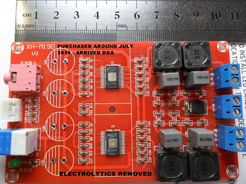

Pics of my July 2015 board which arrived DOA, electrolytics & large, single heat sink removed. It has has R13 & gain resistors are for 26dB, master/slave & 33uH inductors.
Second pic is a blow up of a section of the PCB, with resistor values shown ... for what it's worth 🙂
The board I later purchased, arrived a week or so ago, had no R13 & gain resitors are for 36dB, master/master & 10uH inductors
Both original & new PCBs show: XH-M190 V3

Is pcb different? I mean there is one via for psu inner side chippins, in the middle of ampboard and the hole in pcb between chips seems right where picture shows bottom trace leading to that via. Is diode connected to switch (3 vias there that are probably in middle under brown color stuff that might not conduct)? Is switch working?
