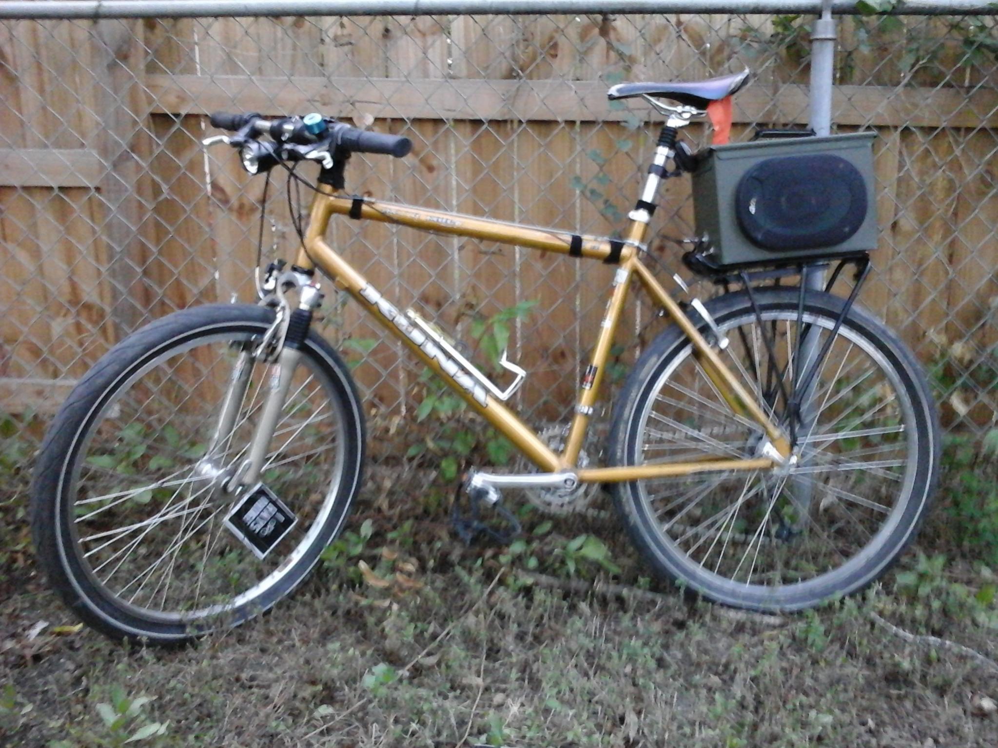

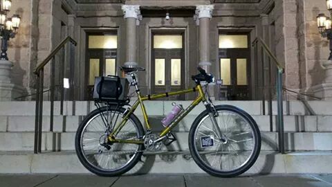

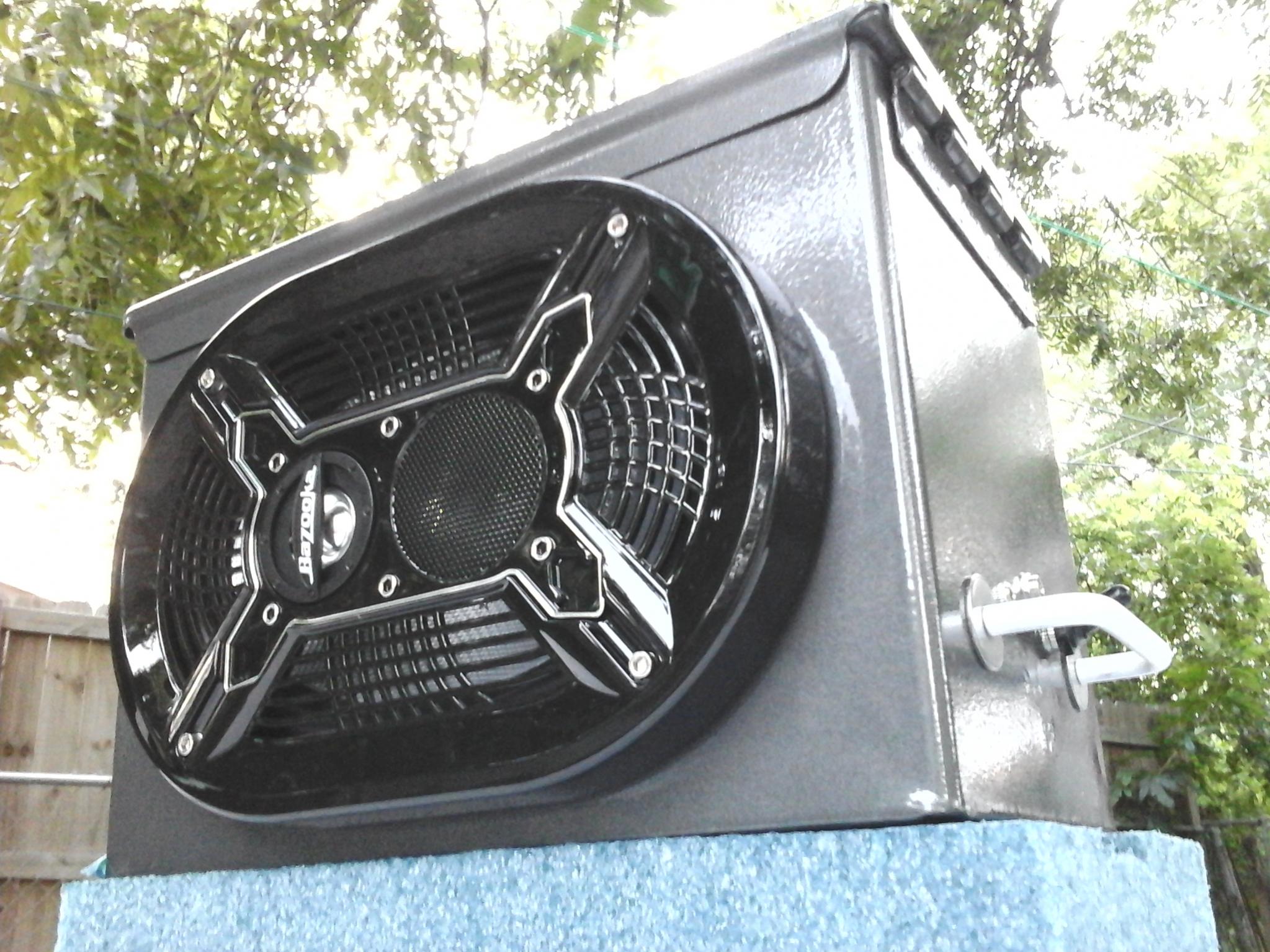

AmmoBlaster tpa3116d2 2x100watts
So far, I use the board bone stock and add a 2500uf capacitor to the power input. Works great.
The board works fine on 12v but really comes alive at 20v.
The sound is very clear and clean and the boards seem immune to the rigors of their current enviroment. I mount them on silicone isolators and then further dampen the mounting board with foam rubber, but they still get a good thrashing and just keep screaming.
