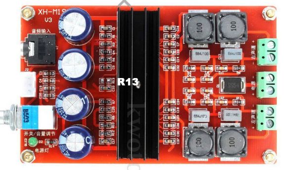

Dual 3116 with single heat sink - no R13 (10K)
I purchased in July this year a dual 3116 (marked: XH-M190 V3) with a big single heat sink across both chips. It was DOA, got a refund, still have it
Purchased another one about 3 or 4 weeks ago, works OK. It's also marked: XH-M190 V3
The DOA one had 33uH inductors, the new one has 10uH, both having 680nF caps on the speaker sides of the inductors. Looks as though XH-M190 V3 relates to the PCB only, not the components !!! 🙂
What interests me is the DOA one had a 10K resistor marked R13, looking like it was linking the synch pins on the two chips, with an adjacent cap marked C33 to ground ... as per TI 2.1 schematic on the datasheet
HOWEVER, the new one I received has no R13 (although the solder pads are in place, not connected). C33 is on the board. To my non-golden, non-audiophile ears, the board sounds OK
The pic is from ebay, missing R13 clearly shown (I've put a big R13 in white so you can't miss it)
Would DocMord or another guru tell me if I should add R13 10K resistor to the new board, please?

gainresistors second chip can tell you if it is slave or like left chip also master, they removed the not working synch connection, however it seems they also removed capacitor to gnd for synch output this way, if I can see pcbtracks correctly, I believe Dug thinks it is better without when not used, don't know.
Yes, if sound is good, leave as is. (Assuming both running in master mode. Using sync needs you to change 2 other resistors as well to have one running as slave)
If !!! they!!! changed rightside chip from slave to master, if not it will sound the same as befor, but output still!!! might have very strong low switchingfrequency component(s)
That nailed it !!!!!!! I should have looked before asking 😱 Thank you 🙂
The DOA board with the synch link resistor (marked R13 on the PCB) is configured master/slave with a 26dB gain ... 100K GVVD & 20K on one chip, 47K GVVD & 75K on the other chip
The new board without the synch link resistor (marked R13 on the PCB) is configured master/master with a 36dB gain ... 75K GVVD & 47K ... on both chips
