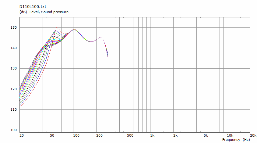

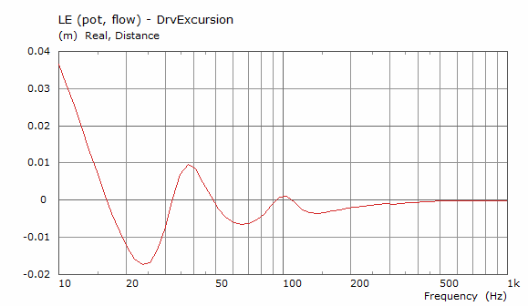

The frequency response matches the Stasis X-air published specs, though the 38Hz 24dB crossover in the specs still makes no sense with a 30 Hz low corner.
The impedance curve suggests 6th order system, but that's a pretty wide bandwidth (30 Hz to over 200 Hz). That is a pretty decent response curve, and there are no out of band funnies either.

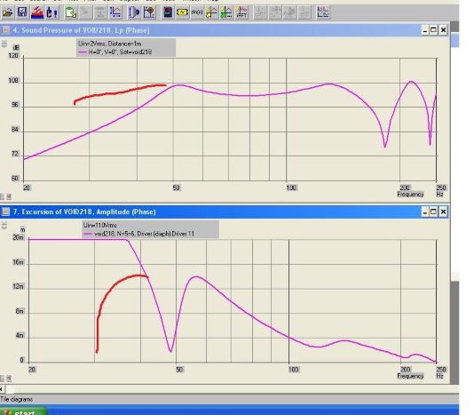

The impedance curves in #11 and #19 would indicate the excursion minima would be around 29 Hz, maxima around 48 Hz, so a 38 Hz HP would not be a logical excursion protection point, regardless of driver choice.@Art, To me the most logical explanation would be to protect the drivers for over excursion. We do not know what drivers are in the void and what specs they have.
Looking at the FR and impedance curves, looks more like a typographic error, HP should be 28 Hz, not 38.

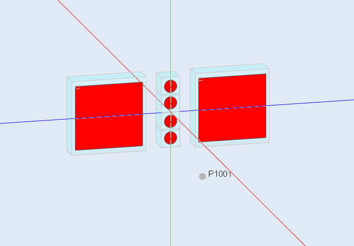

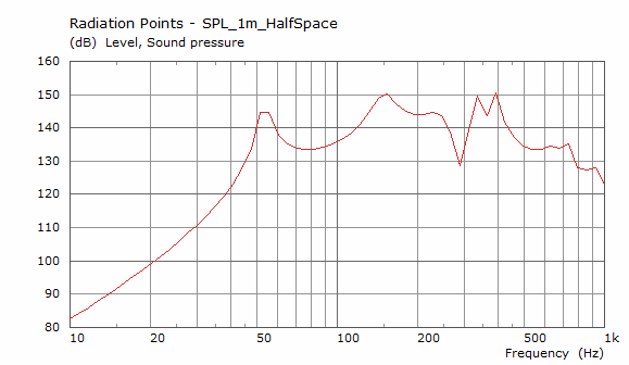

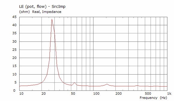

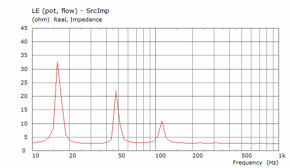

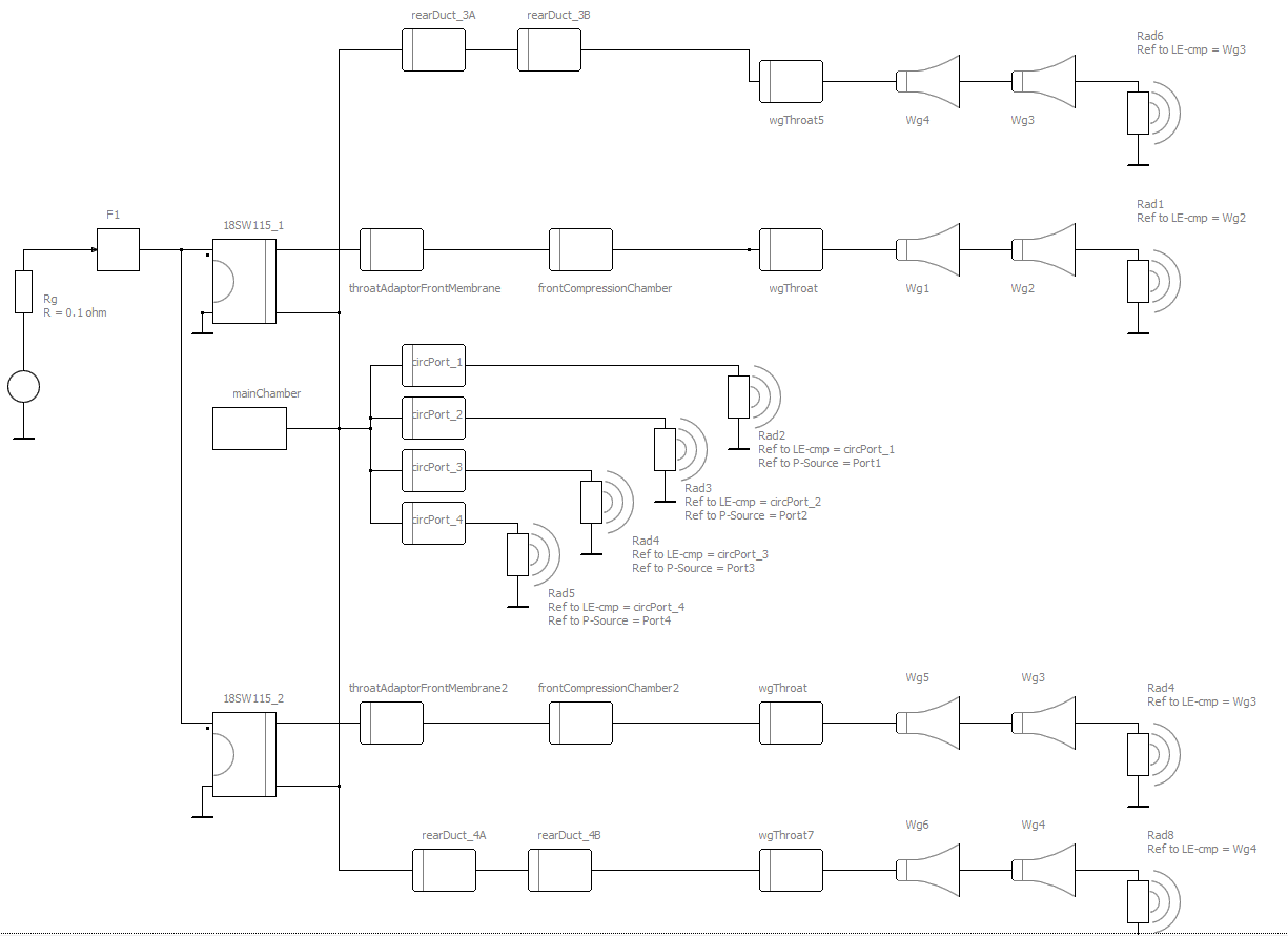

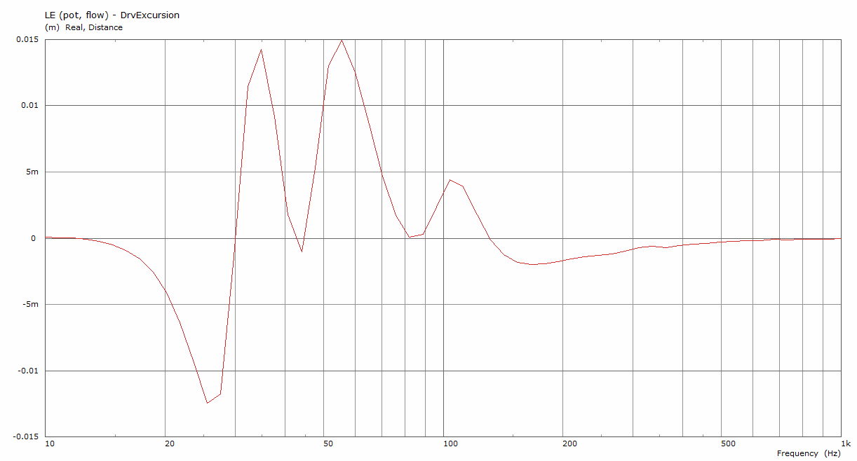

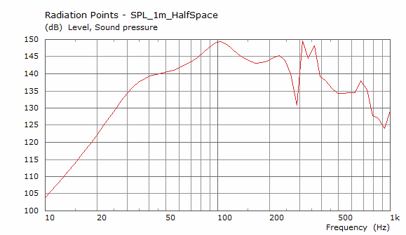

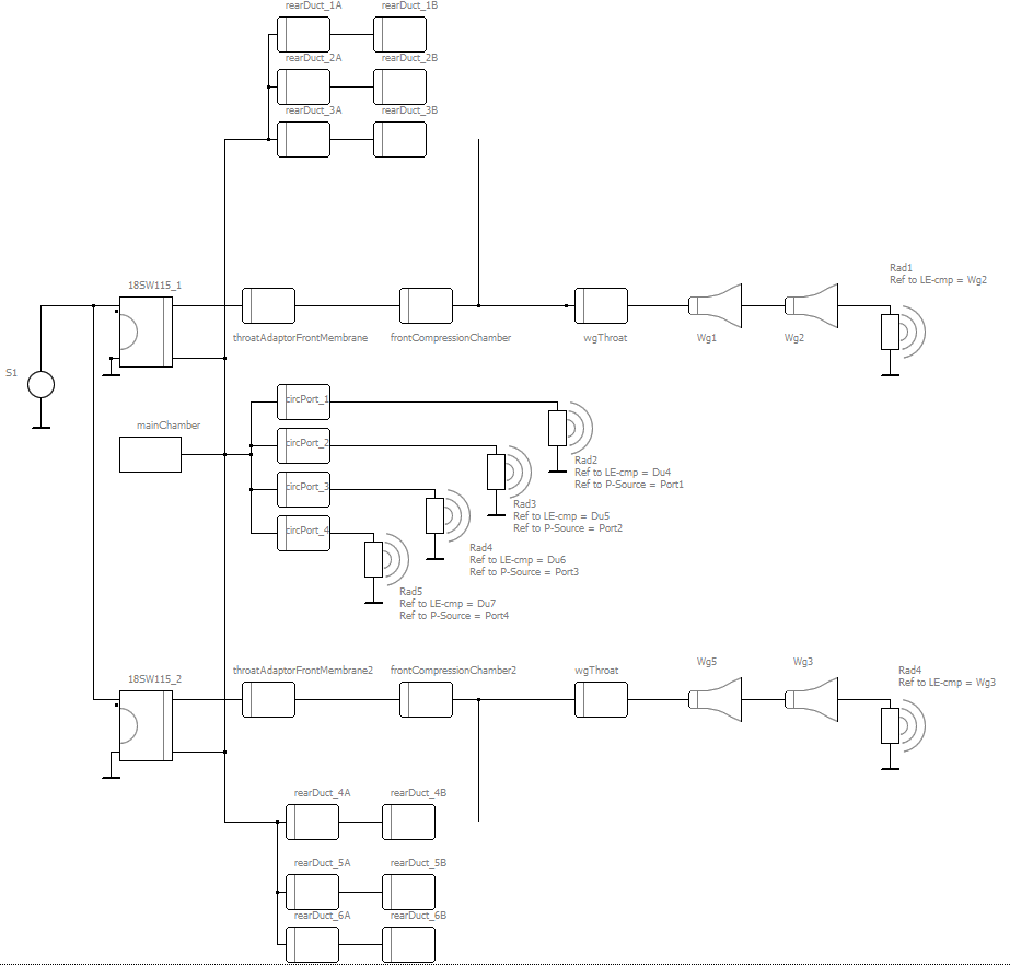

I made some LEM sims in Akabak and must say I'm pretty confused.
BEM setup - half-space ground measurement 1m
This is what I got with horn-loaded re-entrant ports going from rear chamber.
As you can see these charts are far from original stasys measurements.

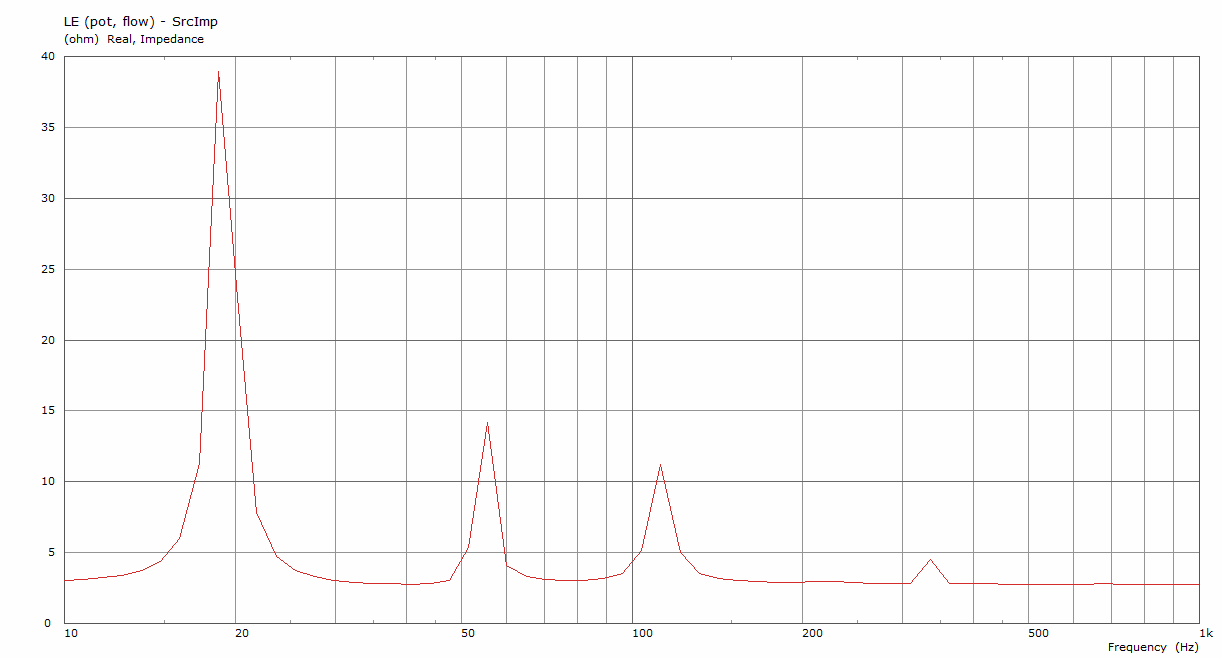

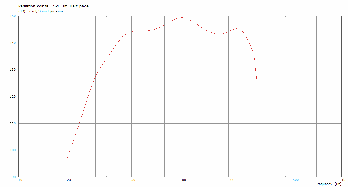

However I tried to close rear ducts at the horn throat side and result is much nicer. The impedance chart almost copies the original stasys chart.
Next step is to sim the system as BEM+LEM so that in BEM will be the full geometry except the front circular ports which can be added easily as lumped elements.

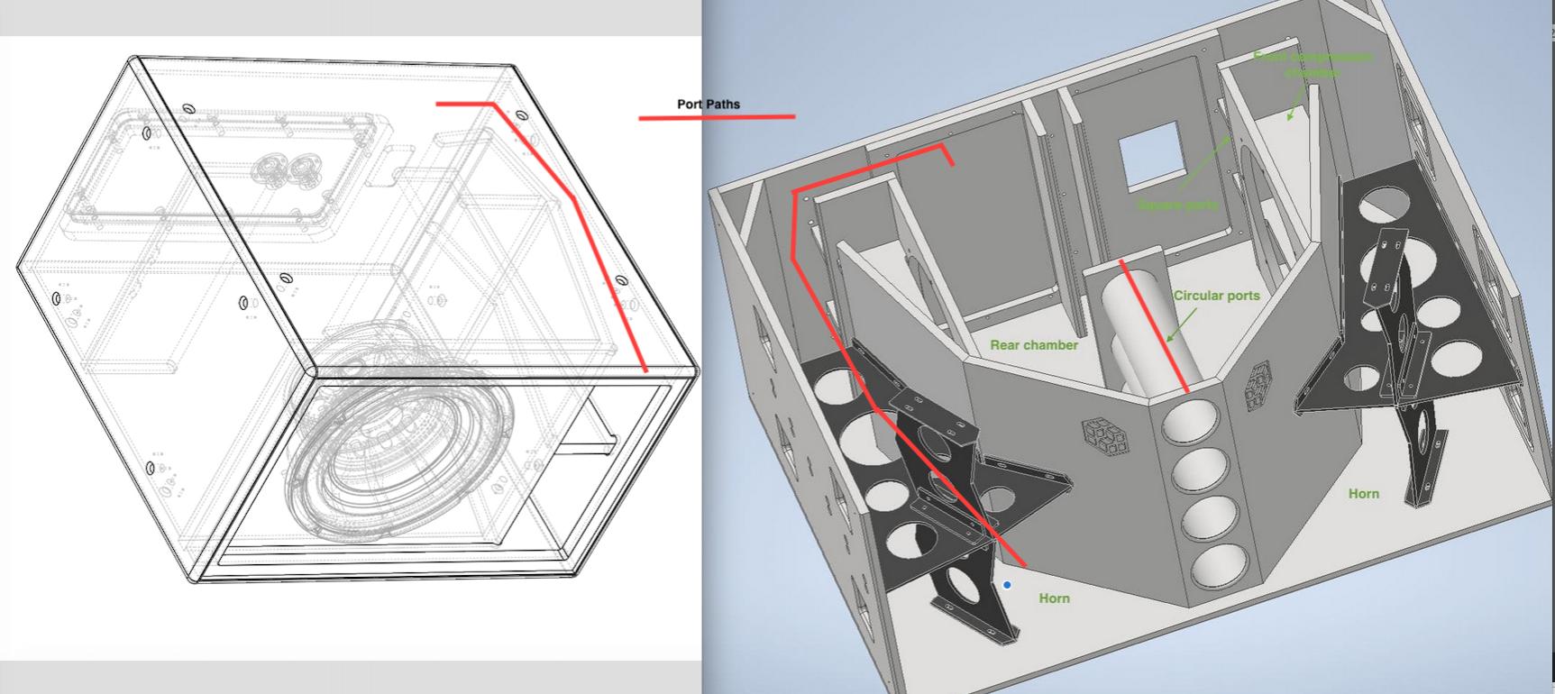

Interesting results. Are you sure the 3D model is accurate in the first post? the ends of the rear ports could be closed making them into a kind of stub.
Repeating myself, the "horn loaded" ports are a lot longer than the circular ports. The longer "ports" alone would result in an Fb lower than 29Hz, the shorter ports alone much higher, mixed together they result in an Fb of 29Hz, assuming your depicted design and previously posted impedance and FR plots are from the design you are simulating.Look at the FR for various front port lengths(100-400 mm). This sim was performed with closed rear ducts.

In the design you are considering, the VTC of the "V" horn coupling may also effectively function as a tuned resonant absorber in the "horn loaded" ports, smoothing response by reducing "pipe resonance".
Lots of interesting stuff Rog Mogale/Void incorporated in this design!
Art

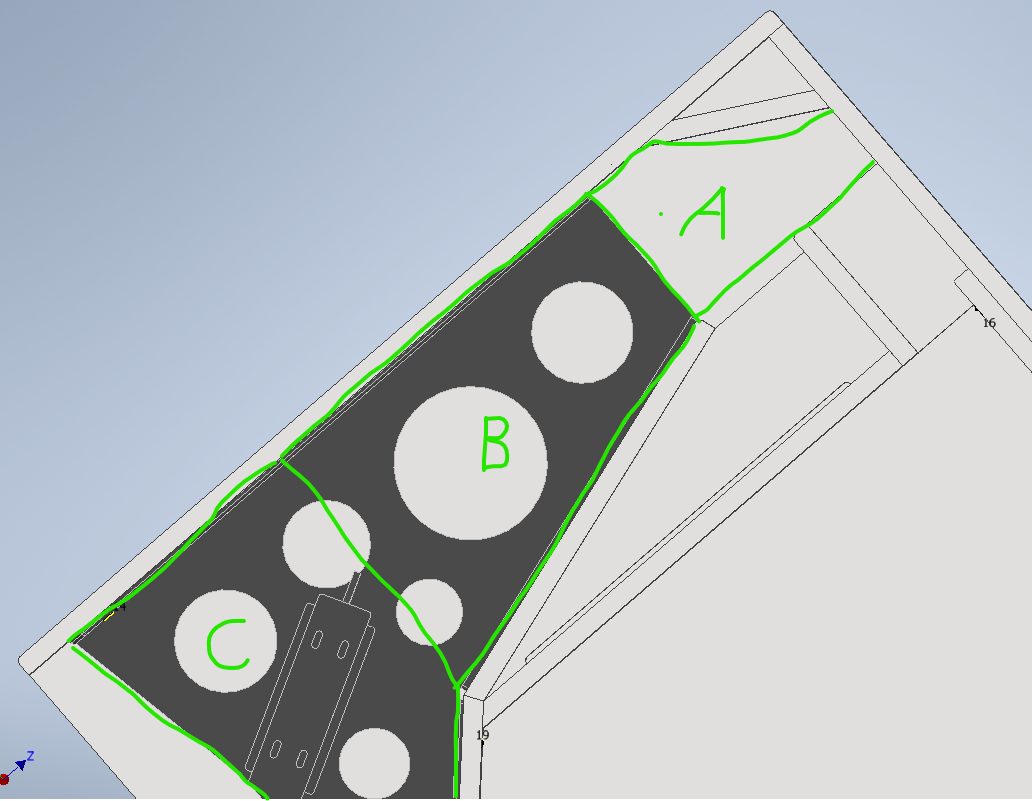

weltersys,

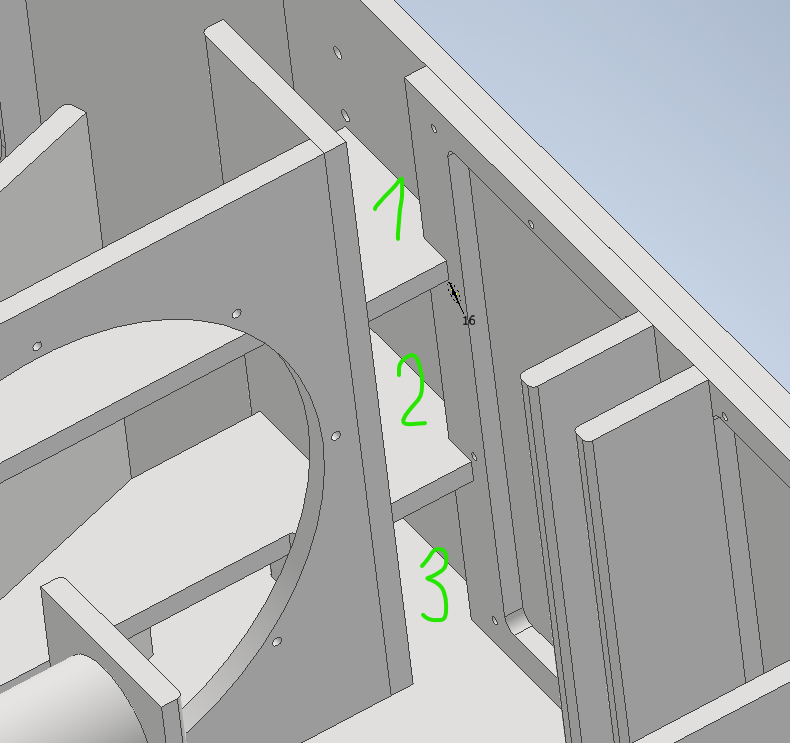

Thanks for the pictures now I understand what you mean by "the rear ports are much longer than the circular ones".

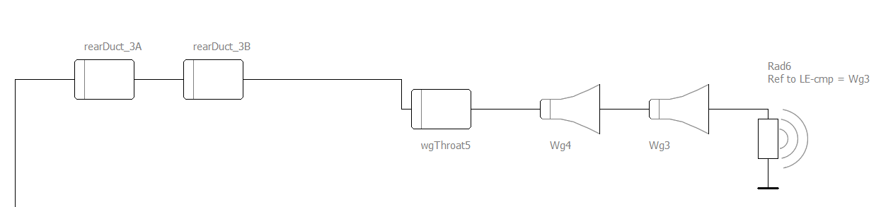

I've been modelling the system in a different way. I consider the rear ports to be just that short 3 ducts along the rear wall. The rest of the path is just folded horn.
1, 2, 3 are the rear ports
A is a duct, B, C are waveguides
The ducts starting at the corner of "1,2,& 3" don't end when turning around the next corner simply because the divider/braces stop there.
"1,2,& 3", and "A, B, C" are all part of the same air column, pipe, duct, port, or horn whatever you want to call it, but a "waveguide" must be large enough to guide waves ;^).
Not familiar with Akabak, but the combined area of "1,2,& 3" section (one length) should be in series with the rest of the horn elements.

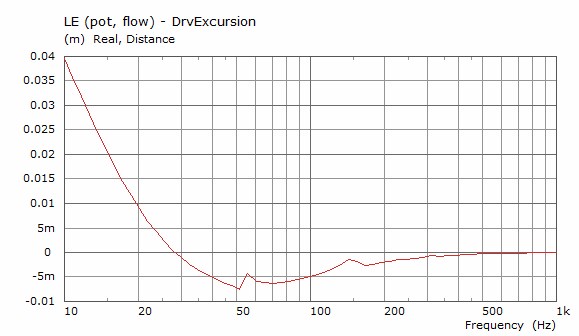

Hi Maple have you tried a full Bem simulation?...
it would be interesting to analyze the propagation behavior of the waves inside the enclosure, i've tried tu set up a comsol simultion years ago whitout luck
some time ago I simulated with akabak starting from the drawings found on the net, there is a behavior in this lem simulations about the resonance at 30 hz that I cannot grasp..
the drawings on the internet will not be perfect, but certainly not to give these differences
