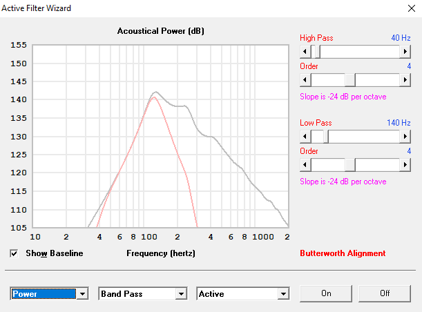

Filters:
LP, Butterworth, n=4, cutoff=140Hz
HP, Butterworth, n=4, cutoff=40Hz
System input power: 6.8kW (134.2V each driver)

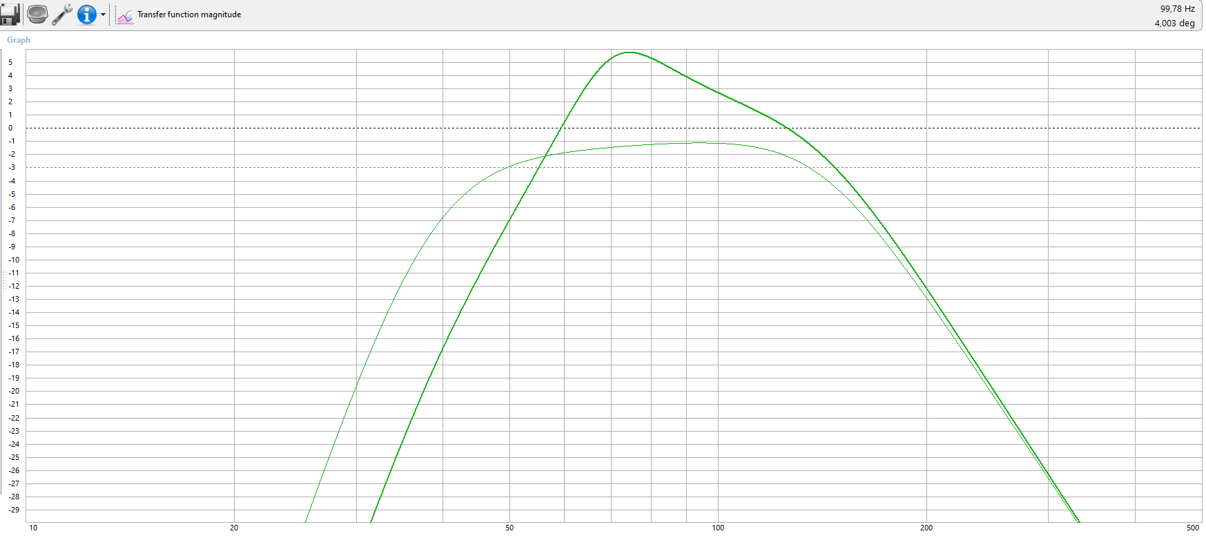

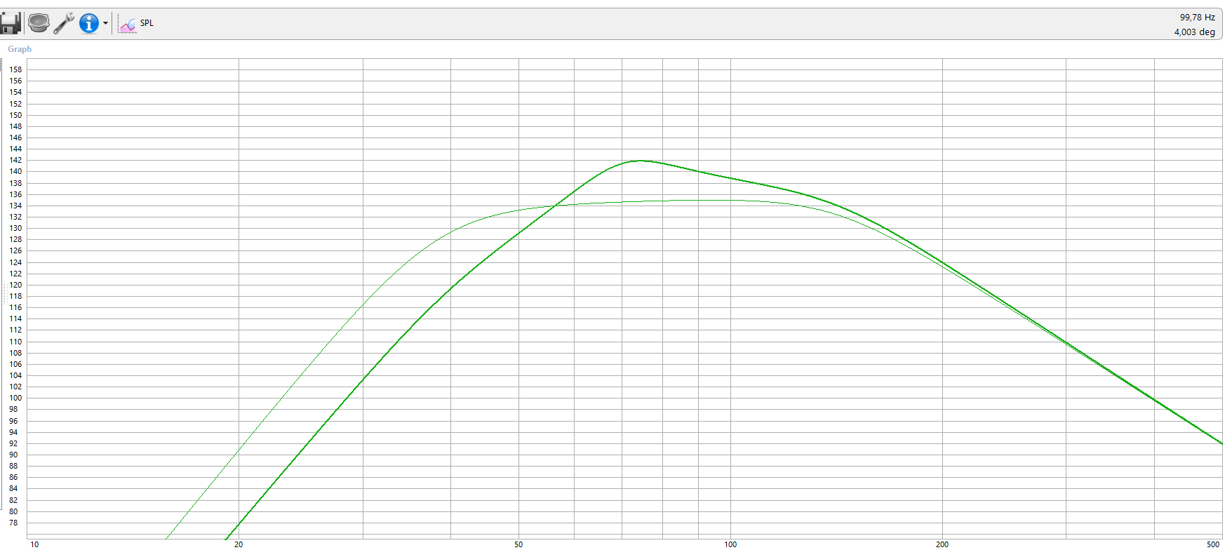

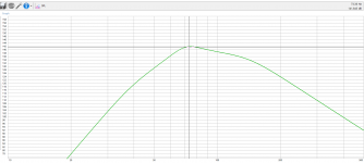

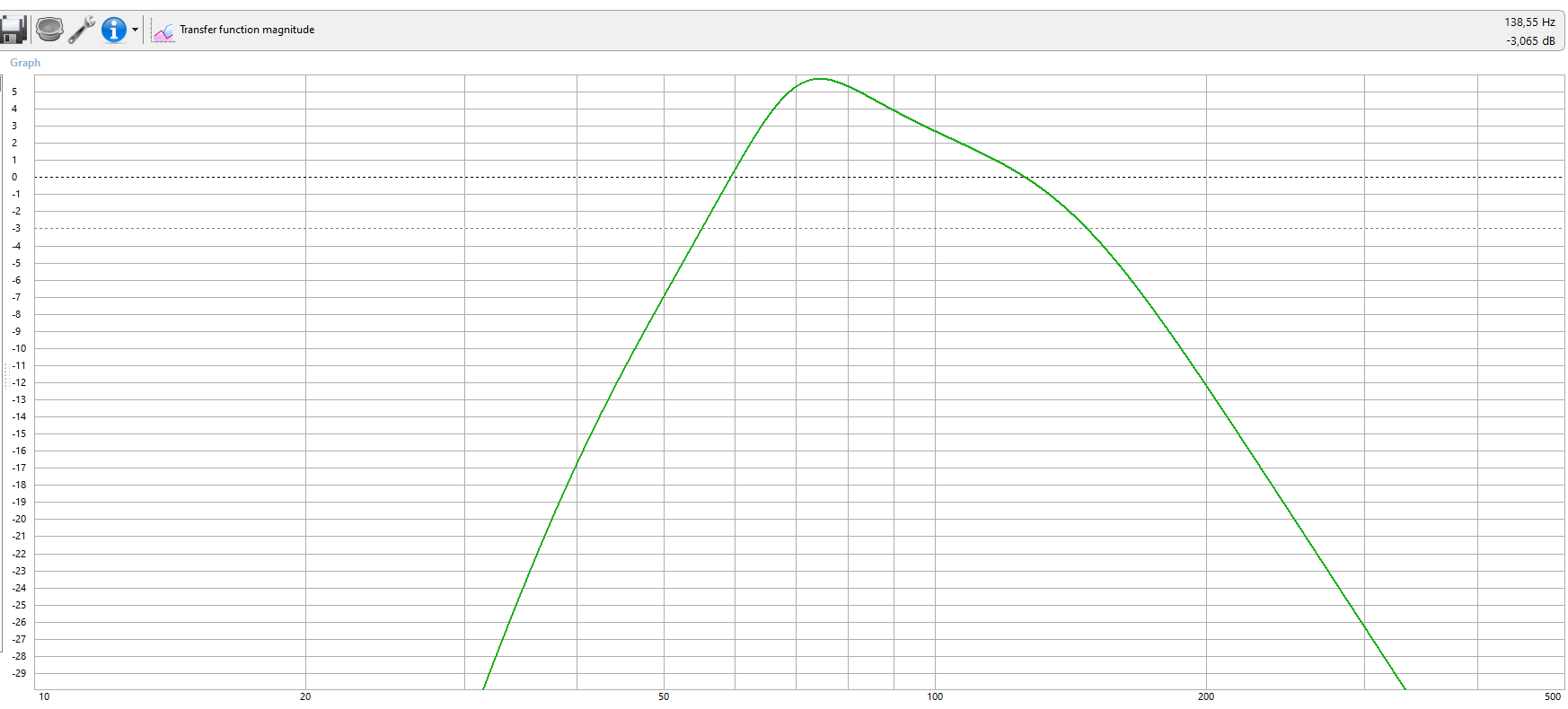

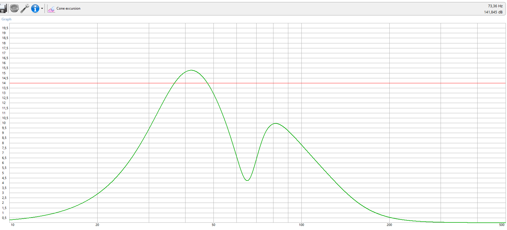

Subpart 1 - circular ports - WinISD
There are four D=101mm circular ports going from the rear chamber.
I modelled the port length and rear chamber tuning frequency in WinISD.
Circular ports
Setup
Tuning freq: 35Hz
Ports: 4x circular L=31.7cm D=10.1cm
WinISD results - transfer function magnitude, SPL, cone excursion

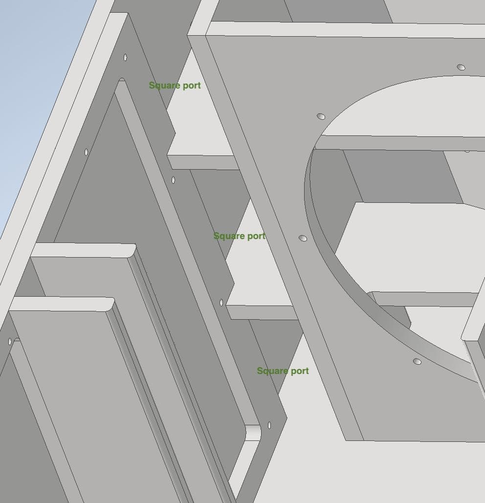

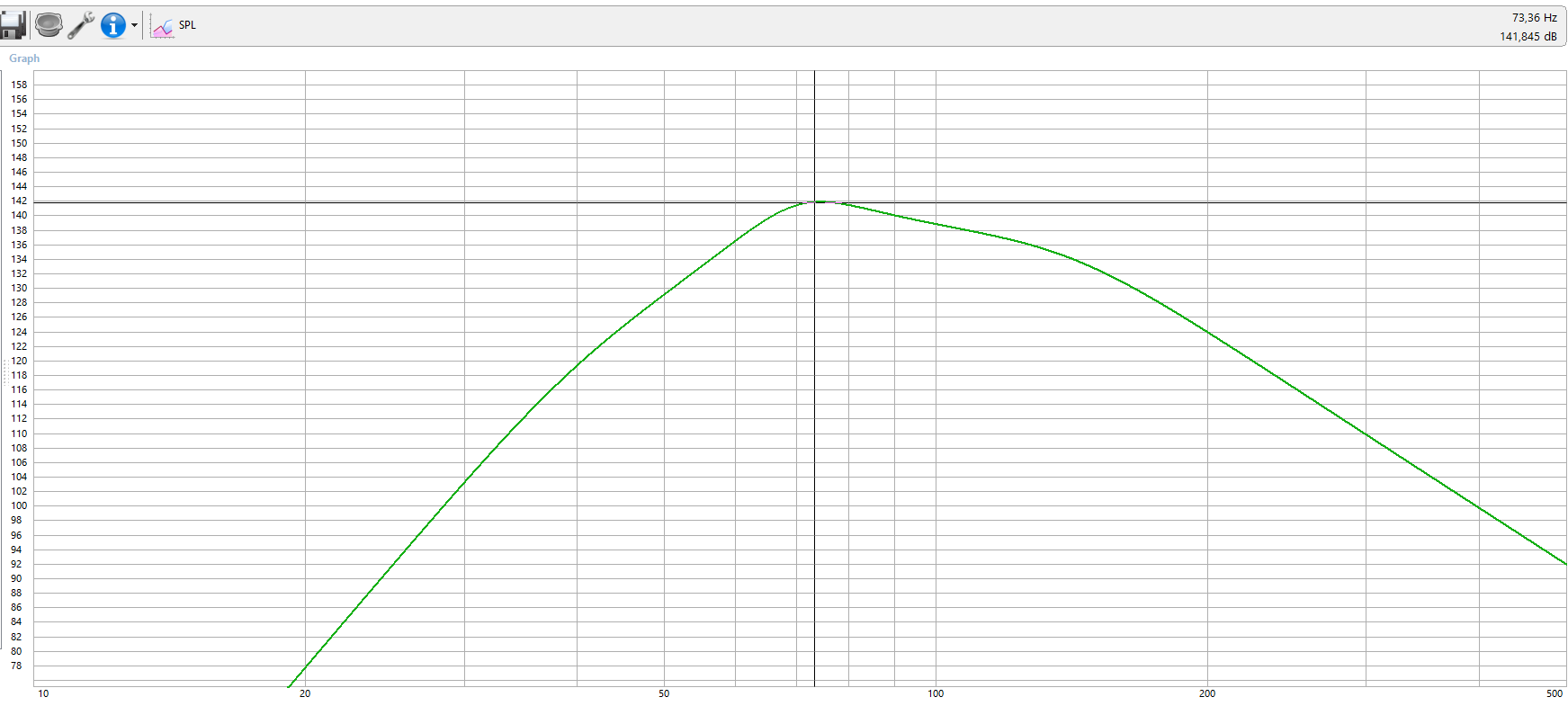

Subpart 2 - square ports - WinISD
Additionally there are six fixed length square ports. Horn coupling at the square port output is neglected for simplification.
Square ports
Setup
Tuning freq: 63.9Hz (can't go lower, length mods not possible)
Ports: 6x square L=15.2cm, 16.4cm x 6.5cm
All ports transfer function magnitude and SPL

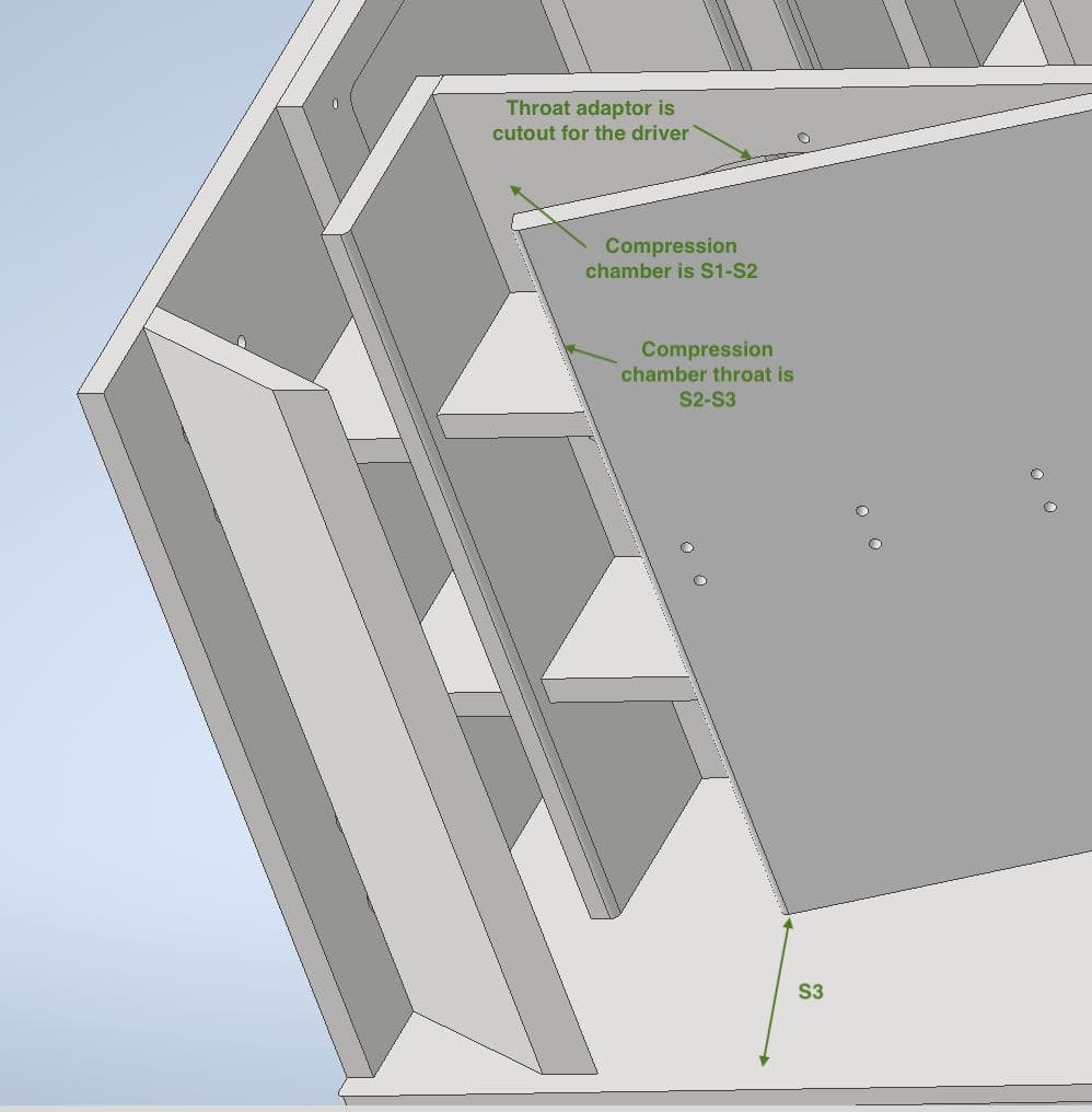

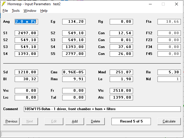

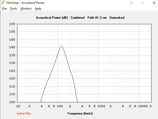

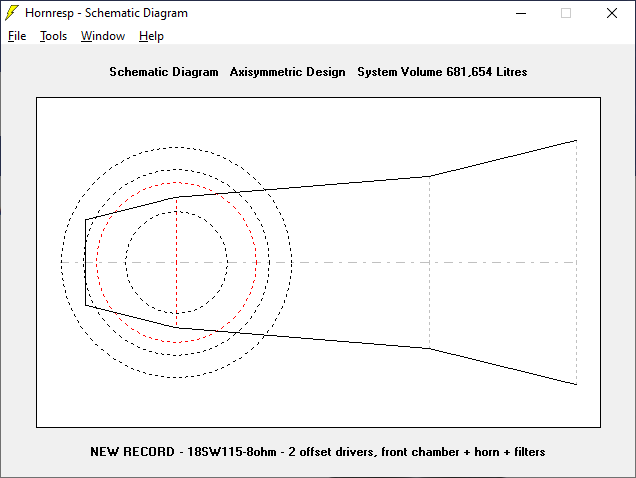

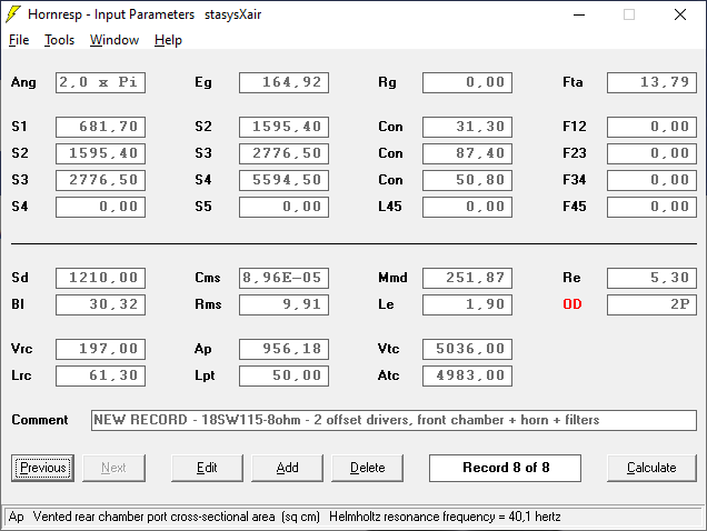

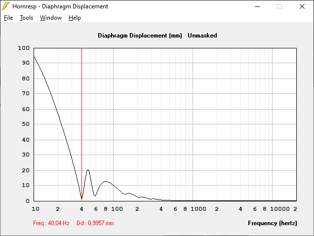

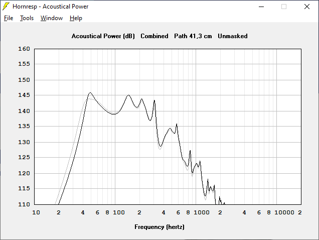

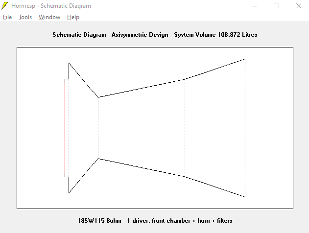

Subpart 3 - front compression chamber and horn - hornresp
This subpart is modelled as a single driver with throat adaptor and 3 segment horn.
Currently only 1 driver is used in simulation.
Hornresp setup and results
Questions

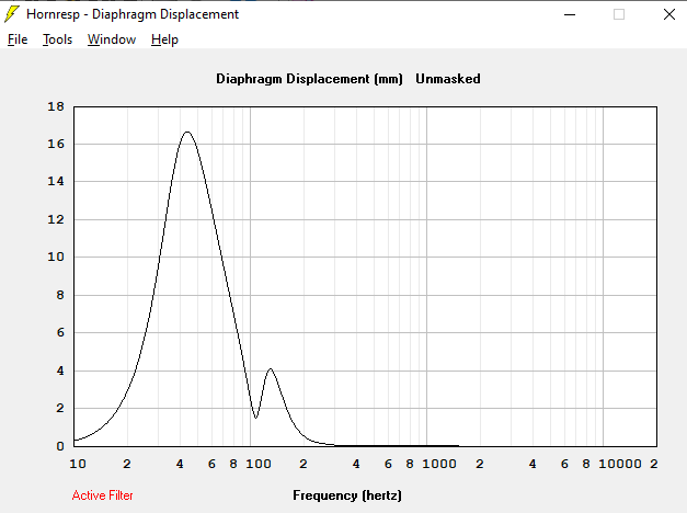

1. Is this proper setup for safe cone excursion?
2. Should I model the acoustic system with driver nominal power handling (1.7kW) or continuous power handling (3.4kW)?
3. Is possible to model multiport cabinets in Hornresp?
4. If I'd add a second driver to the current Hornresp setup. Should I just double all S and L values?
Questions
Just a quick FWIW that WinISD cannot simulate this cabinet as-drawn, and I'm not certain that Hornresp can, either. Probably an Akabak job.
The short rectangular ports joining the rear chamber to the short horn would appear to "short out" the long circular ports, but I'd have to run the sims to make sure.
Chris
Chris

The circular ports and "horn loaded" ports sum to a single Fb, probably around 40 Hz, considering Void suggests a 38 Hz Hi Pass 24 dB/octave crossover point.
It would be interesting to see an actual measurement of the cabinet's frequency response, 30 Hz - 180 Hz ±3 dB seems unlikely, and would be impossible with a 38 Hz HP.
1) The BC18SW115 has an Xvar of 16mm, which would be a "safe" excursion, and usable in simulation.
It's Xlim is 30mm, 60 mm peak-to-peak excursion before damage.
2) Each BC18SW115 will withstand peaks of 6800 watts, but long term power handling in a cabinet of this sort should probably be limited to around half the AES rating of 1700 watts.
3) As far as I know, other than using an aggregate sum of port length and area, no. This design also has the interesting feature of two different port offset distance in relation to the horn mouth.
4) Your Hornresp sim would be more valid using two offset drivers with a ported rear chamber. The cross-sectional areas of both sides of the throat chamber and horn at various points of the horn path should be combined.
The horn throat dimension is ambiguous due to it's proximity to the horn loaded ports.

weltersys,
Do you have an idea what the Lpt parameter should be set to? Average length of all ports? All ports length sum? The longest/shortest port length?4) Your Hornresp sim would be more valid using two offset drivers with a ported rear chamber. The cross-sectional areas of both sides of the throat chamber and horn at various points of the horn path should be combined.
Although you can determine the back chamber volume fairly easily from dimensions, it is impossible to "average" the length or area of ports that are so different in cross sectional area and shape .Do you have an idea what the Lpt parameter should be set to? Average length of all ports? All ports length sum? The longest/shortest port length?
I'd suggest using a Lpt that results in an Fb (Frequency of Box tuning) around 40 Hz, based on Void's suggestion of a 38 Hz Hi Pass 24 dB/octave crossover point, though you could vary the Fb down to 28Hz to compare response.
The impedance and excursion minima will be at the Fb.

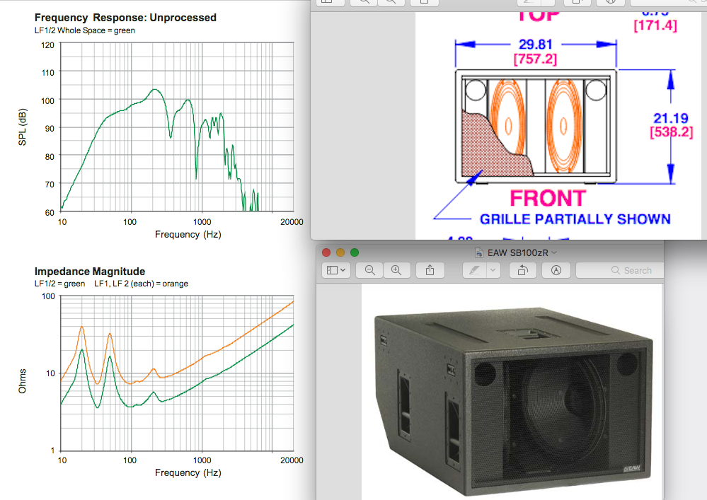

Void Stasys X-Air design shares functional similarities to the dual 18" EAW SB1000zR cabinet. The considerably smaller SB1000zR uses a pair of round ports in addition to a single large rectangular port between the two drivers at the center of the short "V" horn baffles. The combination of the two different port types ends up with a Fb around 32Hz, as can be seen in the Impedance Magnitude minima at that frequency.
Without seeing an impedance measurement of the Void Stasys X-Air, it will be impossible to determine the accuracy of a Hornresp or Akabak simulation.
Art

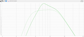

I chose Lpt=50cm which gave me Fb=40.1Hz. Can't go lower because I don't want longer circular ports.

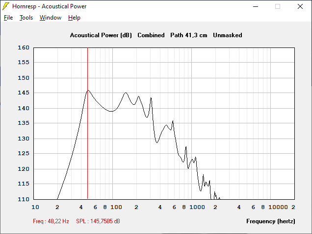

This is what I got without any filters
I also tried to model the sub with 250L rear chamber which slightly flattened the response and "moved" the peak at 49.6Hz@145.8dB to 44.9Hz@143.4dB.
Maybe some sort of rear chamber lining could improve the response. I know this sim is far from perfect so I will try to sim it in Akabak. Prototype of the sub with adjustable circular ports will be complete soon so I will post some measurements later.
Maple,I chose Lpt=50cm which gave me Fb=40.1Hz. Can't go lower because I don't want longer circular ports.
The "horn loaded" ports are ignored in your model, and they are a lot longer than the circular ports in the Void Stasys X-Air design.
Simulating over Xmax/Xvar (16mm) won't translate to reality, as a power increase past Xvar won't linearly increase excursion.

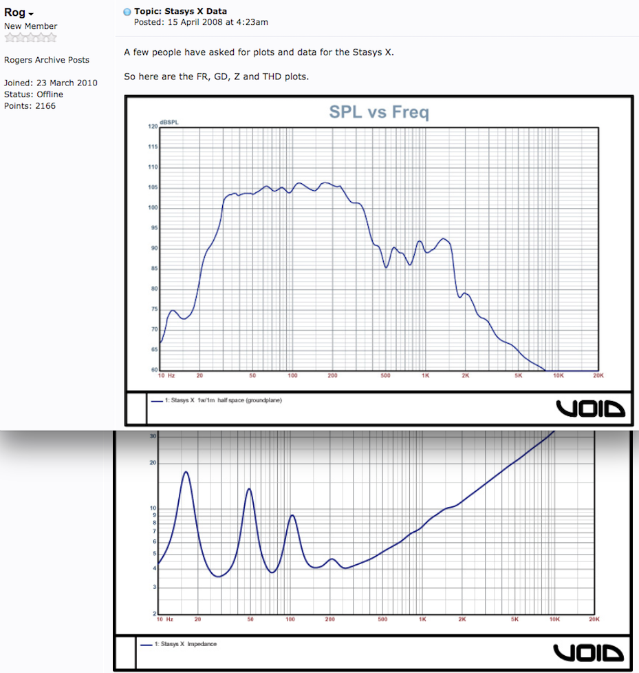

The user guide for the x-air has an impedance plot in it:
https://voidacoustics.com/support/stasys-xair/Stasys_Xair_User_Guide_V1.0.pdf
6th order with fundamental tuning of ~30Hz. Have you considered the IPAL or DS drivers? they may have more output potential.

On the speakerplans forum you can find plots of Stasys X. However i am not sure which version.

The frequency response matches the Stasis X-air published specs, though the 38Hz 24dB crossover in the specs still makes no sense with a 30 Hz low corner.On the speakerplans forum you can find plots of Stasys X. However i am not sure which version.
