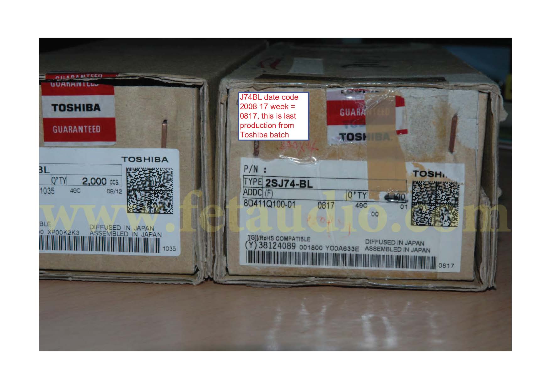

All,
The parts is from me but now all sold out. Here is the box for all your reference. Marking 8D and datecode is 2008 year 17 week.
Someone buy from me and resell. I can tell my hand writing on the bags and also those who buy from me before should be able to tell as I write all the Idss value on the package.

according to Spencer mine are manufactored 2008
so they are obviously born with yellowish offwhite printing
I can tell you, the printing looks sharp, like cut with a lazer
