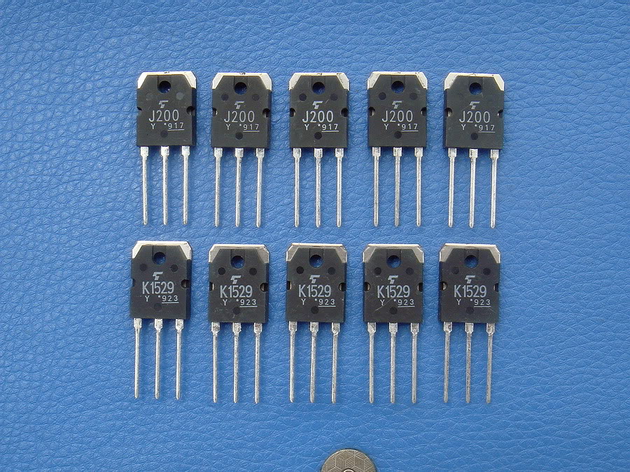

I am attaching photos of genuine parts and fakes.
Yes, those are faked ones. I still remembered the marking. There is no way that K170BL has Idss of 15~20ma. I got them from one of my source and returned.

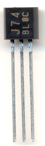

Fake J74
I bought some J74BL from eBay and they measured Idss 11 to 20 ma.
What happens if I use them in a circuit designed for a real J74? Will they work? What are they really?

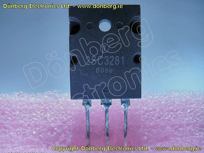

The only feature, that distinguishes the genuine parts and the other is the higher resolution font. No logo isn't to find on both (also by pics from post #25) This means for me, without exact analysing of the parameters it is impossible to make a statement about the quality, reliability and long-term stability.I am attaching photos of genuine parts and fakes.
Or is there a feature by genuine parts as a clear visual distinction, that I have overlooked?
In the attachement various logos from Toshiba (TOKYO SHIBAURA ELECTRIC CO).
Nothing of them I notice on 2SK/2SJ small signal jFET types.

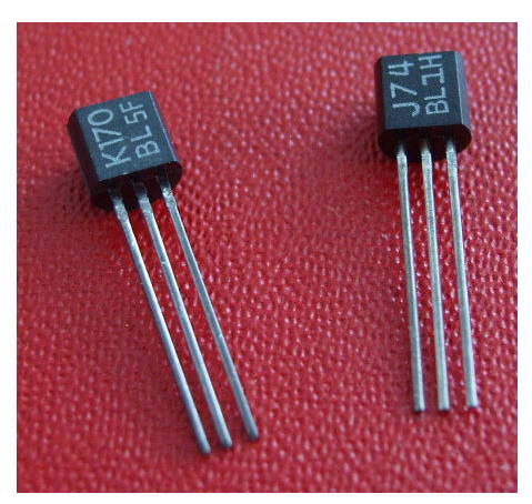

I don't know, I have some real parts (170 and 74) and looks similar, I have some originals with a differences between series.
This is some of my genuine 170 and 74
But this is a genuine part as well (170GR)
