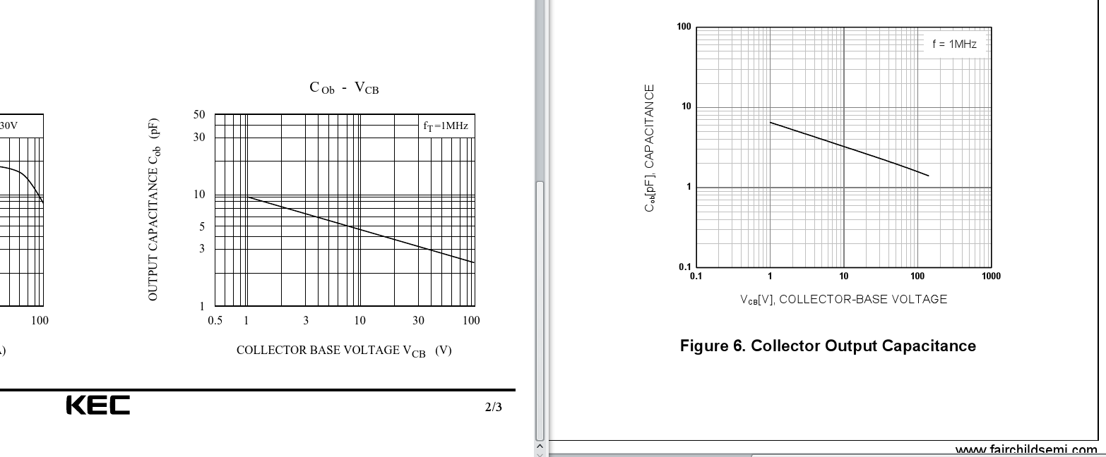

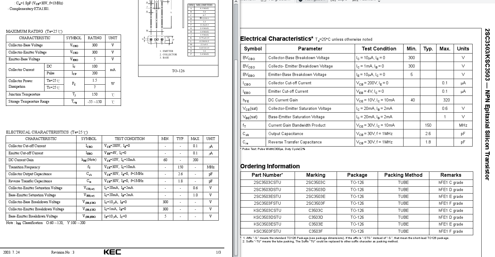

The KTA1381/c3503 show a high Cob of ~4.6pF @ 10Vce
The front page states 2.6pF and 3.1pF @ 30Vce
Something wrong with the datasheet?
And this is higher than a 2sc3503 which is shown as 3.3pF @ 10Vce.

Dear Andrew,
KEC KTC3503 versus fairchildsemis KSC3503 datasheet. see attached picture.

I think there are three Members reporting something similar.
Look at the graph.
That's why I asked if there is a mistake in the datasheet?
Dear Andrew,
you are right. There is a relatively big difference in Cob graph compared to the overall data ...
We need some real parts to compare ... but KEC doesn't answer ...
