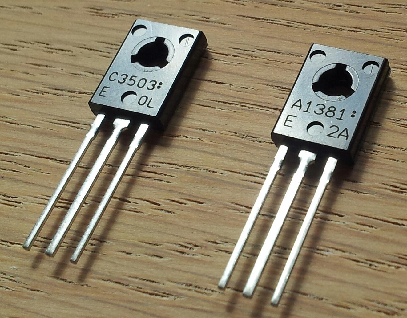

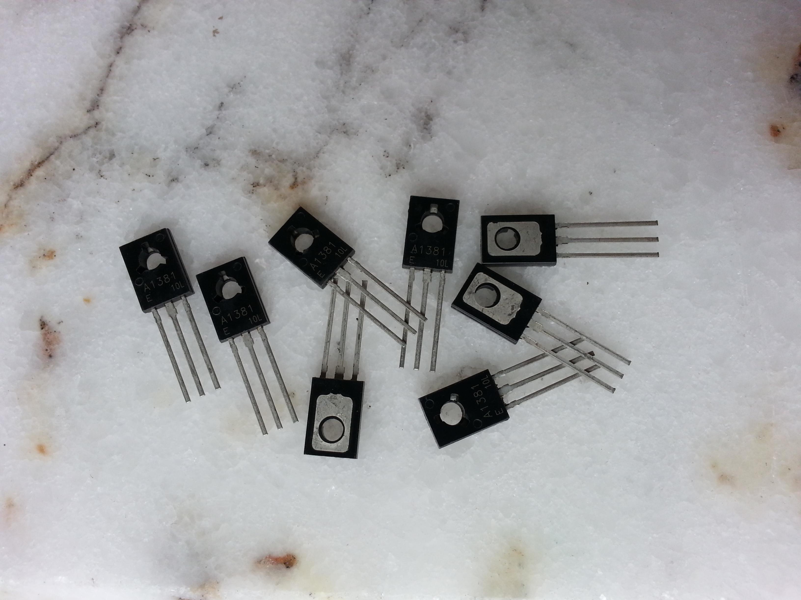

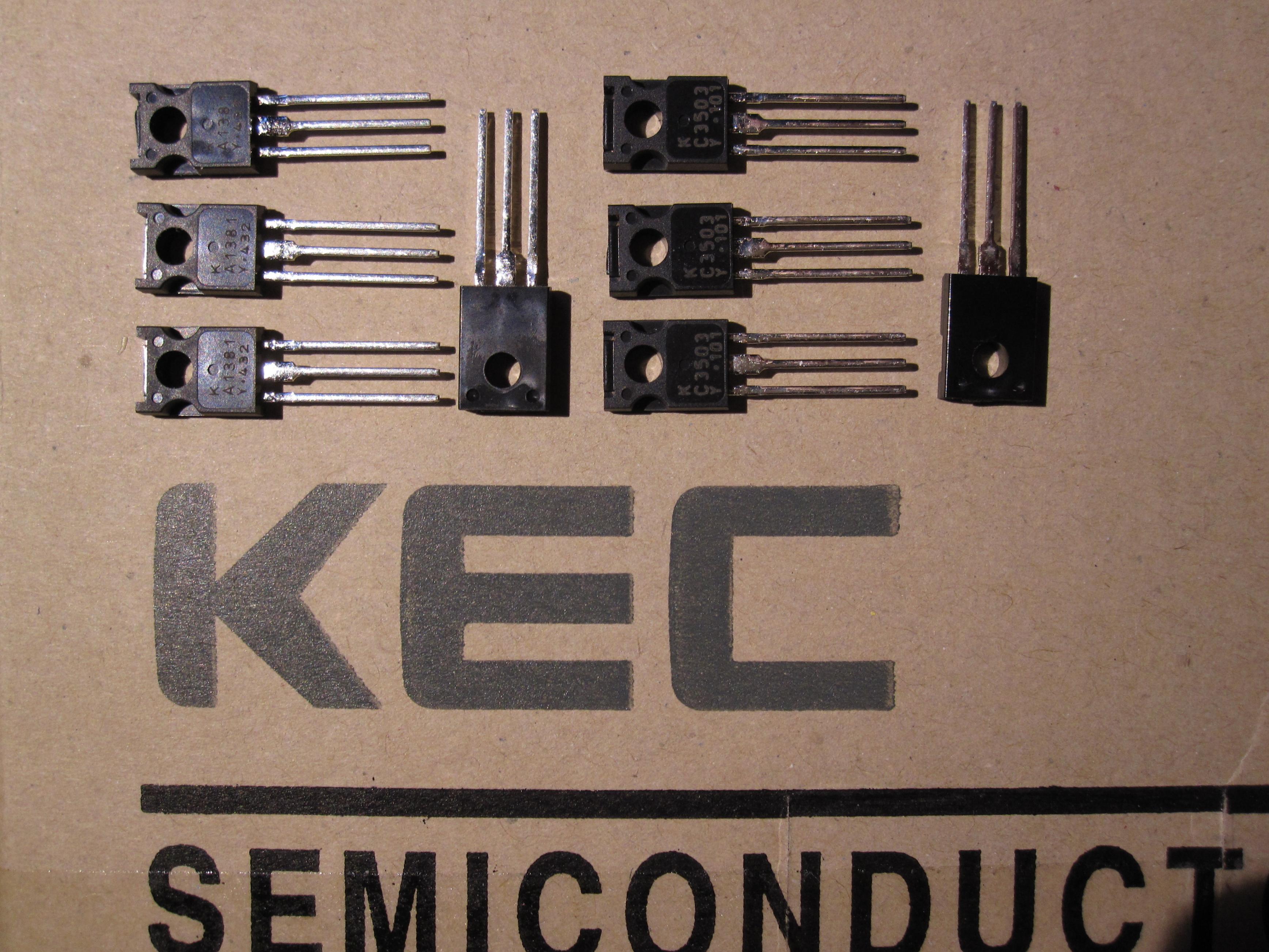

could you please post us high resolution pictures of you KEC devices?
Thx!
BR, Toni
Dear Jacques,
Hi Toni, here they are.
Jacques
Many thanks! This will help us to identify fakes!Hi Toni, here they are.
Jacques
BR, Toni
