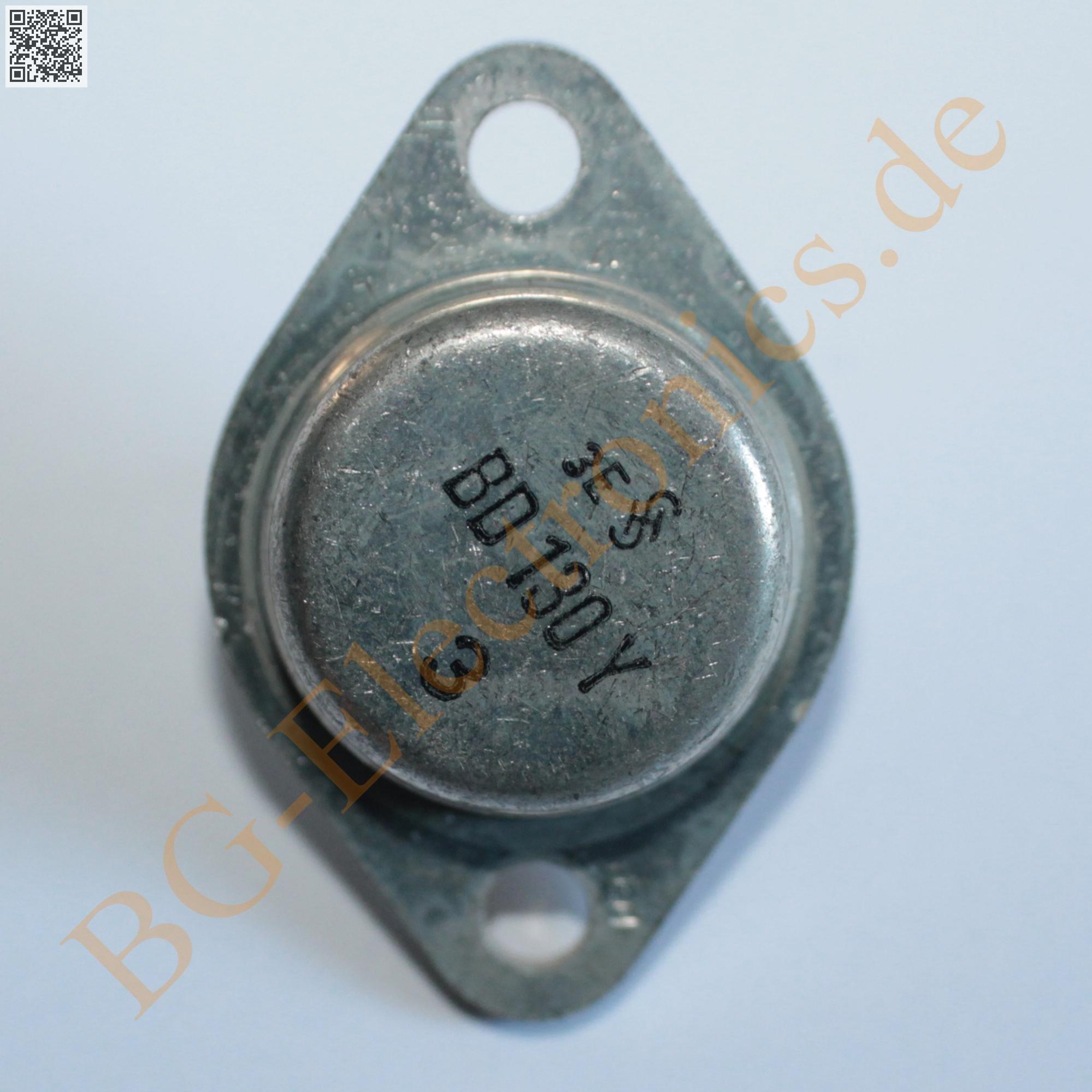

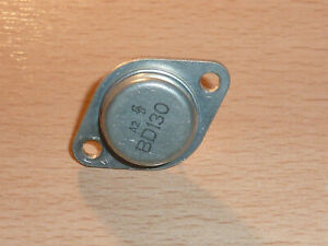

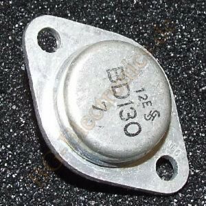

I note, that the German brand Siemens launched the same type under the type number "BD130" in the seventies - unfortunately I don't find original datasheet online:
BD130 Datasheet(PDF) - Comset Semiconductor
Now I have found this datasheet - go to the attachment.

  • BD130 datasheet Siemens databook 1971.pdf

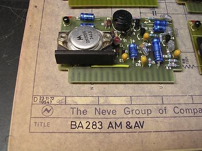

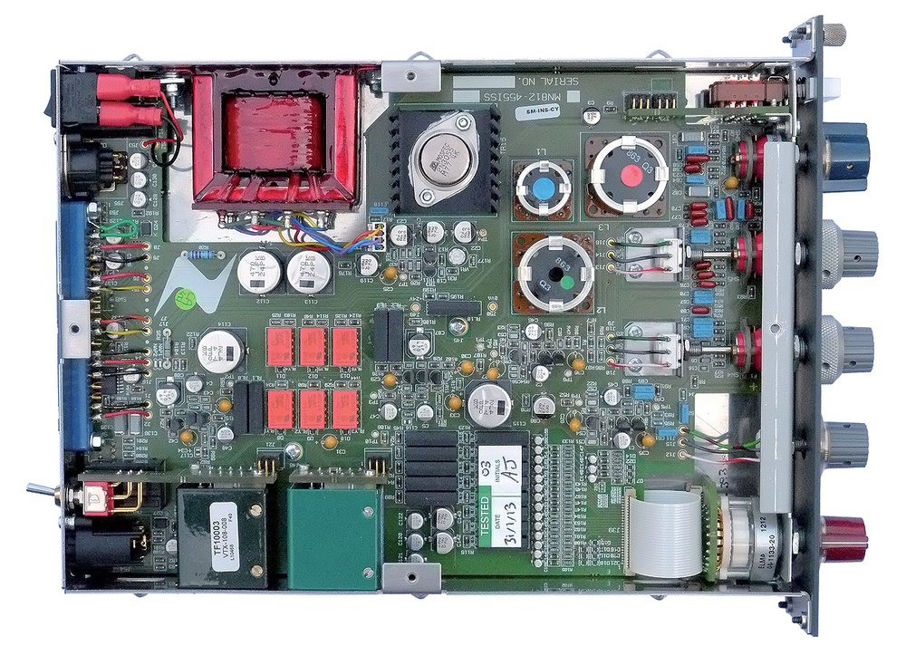

Nobody mentioned the classic Neve pre amps, class A with a 2N3055 in it, still produced nowadays.....
Willem
Very interesting. 2N3055 single ended output stage for a preamp ?
If yes, probably similar sonic character than "ZEN"power amp versions from Nelson Pass.
Are there schematics ?
Find attached the basic schematics for this Neve pre amp.

Very interesting amp - thank you for this advice and especially the schematic.
to find more such amp models (and not such with MJ2955/2N3055 in use by output stage) was the reason for starting this thread
