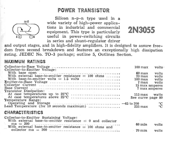

I've pointed out before on these threads that a good 2N3055 built on epitaxial technology should have BVceo >100V. This has to be so in most cases to meet the original BVcbo spec. of 100V. This is not a guarantee that ALL manufacturers' 2N3055's will meet this spec, but all of the ST and ON Semi devices I have had seem to. Though ST have obsoleted their 2N3055 now.
Consider what the 3055 was competing against when it was introduced. It was a big deal. Now it's a so-what-who-cares. You can get a 100 volt breakdown (and full dissipation capability to 40 volts) in pretty much any modern epitaxial power transistor - without even trying.

DJK- the original 2N3055, now long gone, only managed 70V with Rb of 100ohms. The epi 3055's will do 100V. What we don't get to see is the second breakdown over 60V, the original BVceo. It is very likely to be built on an epi line where all the transistors have BVceo over 100V, and modern ring emitter devices may have BVceo of 250V, which is also pretty irrelevant as many amps only need them to have good s/b at voltages up to say 120v, except for those who want lots more power...
