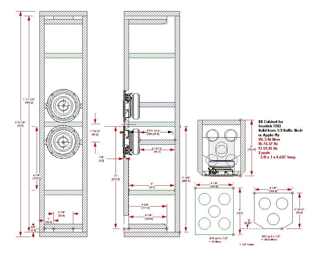

Why not 2 drivers in one cabinet?
I bought 4 FE83s to build at least one pair of speakers for my office (paired with an open box LP-2020 snared cheap).
I found this thread and am inspired to try Mr. Smith's uFonkens for more reasons than because they can be thrown together out of scrap in a weekend.
But I am led to wonder how to go about putting two FE83s in one enclosure.
Does anyone have any words of wisdom on that subject?
Tnx,
--jm
Easiest way to do it (conceptually) is take 2 cabinets flip one on top of the other, remove the tops so you have one volume and mount the drivers as close as possible.

will it be stereo?, 2 channels output with speakers close together?
Not stereo with two drivers in one enclosure but two speakers (stereo) each with two drivers (in parallel -- I will experiment) for increased cone area (although I am fuzzy on the theory here).
Based on Dave's suggestion, I will sketch something up (even though I don't have Vectorworks installed yet 😉).

Lash up of the double:
Smaller Advent - try a single first, I think you'll be amazed... unless you're needing to power a house party, that little driver is quite capable. Best of luck, and know that the uFonken is A) too small for this driver and B) not my design! Thank the team at Planet10, chiefly Dave, who suggested this double alignment.

Wow, you're very fast with VW.
As it's been a couple of decades since I built myself any audio equipment (been busy with other stuff), I'll take your advice and try the single stack first. And just so I'm clear, it's your sketch of the FE83 BassReflex that I intend to build, not the uFonken (which is notably smaller). I have a spot for these in my office and it's not on my desk. And I do like the beveled edges in the front.
This just occurred to me: I have a bunch of 3/4" cabinet-grade birch ply, which would be considerably stiffer than 1/2" birch ply (which I might have too, I'd need to look). If I adjust the interior volume, do I need both interior brace/stiffeners? I understand the one that supports the magnet assembly may be necessary regardless, but I just thought I'd ask.
Thanks for the coaching.

JM -
I don't know which graphic you're referring to as this little cabinet has been evolving since the beginning of this thread. Build the double stack, with the 4 1/8" port shelf, but cut the sides so that you can turn the middle divider into a full width top. By experimenting with room loading, you'll be amazed at the bass that comes out of this little driver & box. At moderate volumes you can listen to it all day long (I have trouble walking away from it when there's compelling material coming through it), and at higher volumes a little more distance keeps the inevitable 3" shout at bay (like 6'+). Air and detail are wonderful. Pianos, guitars, voices, etc. are delicious, and percussion of all sorts is sublime. Definitely a jazz - optimized setup, so long as its not overproduced & smeared with audio enhancements and mic eq indulgences.
Have a ball!
