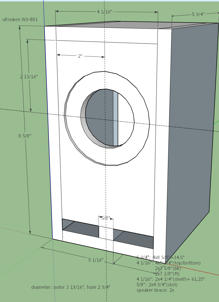

<2L cabinet volume for this 3" Fountek FE83 fullrange
I am looking to build a small PC type of speaker for family member, mainly nearfield listening using a chip amp (TDA7297) in a small room.
it will be a small group jazz and vocal mainly using these speakers from PE. Can someone suggest a dimensions? One of my favorites micro-Fonken need different vent size...

I would just dial the figures into WinISD and see what it recomends for a sealed box. Nice thing is sealed boxes are not so specification critical.
Having a look at the graphs, 2L sealed is near enough optimum (Q = 0.76)
I think you could comfortably get away with a 1L sealed box. (Q = 0.87)

Sreten, please don't project your own experiences on others. It can be done, and the Fountek speakers mentioned are a reasonable starting point.
However, they don't go very low, and they have a break up peak which makes running them full range difficult. For a project like this under 2 liter, I would recommend the Aura NS3 or the comparable Dayton speaker, both for sale at PE. Make it a simple 2 way, and you can get something better than what you recommend. However, it takes a serious effort and it won't be easy, but hey, it's diy.
gychang, I've been playing with a pair of FE83's and I thought I'd share what has happened so far: I through together a lash-up cabinet from some thick, finger jointed wine boxes I had, with 1/2" russian birch ply front and back, and a thin slot port at the bottom. They sound iffy up close, but when I set them up in away from the desk, they blew me away. I've been building speakers for years, but these brought musicians into the room (Thomas Dybdahl "Something Real" has percussion tracks (bottles and glasses?) that are startlingly real. So I set about building the suggested .08, ported enclosure, tuned it with a slot port to 90 Hz. All the magic went away. The wine boxes are .095 cu ft, the slot ports are 1/4" tall, the width of the interior of the wine box (4 3/8") and around 2 1/4" long (don't remember and it's too thin to get a tape in). They ended up being tuned to around 75 Hz. A light stuffing of fiberglass in the bottom half, lined the back behind the driver with rubbery, 1/2" packing foam. Super simple, super live and detailed.

Hi Sreten
I agree, I've heard some very impressive commercial desktop systems, and have one from Swan/Hi-Vi. They're extremely competent. But what just happened, mostly by accident, with the FE83's (for $6.90/driver I hasten to add) is astonishing. I've been playing with expensive drivers and getting good at competent for a long time, I have a pretty good reference point, and the full-range, 3", cheap Fountek is opening dimensionality and details in my music that are light years more interesting and subtle than merely competent. All full-range, single driver speakers are flawed... and my little speakers are very flawed. But I've never had so much information about how a piece of music is produced available to my ears: how 3D space is constructed with varying amounts and types of reverb/decay, how delivately layers of mixes are put together, and tracks that have accidental, natural sounds like a shuffling page or a bumped music stand or something dropped -- come across so alive that I can't help but check that there isn't someone unexpected in the room. I've switched over to my 2020-based T amp (a modified Lepai), and the level of detail got nothing short of spooky. I'll take flawed magic over competency any day.
Wow, that's cool. Not having seen those, I just yesterday ordered a pair of Peerless SDS-135F25CP08-08, 5 1/4" subs, to build something like these! Thanks, I'll absorb their ideas. I do happen to be a furniture maker, so stack-laminating isn't a particular challenge...
Hi gychang
Firstly, I'm no expert. BUT after the wine-box cabinets were so pleasant, I made the PE suggested size (.08), properly. Braced, built tightly, stuffed lightly, tuned port to 95 Hz. They sounded like a telephone. The wine boxes are a little bigger and tuned a little lower, .095 cu ft and tuned to 85. They aren't quite right for a desktop, because they don't sound as good from really close - you need to be 5' away for them to sound really good. That said, if you add an inch of height you'll be close to my internal volume. Do you know what the uFonken cabinet you found is tuned to? i'm curious to try other cabinets for these, though really excited to build a W5 clone with my PE Buyout Peerless mini subs!

TO those interested in what to do with this driver - the uFonken works and works well, but is too small. Dave Dugen of Planet10 suggested the driver needs more than double the volume, but with the uFonken, shrinking the two ports by growing the port divider from 5/8" to 66 mm (just less than 1 5/8"), and experimenting with closed-cell foam in the ports to dampen a resulting peak at around 150. I've done so, and it sounds quite good... depending on room placement you may or may not need to stuff the port. So far, however, the winning alignment I've found is a well-braced, felt-lined, sealed cabinet of 3.8 liters (.134 sq ft). Open, controlled, delightful.
