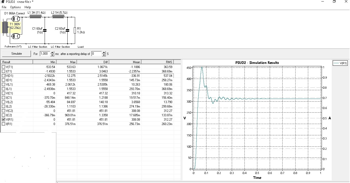

All rectifier tubes have a minimum Rt (total plate supply resistance per plate) which is specified in tube datasheets. Rt= Rs+n*n*Rp, Rs= DC resistance of secondary winding, n= transformer voltage step-up ratio, Rp= DC resistance of primary winding.
If Rt it is lower than datasheet specification it is the risk of sparks inside the rectifier tube and damage it
Suppose you have a capacitor input filter.
Suppose we have a first filter = 10 uF capacitor, 50 Hz power mains, and full wave rectification (4 diode bridge; or center tap and 2 diodes).
Full wave rectification charges that capacitor at a 100 Hz rate.
Xc = 1/(2 x pi x F x C)
F = 100 Hz
C = 10 uF
Xc = 159 Ohms (Xc = 133 Ohms if the power mains is 60 Hz [120 Hz charge rate to the 10 uF cap]).
100 times a second the rectifier is trying to charge 159 Ohms.
(You can do a similar thing, lift a 300 pound set of weights 1 time / second for 10 seconds).
The DCR of the power transformer primary times (the secondary voltage/primary voltage), and the DCR of the power transformer secondary, and the rectifier impedance limit the transient charging current.
If the rectifier is a tube, the transient current may be more than the maximum peak current rating of the rectifier tube . . . Ouch!
An additional resistor in series with the tube rectifier helps to limit the peak charging current.

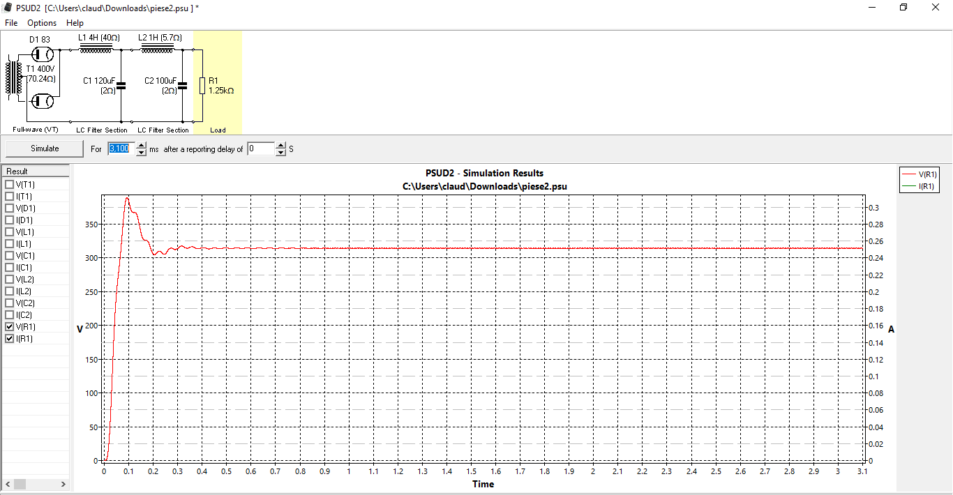

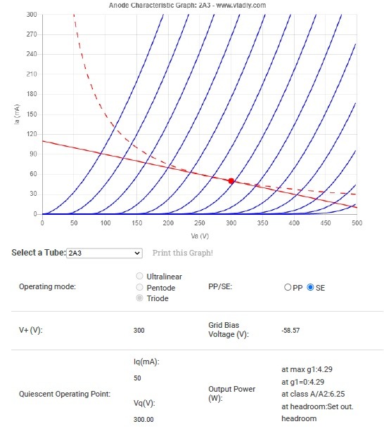

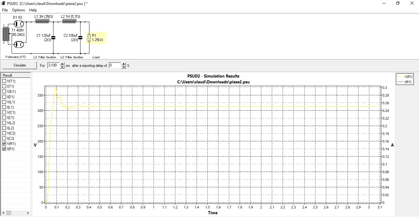

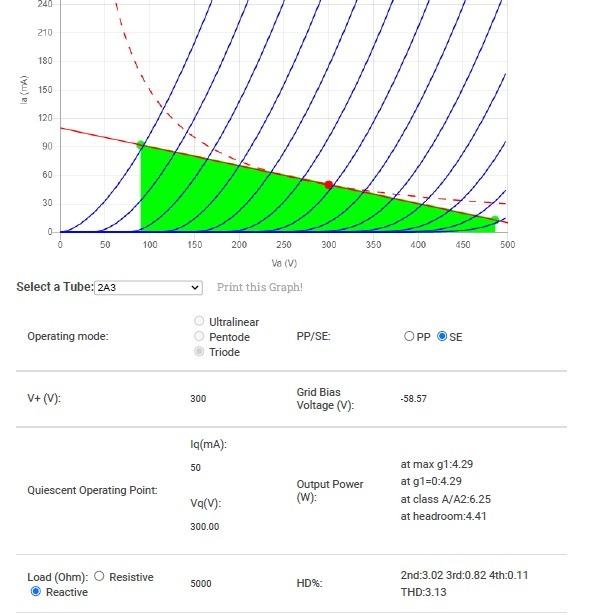

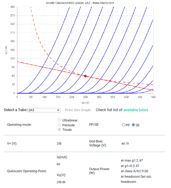

Meanwhile I've done some math. First I chose plate load 5k (because I have two Hammond 1627SEA). Second two operation points for 2A3; 250V, 60mA and 300V 50 mA (both with a Pa of 15 watts). With the help of vtadiy.com (https://www.vtadiy.com/loadline-calculators/vacuum-tubes-available-in-the-loadline-calculator/) I drew load line for both operation points, also I got grid bias -44V respectively -58.5V. Then I used all this data and the formulas published in RCA RC-12 and RC-15 to compute output power and 2nd harmonic distortion
Results:
1) for 250V, 60mA and -44V: P= 2.5W per tube and 1.61% 2nd harmonic distortion
2) for 300V, 50mA and -58.5V: P= 4.025W per tube and 3.4% 2nd harmonic distortion
Please note that vtadiy.com compute a 2.45W for first situation and 4.29W for second one.
Because it is a SE parallel total output power it is double but for 2nd harmonic distortion which is the value?
