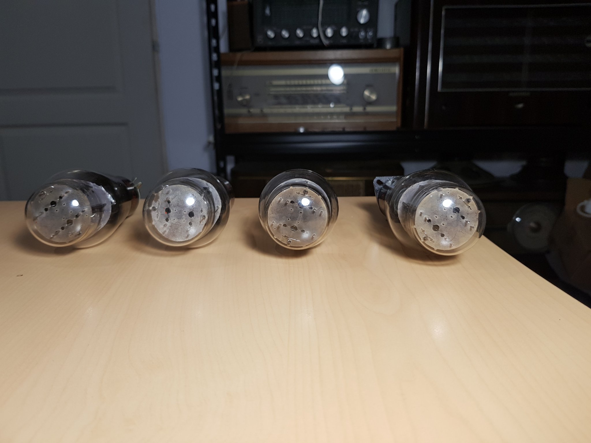

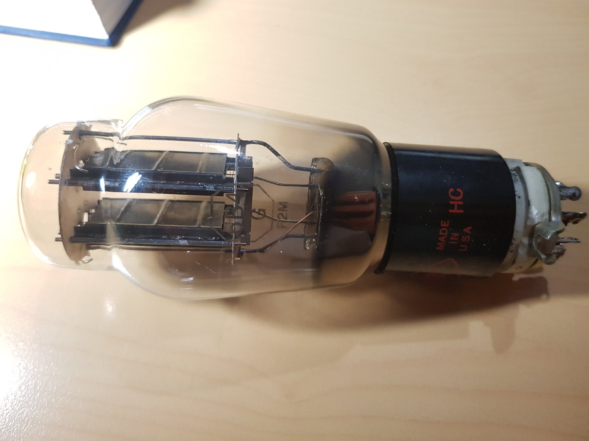

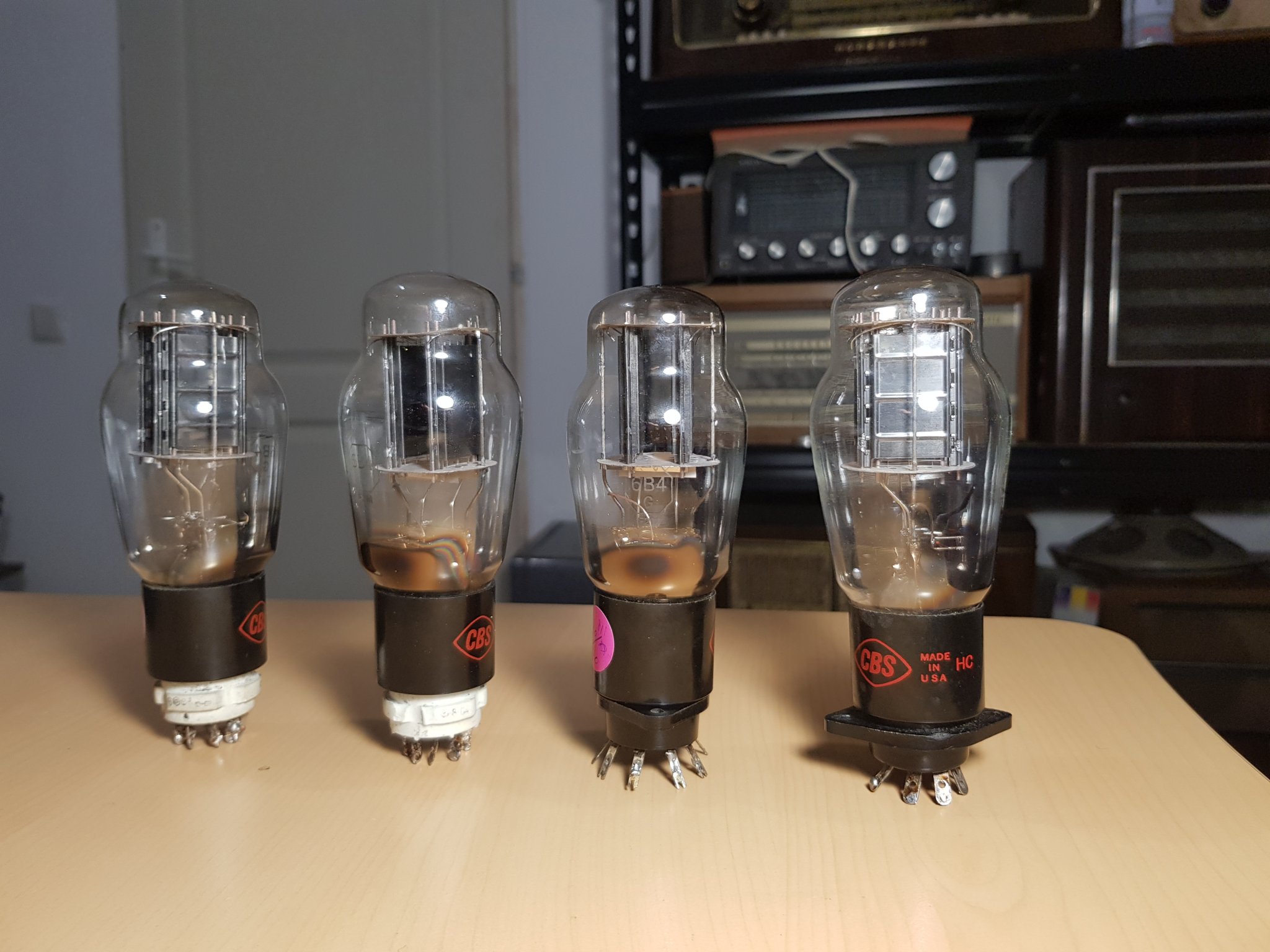

Mine are 6B4G classical dual plate. In theory they are two type 45 tube wired in parallel in the same glass bulb

Finaly at home. Ia values measured on a Veb Weida W18n 72mA/72mA/74mA/75mA. May be it is a better idea with fixed bias
