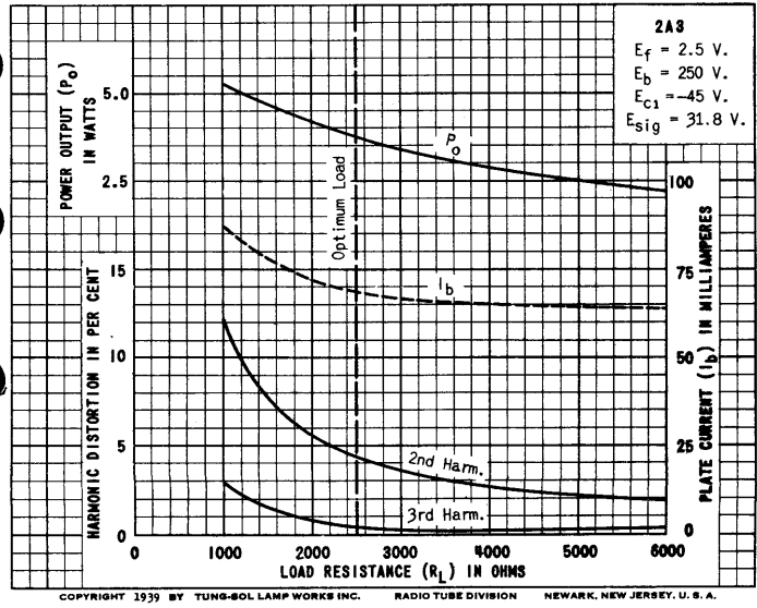

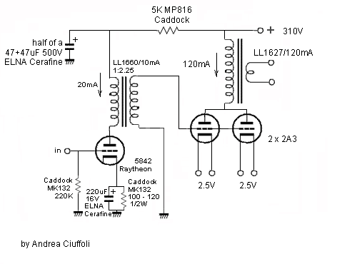

Meanwhile I've done some math. First I chose plate load 5k (because I have two Hammond 1627SEA). Second two operation points for 2A3; 250V, 60mA and 300V 50 mA (both with a Pa of 15 watts). With the help of vtadiy.com (https://www.vtadiy.com/loadline-calculators/vacuum-tubes-available-in-the-loadline-calculator/) I drew load line for both operation points, also I got grid bias -44V respectively -58.5V. Then I used all this data and the formulas published in RCA RC-12 and RC-15 to compute output power and 2nd harmonic distortion
Results:
1) for 250V, 60mA and -44V: P= 2.5W per tube and 1.61% 2nd harmonic distortion
2) for 300V, 50mA and -58.5V: P= 4.025W per tube and 3.4% 2nd harmonic distortion
Please note that vtadiy.com compute a 2.45W for first situation and 4.29W for second one.
Because it is a SE parallel total output power it is double but for 2nd harmonic distortion which is the value?

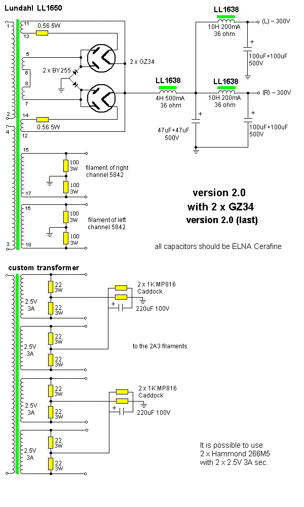

Reading " Vacuum tune rectifiers by A. Shure", "RCA Radio Designers Handbook 4th Ed", "Power Supply Design for Vacuum Tube Amplifiers by Matt Renaud" I concluded that choosing the type of rectification like capacitor input filter, choke input filter, low DCR, low ripple depend mostly by the Class amplification, in Class A you can use what do you want but in Class AB or B it is strongly recommended to use choke input filter with low impedance vacuum tube.
So 6A3sUMMER your amplifiers what Class they are?
I used to build Single Ended amplifiers.
All SE amplifiers are Class A
Now all my amplifiers are push pull, self inverting push pull, or balanced.
Some are Class A, and some are Class AB.
Only one of my amplifiers B+ uses a capacitor input filter.
I am going to modify that amplifier, and then all of my amplifiers will be choke input.
