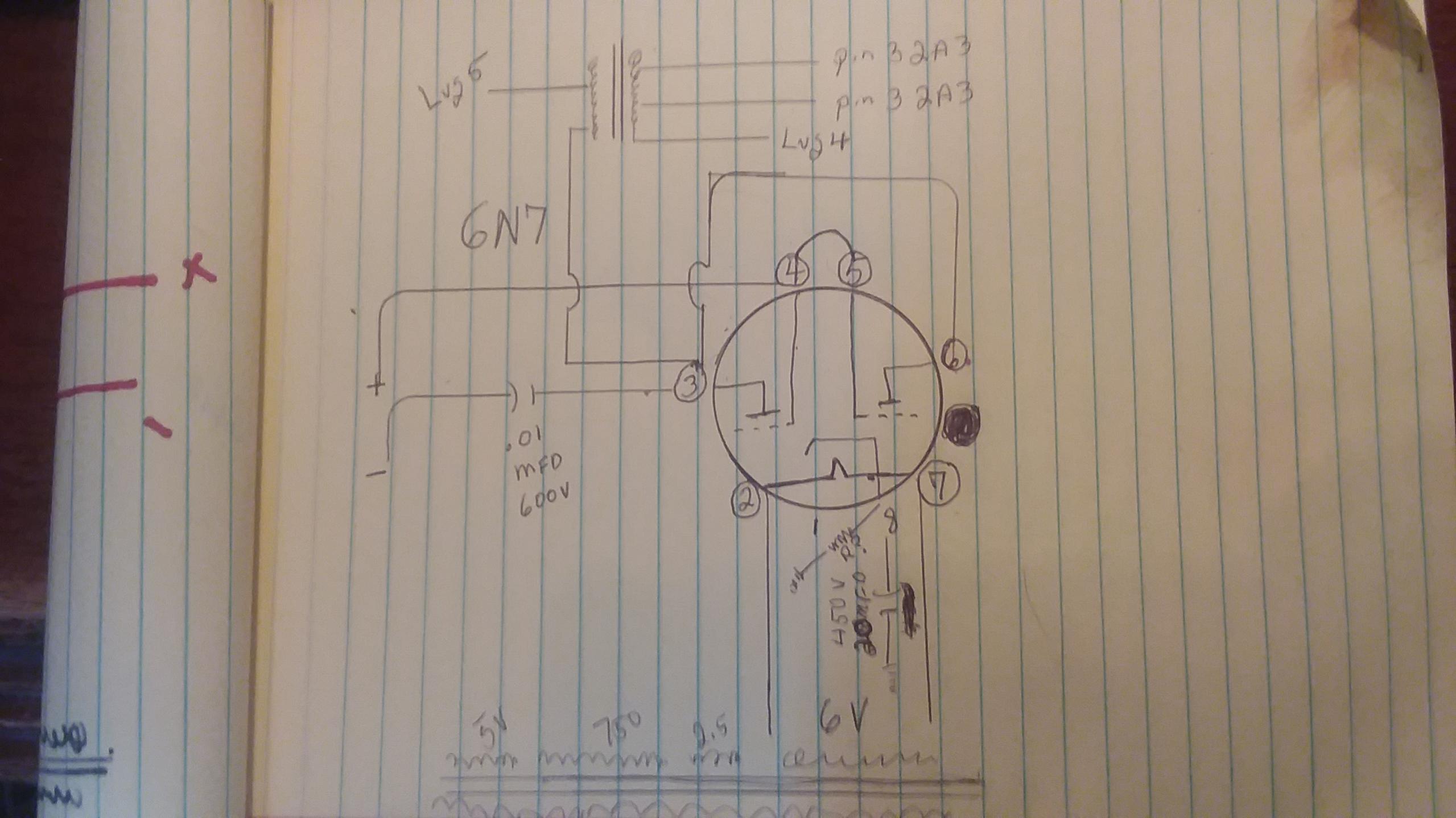

The 6n7 wiring:
+ input goes to pin 4 and is jumped to pin 5
The grids
- input goes to pin 3 and jumped to pin 6
The plates
6 volt from power transformer to pins 2 and 7
The heater
Pin 8 has a small resistor to ground and an 20mfd 450v capacitor to ground.
Pin 3 goes to a transformer that also has leads going to pin 3 (grids) of both 2A3 tubes.
Two other leads off of this transformer go to wiring lugs with resistors and caps that I haven't deciphered yet.
This would be a transformer coupled amp?

yup. This transformer has a double function. First it couples the driver to the next stages. Next it turns a complete audio signal in two halves of opposite phase. Each 2A3 takes care of one phase while the output transformer blends the two phases together for driving the loudspeaker.

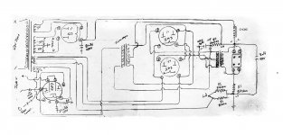

Disco, and anyone else following along,
I"m drawing up a schematic and realized that the interstage transformer has 3 secondary wires. 2 go to the grids of each 2A3 tube (pin 3) and the 3rd wire goes back into the circuitry. I tested +/- 16 Volts across the two wires going to the 2A3 grids and 8 volts from each one to the center tap.

Correct the following post # 39 schematic:
1. The center tap of the interstage secondary is connected to B+
And
The center tap of the output primary is connected to Ground.
Swap those connections.
2. Ground one end of the output transformer secondary. Safety first.
3. Your input circuit needs fixing. It is not clearly drawn. Re-draw it.
A. You do not connect a - (negative) signal input to the 6N7 Plate(s).
The negative input needs to be connected to the ground.
B. You need a resistor from the + (positive) signal grid input to ground.
And
