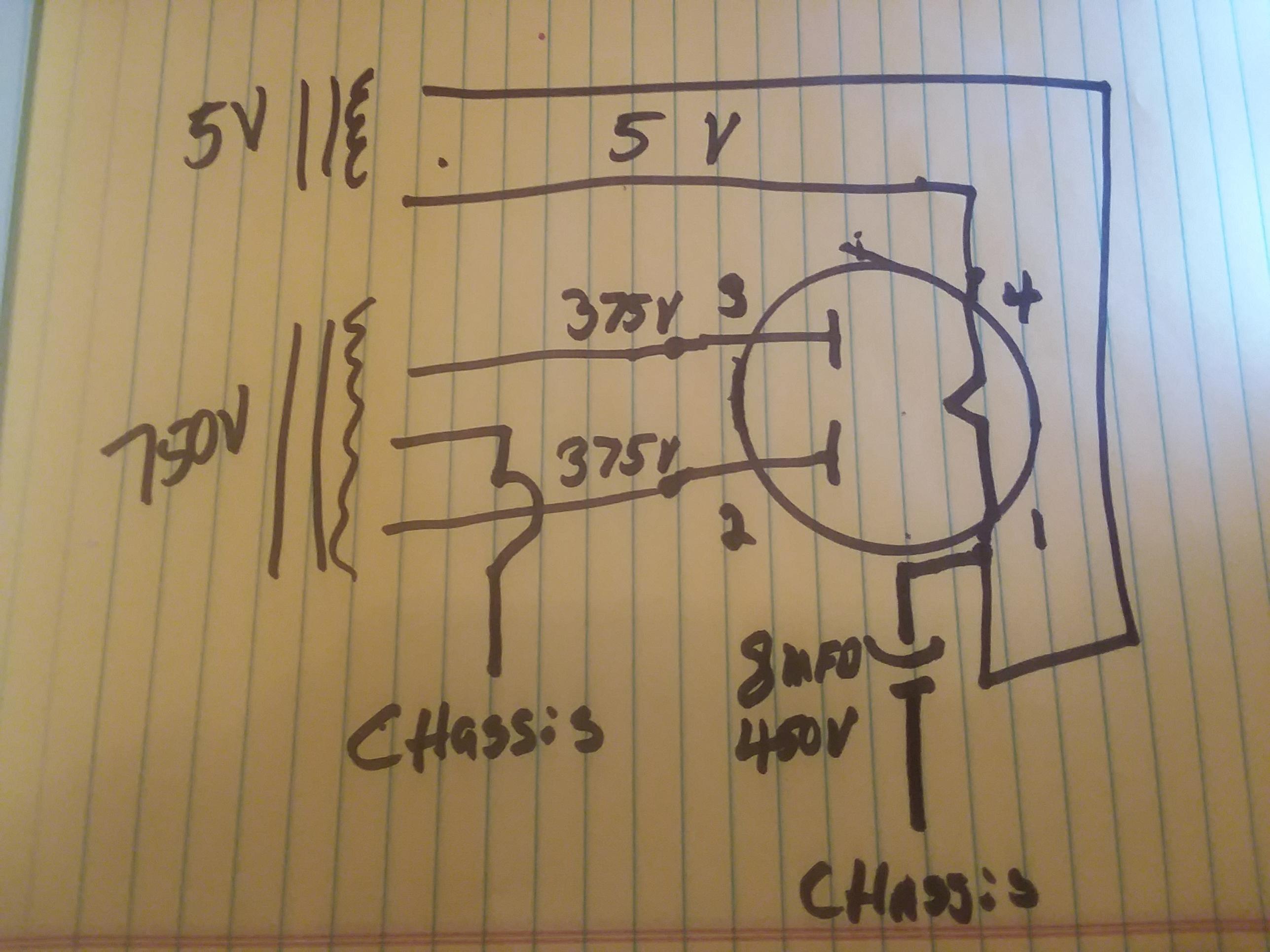

I think I have made these corrections , still not sure what's going on with my input situation.
Whoever made this home-brew amp must have had a signal source that connected a resistor across the plug from the signal source, which then connected to the input jack. That signal source resistor gives a DC return from the grids of the 6N7 to the bottom of the 6N7 self bias network (resistor and bypass cap) from the 6N7 cathode to ground.
Grids do not want to be floating, and do not want to be connected to the outside world without a DC return.
It appears that the input jack is grounded to the amp chassis.
The shield wire does not appear to be connected at the jack end; instead it is likely connected to the chassis at the far end of the shield, or other point that is also grounded to the chassis through a 3rd wire.
If you are going to use this amp with different signal sources, some of them will not provide a DC return for the 6N7 grids. You need to connect a single 100k resistor from the 6N7 parallel grids to the bottom of the 6N7 Self bias network (which is at ground).
It seems that the 0.01 capacitor that connects from the 6N7 parallel plates is connected to the tone control resistor (reostat?), with the other end of that resistor to ground. That is a variable high frequency tone control. Draw in the tone control (from the 0.01 cap to ground).
Or, the 0.01 cap connects directly to ground (fixed tone control).
Which one of those is how that part of the circuit traces out?

Since you have experience with and like this circuit can you shed any light on the input wiring?
6A3sUMMER is concerned about that part of the circuit.
There were Voice of Music turntables (VM).
I believe that Voice of America (VOA) refers to Radio Transmitters out side the US that are operated by the US.
VM turntables usually had Crystal or Ceramic phono cartridges.
The grid resistor to ground was probably 1 Meg to 10 Meg Ohm to preserve the bass frequencies from the Crystal or Ceramic cartridge, that would have been lost with a low resistance such as 100k Ohms.
When you use the amplifier with other signal sources, you need a grid resistor to ground.
You might use 100k, or up to 500k, depending on the input tube.
The post you photographed looks like it is connected to ground. Might be for connecting to the turntable chassis to reduce hum.
Careful, if it is connected to pin 3 plate, there is voltage there.

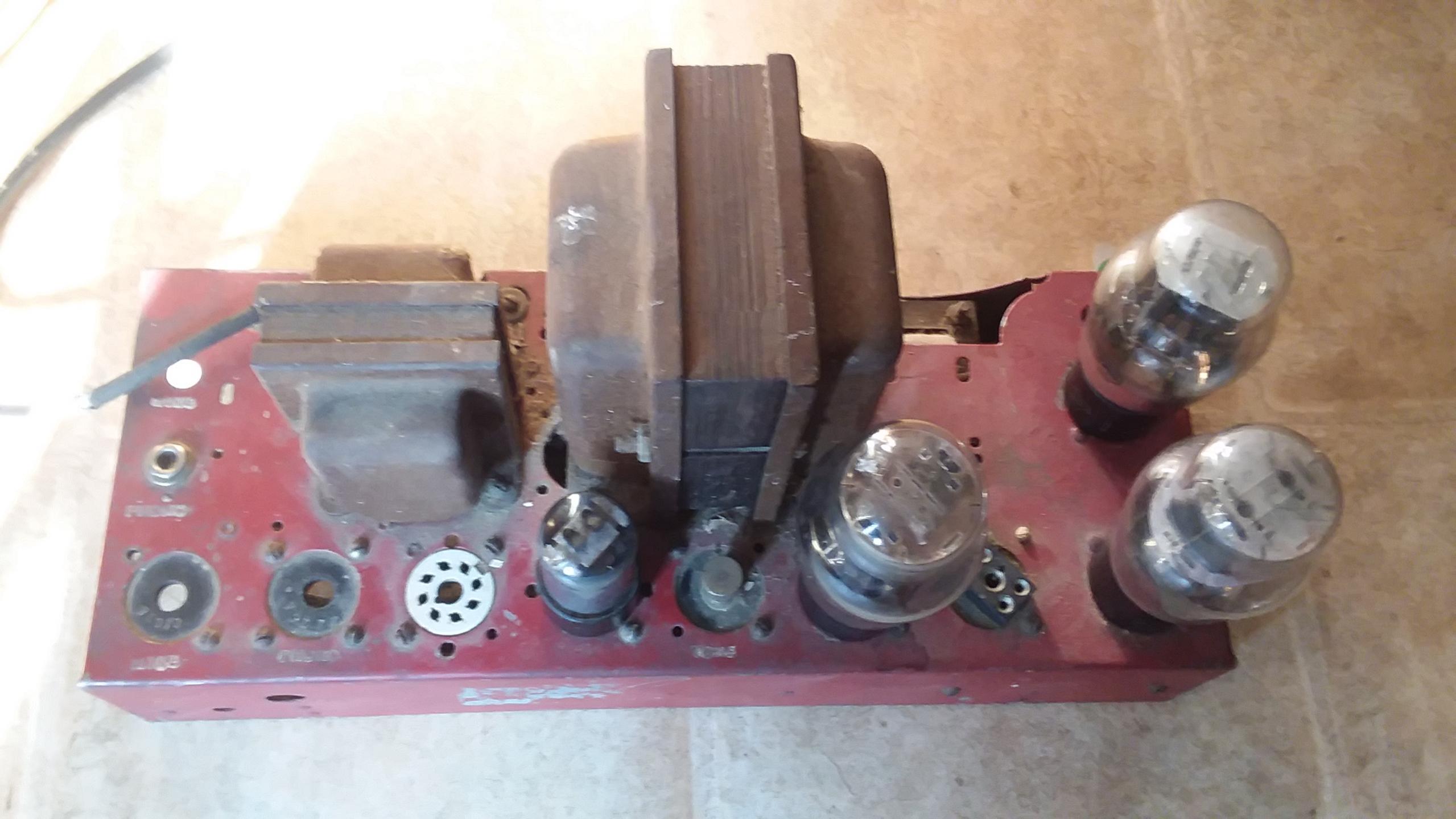

Just wanted let anybody that has been following along or offered advice know that things are moving forward.
Transformer wires were cracked and very short so I have extended them and put shrink wrap over the exposed wires. Much was learned about soldering doing this.
I've also replaced all but one of the capacitors. the last one is a 20MFD that I will replace with 2 10MFD in paralell.
A note to any other beginner that may stumble across this thread.
I just happened to have this old homebrew amp so it was a good place for me to start. It has forced me to dig in deep and I have learned a lot, but I would start with an amp or DIY kit with documentation.
Paul
