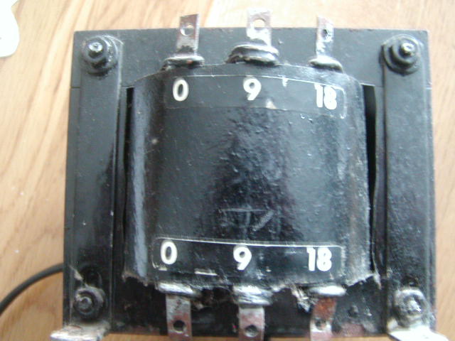

I have two big 9-0-9 10A transformers also for the filament supply.
So..... Grid bias or filament bias? Some here say filament and some say grid. Naturally the expensive power transformers will deliver superior performance but at a price. The output transformer has got to be spot on in performance as well as a nice input control.

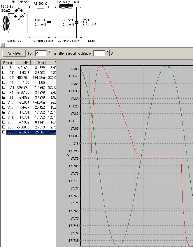

If you have 9-0-9V 10A trafos, then you can make the perfect raw dc for Filament Bias, with only a very modest cost.
The attached PSUD2 grab shows the 9-0-9 series connected, feeding a quasi-choke-input supply. The Choke is a Hammond 159ZE or similar (28mH, 430mR dc, 3A rated. The 15000uF C2 only sees a ripple of 300mA rms, so any variety should work perfectly under such low stress. C1 should be Panasonic FC or similar quality high ripple handling: 2x 220uF 35V.
The quasi-choke-input configuration means lower impulse current through the trafo-rectifier- and this supply will deliver 17 -18Vdc: perfect raw dc for Filament Bias using my regulator kits. They are self assembly kits, so the price is low. You can click my name to send some email - I have PDF manuals and App Notes on getting best sound through better filament heating.

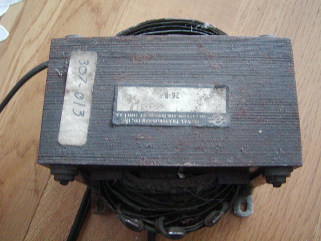

Looked up the specs on the transformer 36vct @ 8A in series or 18vct@ 16A in parallel. Will this work ok?
As 18V CT, it will be perfect for the PSUD2 example, shown above. If the dc voltage comes up above 18V under load, just reduce C1 a touch (eg 220uF + 100uF parallel).
