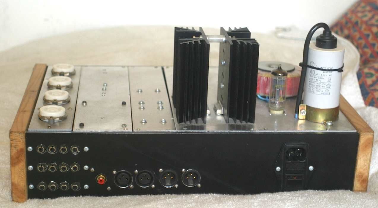

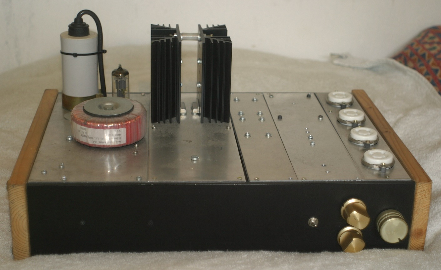

Here are some photos of my 26 preamp in 3 boxes - PSU is AZ1 mesh, the filament supply for filament bias has two large chokes, and you can see the large 10 ohm resistors (4 in series parallel per side) on top of the preamp!
