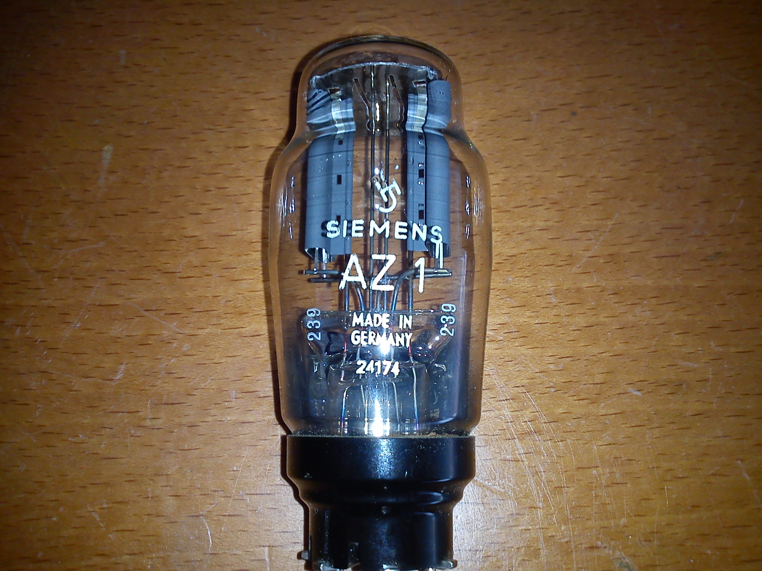

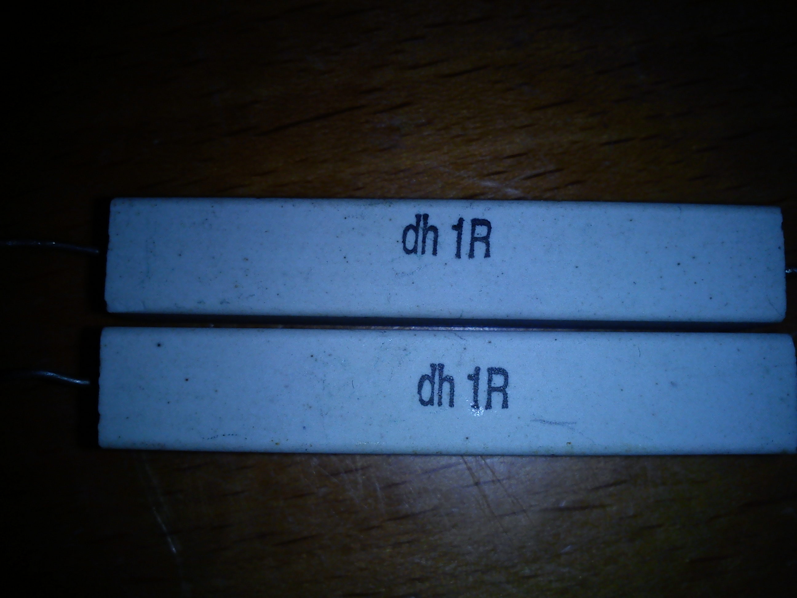

I want to use my 6.3 output but I need to reduce it to 4VAC for AZ1, how can calculate the resistor value because Ducan PSUD2 can't have AZ1 mixed with diodes as hybrid rectifier?
Ley de Ohm: Ley de Ohm - Wikipedia, la enciclopedia libre
The AZ1 has a 4 V filament rated at 1.1 A
6.3 - 4 = 2.3 Vdrop
R = V/I thus R = 2.3/1.1 then R = 2.09 Ohm
The resistor should dissipate P = I2 x R thus 1.21 x 2.09 then P = 2.53 W
I would use 2-2.2 Ohm/10 W minimum, or, better, split the resistor and use 2 x 1-1.1 Ohm/5 W, one resistor on each cathode.
