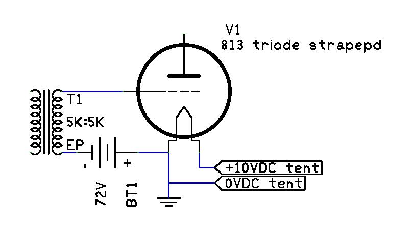

Hi nicoch46
That's helpful. The first diagram is new to me - I didn't know you could place the battery in series. How does that sound?
The second diagram is the one I need I think. I can see you don't need a cap here since it's open circuit when the tube is off. So presumably no resistor between battery and transformer if the diagram is to be believed.
That looks like you'd need one battery for each channel?
andy

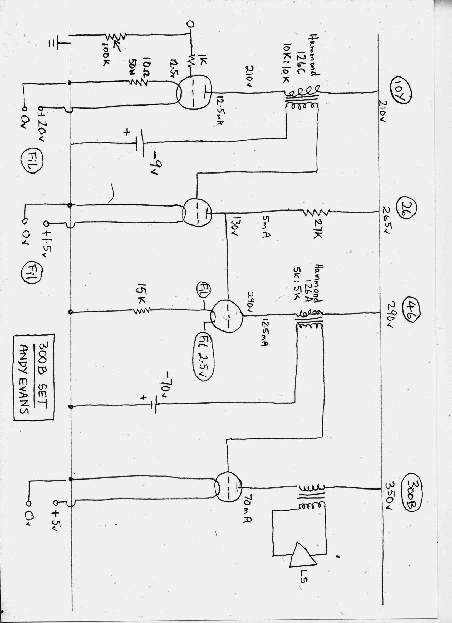

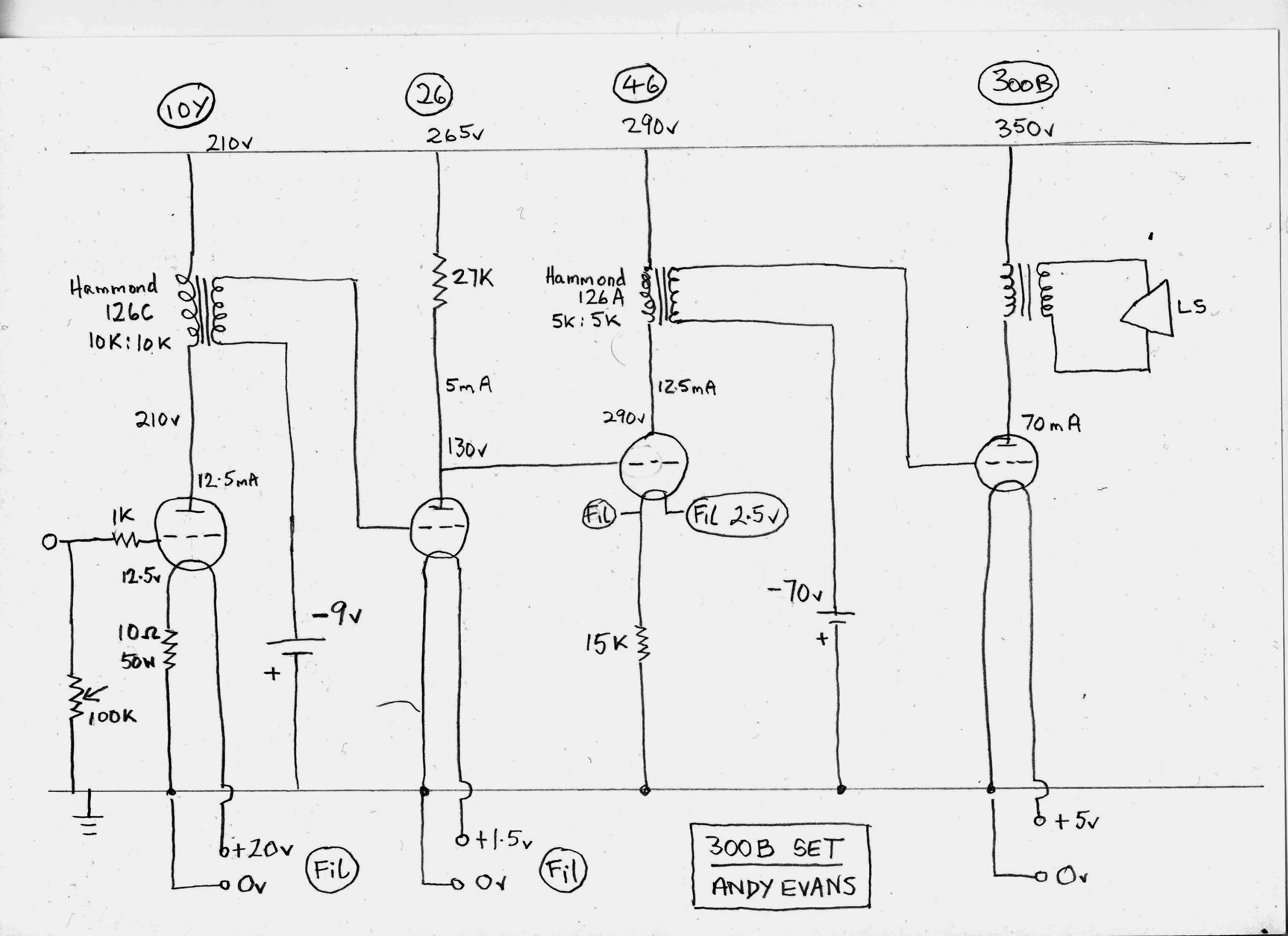

Here's my quick first draft of a schematic where the 26 is the second stage with battery bias - please make any comments or corrections.
I'm not sure if this comes out landscape or portrait - the original is landscape but sometimes my attachments get turned around. Can anyone explain what to do?
andy

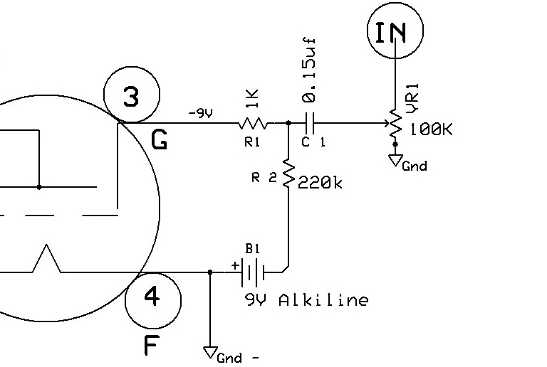

Andy here's what I have tested so far which was recommended by Kevin.
- Do I need one battery or two, one per channel? One per channel.
- If one battery, do I use it via a 1 meg resistor to each grid or what?
- If two batteries do I again use a resistor or just connect it straight to the grid? What value resistor?
Refer the schematic attached.
-Just occurred to me that with a transformer secondary, the grid and earth are connected so that would drain the battery, so I need a cap somewhere? Probably you could refer Kevin's article in PF. (http://www.positive-feedback.com/Issue16/kennedy.htm). I have seen a very informative discussion on this topic in one of the DIY site which I couldn't find the link (I think it was a Philippines or Malaysian site. Remember "ArnoldC" was active there so it could most probably a Philippines). Check if you could locate it.
- What kind of battery is it best to use? I tried few of different types but Alkaline came to top comparing the sonics.
Hope this info. helps.
