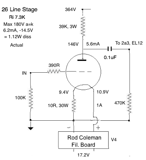

My revised circuit for my 26 stage, which drives my EL12n outputs making a 2 stage amp - my daily amp.
I bumped up the B+ to 364V, which allowed me to use a 39K anode resistor. Audible improvement - cleaner and generally better with tighter bass than the 27K I had in before. This is now really good to my ears. I used to think the 26 was warm, but this is just super clean and transparent. The ST version.

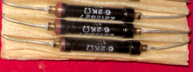

The old Ayrton-perry designs had no end caps - and a terminated wire at each side. Like this:
I wouldn't bother with the new Welwyn - they are good ordinary build, with steel leads and end caps.
The NOS type, and Ohmite, Mills are better.

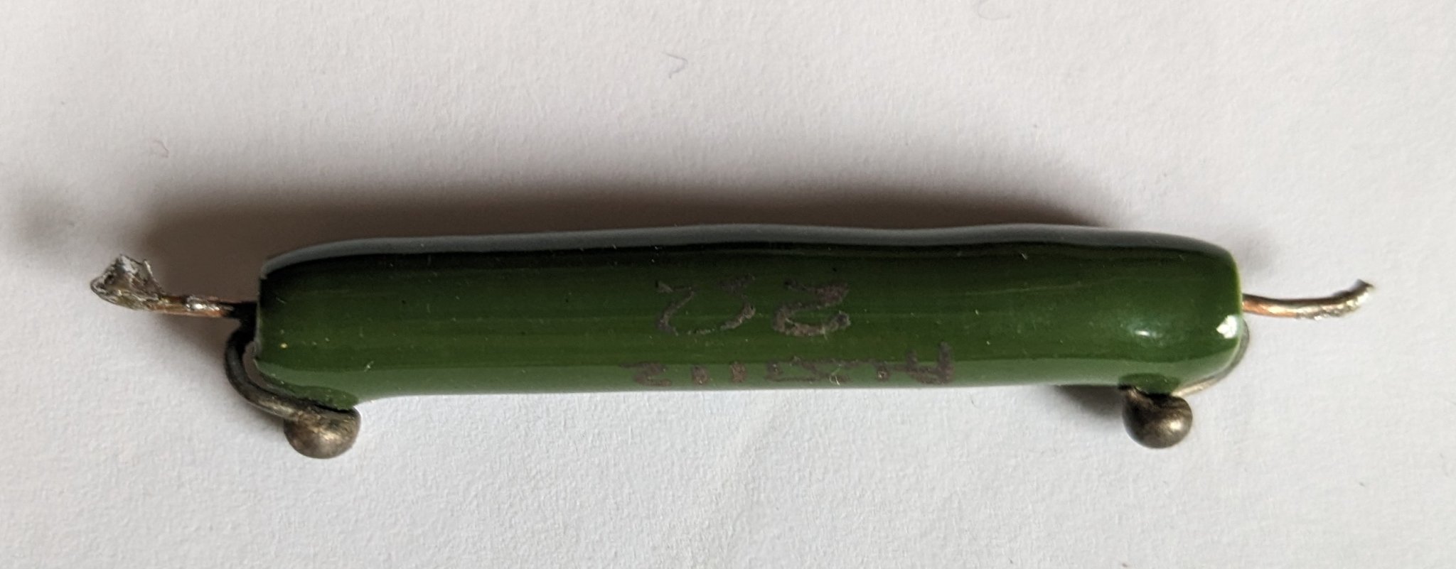

The very best Welwyn W2x resistors (I like its, and use everywhere when large dissipation is needed) are "Copper clad steel wire, nickel plated and solder-coated, vitreous enamel", ... but not induction free (Ayrton-Perry) style.
It's durability is excellent, if you overheat its (sometimes I accidentally try its over 200C), after the cooling the resistance remains as expected.

Question:-
What value grid stopper should you use with a type 26 tube?
What have you been using?
There is no grid stopper on Ale Moglia's schematics, but a 1K on Bela's schematics.
I used 1K, but arguably the transconductance is low enough you could probably do without.
