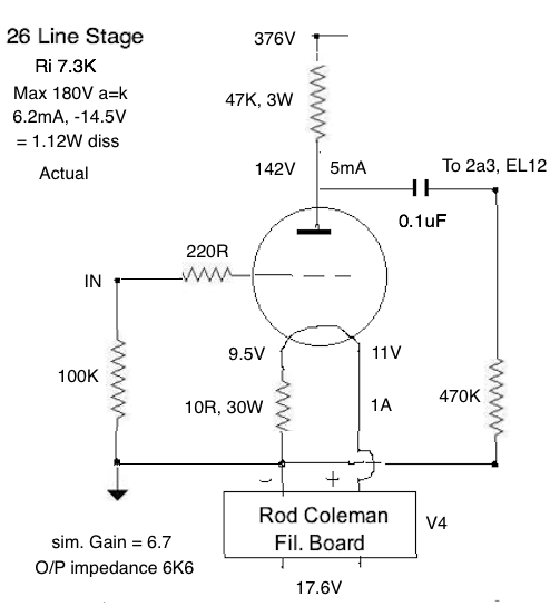

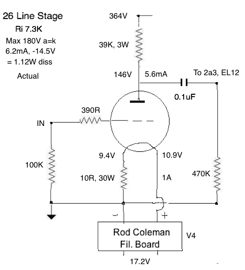

My revised circuit for my 26 stage, which drives my EL12n outputs making a 2 stage amp - my daily amp.
I bumped up the B+ to 364V, which allowed me to use a 39K anode resistor. Audible improvement - cleaner and generally better with tighter bass than the 27K I had in before. This is now really good to my ears. I used to think the 26 was warm, but this is just super clean and transparent. The ST version.

Simulation: x6.7 and 6k6.
x8 is the theoretical gain, if the tube's load is infinitive.

I've pretty much decided on the 26 as input stage for my EL12n outputs in my 2-stage SE amp. So I've been trying to get the best out of it.
Since I use resistor loads, getting the best sound has meant putting up the value of the anode resistor. I started with 21K. Boomy bass. Then gradually up to 39K which was OK for me since my speakers are sealed box and a bit bass-light. Bass was still a bit loose, though. So up to 47K. This made a difference, tighter bass. With 376V B+ this meant 5mA through the 26 when I'd want closer to 6mA. So looks like with a resistor load this wants 400V or so. Anyway, it looks like ideally you want 47K if you use a resistor load. Maybe even more, but 47K works. Higher than I expected, but it does make a difference.
My Nuance amp, which is also an inverted SET, also uses the 26 as an input tube. I'm using a different topology in that the plate load is provided by a Hammond 156C plate choke and I use battery grid bias.I've pretty much decided on the 26 as input stage for my EL12n outputs in my 2-stage SE amp. So I've been trying to get the best out of it.
But I'm running the 26 at about the same op point - 139v across the tube at 4.93mA.
