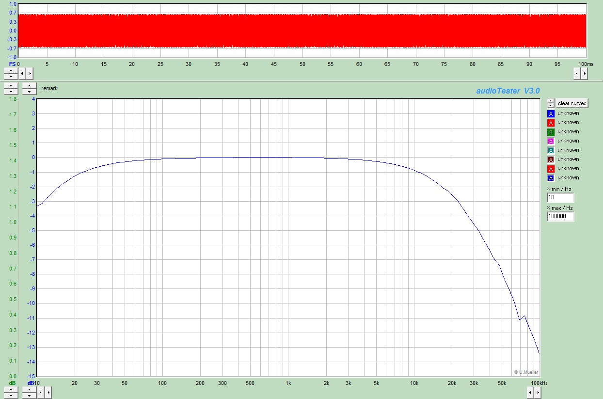

Made by a hungarian winder:
L: 620-640H (depends of squeezing);
DCR: 5800
Cp: 44pF
Tube: 841
Ip: 8mA
The Hungarian winder wound a massive amount of turns with very thin wire with that very high DCR of 5800 ohm!
And quite some capacitance.
Apparently not interleaved as well.
The HF sloping has nothing to do with the core material; it would have happened with any core material used for audio purposes.

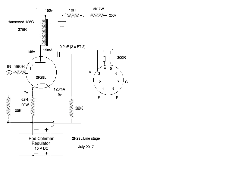

Andy.....can you share the schematic of your 2P29L please....so I may be able to try in the future.....???
Certainly - here's 2 versions. The lower voltage one is what I have now. The higher voltage one is an operating point I may try in future.
And now to clear up the mystery of "does the 126C work as a plate choke with primary and secondary in series". The short answer is no, as Dave Slagle predicted on Audio Asylum specifically for bifilar wound transformers like the 126C. He predicted a very audible treble cut, and that's exactly what we get, so can't be used. However, Pieter is of course right in pointing out this option with conventionally wound interstages, so I'll try it with the LL1660. For the record the 126C for the series experiment was connected blue to anode, brown to black, and green to HT - it only works that way round. I normally connect blue to anode, brown to HT and don't use green and black.
