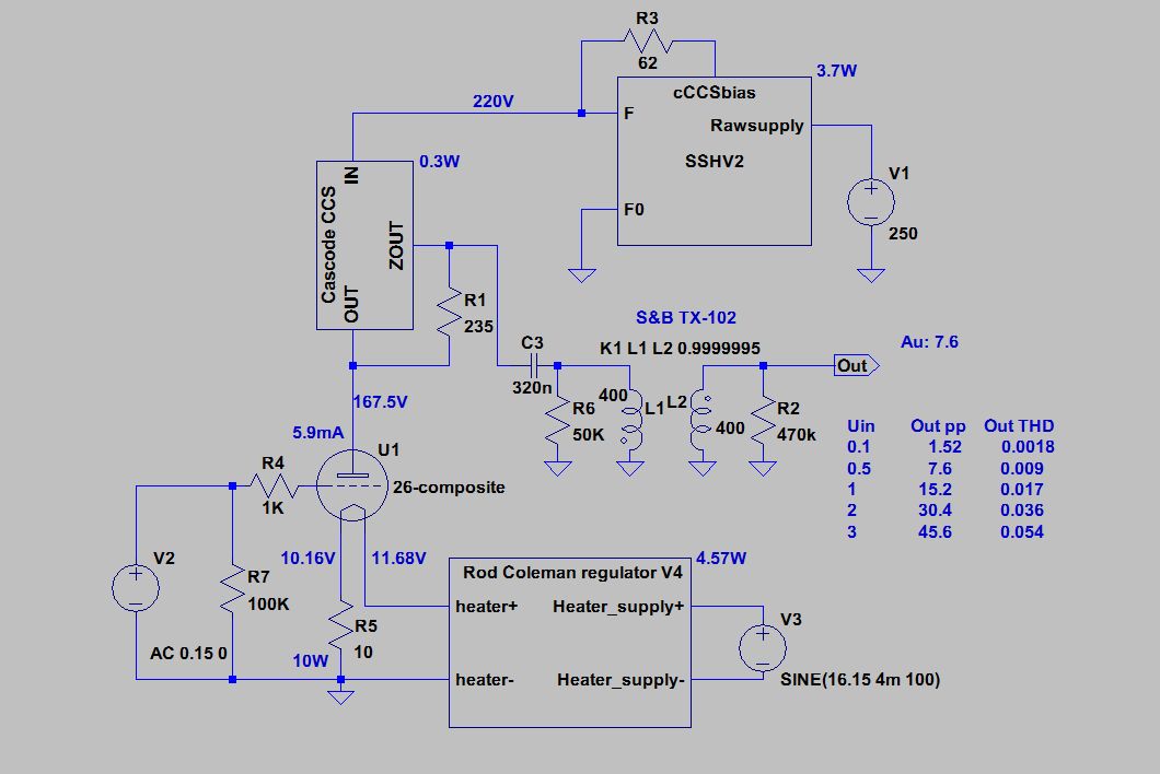

Can Ales gyrator boards be used as is if I try them with a parafeed transformer WITHOUT using the mu out?

Yes, it's possible....but....why?
If you use parafeed transformer, must to use enough large coupling capacitor.
DHT+gyrator+coupling capacitor = DHT preamp. Transformer is unnecessary.

Thank you for responding. Just an experiment to see what happens to the sound of my 26 amplifier with parafeed transformers. Never heard one.
Each parafeed is the series C-L tank, with explicit ( f=1/(2pi*SQRT(L*C)) ) resonance.
Tuning and damping this resonance is not easy.

My #26 preamp is CCS loaded, capacitor (0.22//0.1 uF) coupled to TVC (400H), so in fact this is parafeed.
As I am lacking in expertise in this area, a circuit diagram of such a method would be enlightening. At the moment my 26 uses LL2745s in Alt R, but with a 33k input impedance on my power amp I experience an HF droop. Adding capacitance across it hasn't really helped, and using my TVC (after the output transformers) softens the sound. The gyrator on the 01A has too much gain, so I don't want to go down that road with the 26. An alternative method would be useful.My #26 preamp is CCS loaded, capacitor (0.22//0.1 uF) coupled to TVC (400H), so in fact this is parafeed.

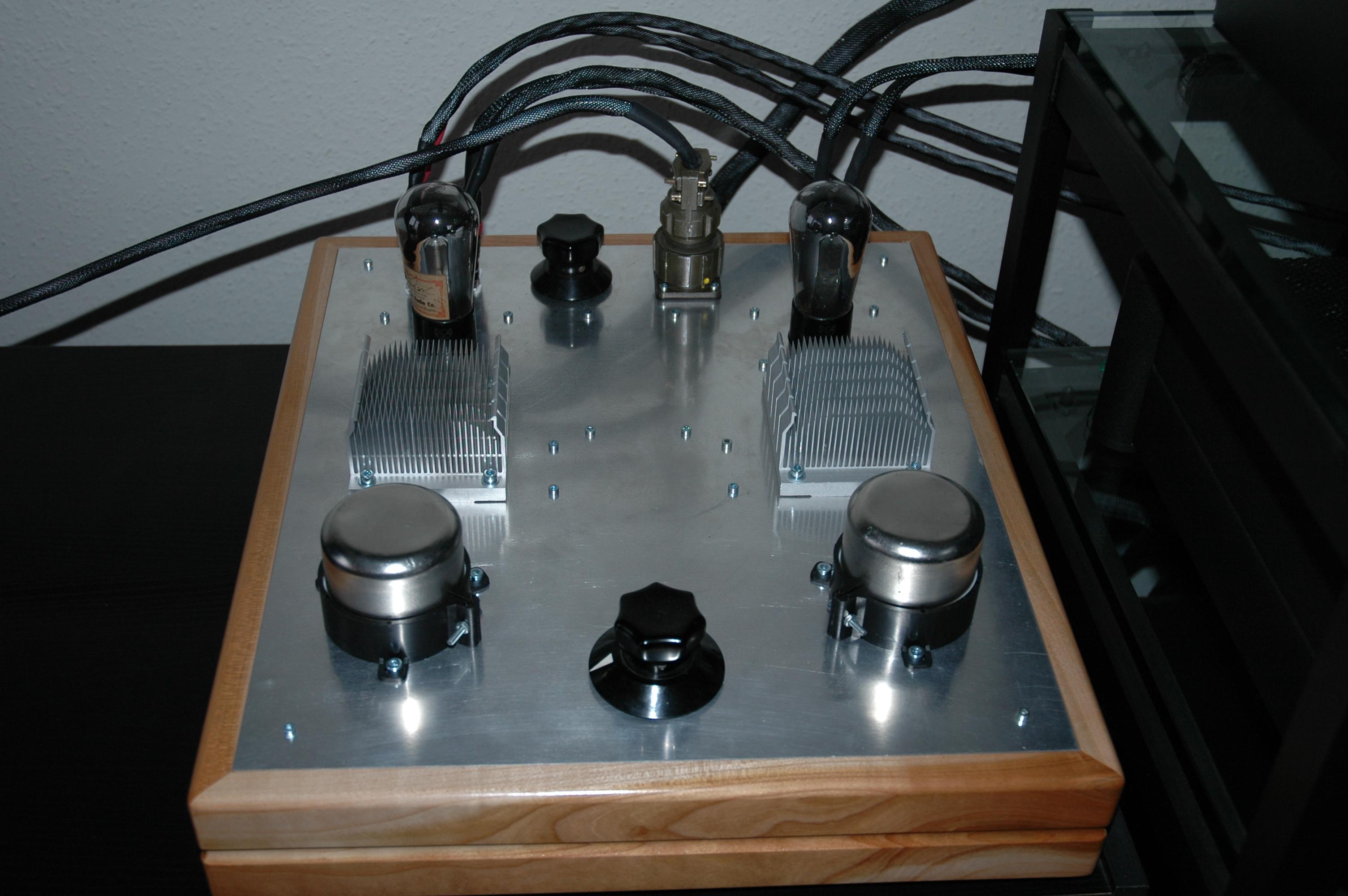

I use this preamp for five years.
Two box -power and preamplifier structure.
Preamp box:
selected globe tubes, vibration damping, good components (Shinkoh tantalums, V-Cap // FT-3 teflon capacitors, military connectors, Rod Coleman regulators, Dale non-inductive filament resistors, DN2540 cascode CCSs), DIY silver interconnects.

My 300B SE amp has 100k input impedance, so preamp output impedance is adequate (about 800R in the whole band, plus 320nF capacitor's impedance).
The transfer curve is:
-1dB 24Hz...42kHz
-3dB 14Hz...65kHz
I built another DHT preamps (01a, 10/801 with CCS or gyrator), but this is my daily used equipment.
Preamp box:
