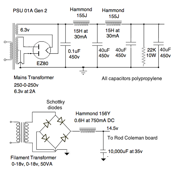

I can live with some solid state components for the moment, I can always take them out later if I get too neurotic about it. It seems that both the coleman regulators and the gyrator take DC voltage. I'm probably going to keep the gyrator HT voltage regulated with a tube, and maybe tube rectified, as it's easier for me to design that way. How clean does each supply need to be? I see on the schematic that the regulator needs 15V in, I'm probably going to design that around a 12.6V secondary, and just rectify and smooth it. Does anybody have some good links to power supplies?
If you use filament biased 26 tube, -and want to use sufficiently filtered supply- IMHO the 12.6V AC is too low.
I use 10R filament bias resistor and -about- 0.95..0.96 filament current, so this 9.5V + 1.5V heater + 4.5..5V for Rod Coleman (V.4..V.7) regulator requires about 15.5...16V raw supply.
Really it is about 15.6V, because I use -little weak- 15V AC (use more than 2.5A capable transformer!), Graetz with MBR1635 diodes, C-CMC-C-L-C raw supply.
Don't worry about solid state plus DHTs - it's a marriage made in heaven. Yes, of course use a tube rectifier and also all polypropylene caps in the power supply, and make it choke input if you can with a suitable resistor to ground to achieve critical inductance.
But I cannot stress too strongly the importance of the filament supply in filament bias. The signal goes through the filament supply - they're shared. So treat it like a B+ supply in terms of sophistication. This is more important than a tube regulated B+, which isn't critical since the Gyrator is a good filter in itself. Attached example of PSU for 01A

That filament supply seems like it traded proper design and regulation for just a massive capacitor... Which is something I have no problem with 😀.

Bear in mind I'm not an electrical engineer - I'm actually a musician and what I know is empirical knowledge from actually building and listening to a large number of DHT designs, then modifying them according to what my ears are telling me. My goal as a musician is to reproduce the clarity and timbre of acoustic instruments so I hear them as I hear them live, or as close to that as possible. It's all about timbre and clarity - I'm not interested in soundstage or "bass slam" or other factors which aren't relevant to me. If you have purely engineering questions I'll leave those to the engineers.
The "proper design" in the filament supply is using choke input, as it also would be in the B+ supply. Chokes do a good job of smoothing, yet this is overlooked and often chokes are left out. If you want to implement regulators as an alternative go ahead. But Rod's regulators already contain circuitry to do this, just like Ale's Gyrator does. By using choke input you are just feeding these existing regulators a smoother supply. I hear an "audible" improvement in smoothness with chokes. By using the word "audible" I'm not saying it's "huge" - it may be small. I'm just saying it's above the threshold of audibility if you listen carefully and are listening specifically for timbre and clarity.
