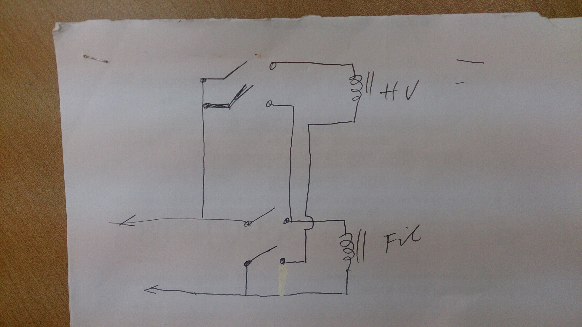

I use two switches as follows.
No matter which switch you switch on first.....filament will be on first....then the other switch will get the B+ on.....
At the sme time, no matter which switch you switch off first..... B+ will be off first.
